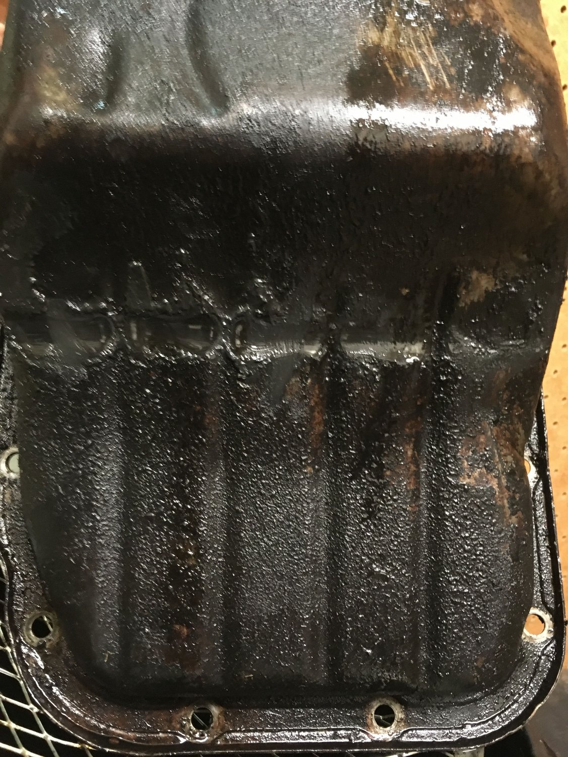

Another question, is the oil pan supposed to sit on the tie rod like thos or do I got a major steering/suspension issue

Originally Posted by Shagool22
Okay will do. I don't thing anything is missing. Oil pan is off and there's nothing in the bottom of oil pan. Everything in the bottom end looks good! All looks brand new damn near..
I would pour the oil through a sifter just to be sure or run a magnet through it. I would expect there to be a piece or 2.
Another question, is the oil pan supposed to sit on the tie rod like thos or do I got a major steering/suspension issue.
​​​​​​​No it shouldn't be touching at all - could be old or incorrect motor mounts too.
