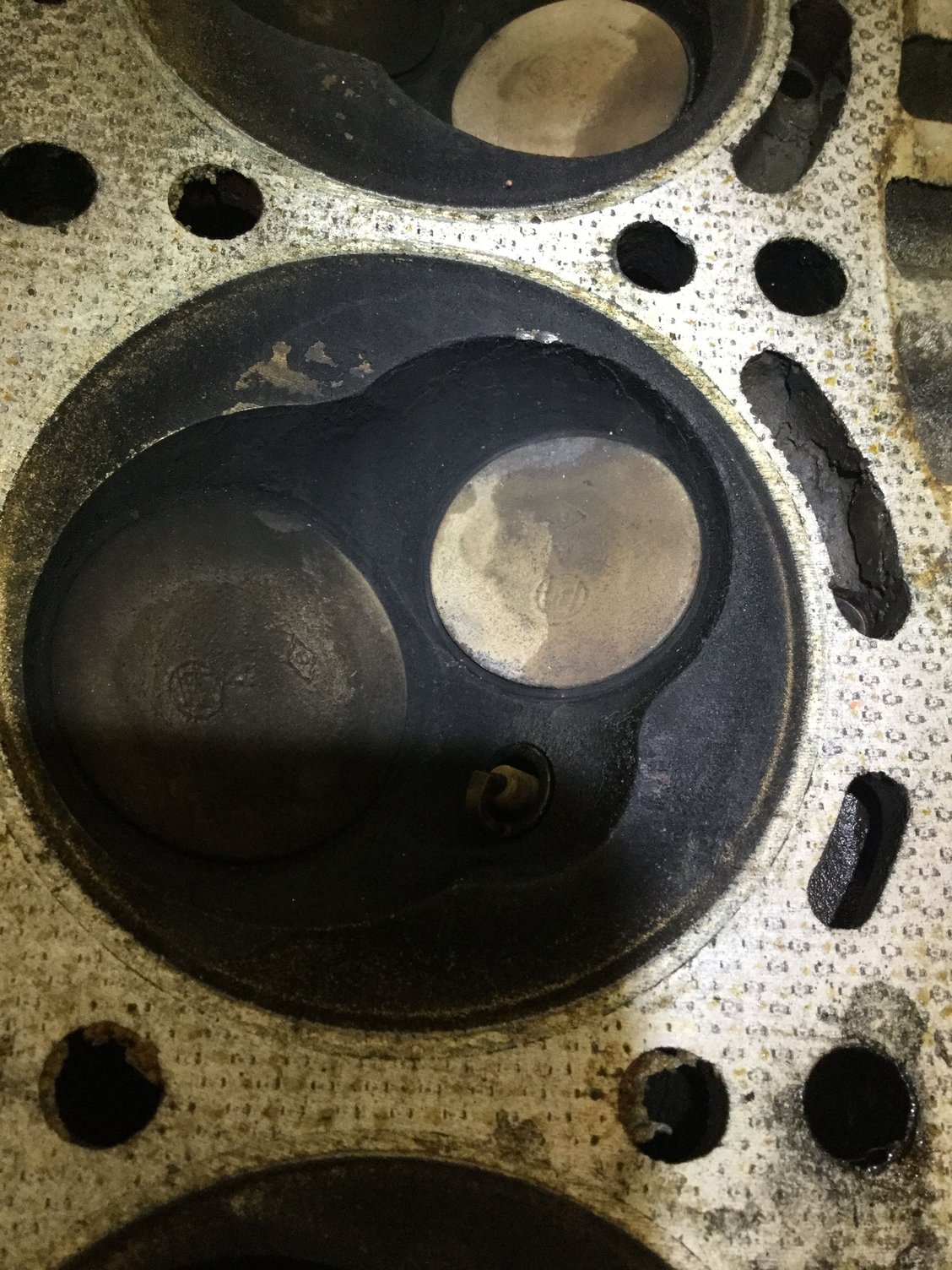

Anyways, I tore the head off last night. I expected an obvious burnt valve which I did not find.. but on that suspected exhaust valve I might be seeing what I think to be a "hotspot" that may be warped.. I pulled the valve spring and when I spin the valve to me it looks like there is quite a gap right there. Am I seeing things or does this valve look okay to you (too portion of exhaust valve)?
Also a few valve seals were definitely leaking.

And how do the cylinder walls look? Can still see crosshatch. Hard to get a decent pic. They have not been wiped down or anything yet.

Originally Posted by Shagool22
No air out of crankcase or intake on any cylinder.. I had no blow by at all with motor running just very little/normal crankcase pressure. I have no numbers, long story short I made a cheep diy leak down tester out of an old spark plug and an air fitting welded together. Didn't put a gauge on it.
All I can tell from the pic is the valve face looks semi-discolored compared to the other ex valve in the pic. Fortunately nothing terrible happened like a seat coming loose. But now that you have gone this far you might as well take it to a machine shop and have them go over it completely. If it hasn't overheated it shouldn't need a shave. Give it new guides and seals and seats as needed.
I think I see a bit of the crosshatch. Is there a ridge at the top of the cylinders? How many miles on that engine? Given what you've said it seems like just the valve was the problem.
