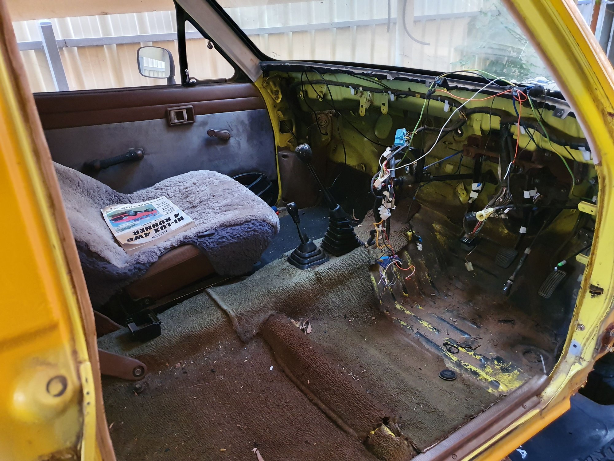

I am ripping the panels off, and all of the interior and headlining. My plan is to try to deal with the rust issues, as best as I can. Then to repaint it the stock yellow, so that I can get another 35 years out of it!

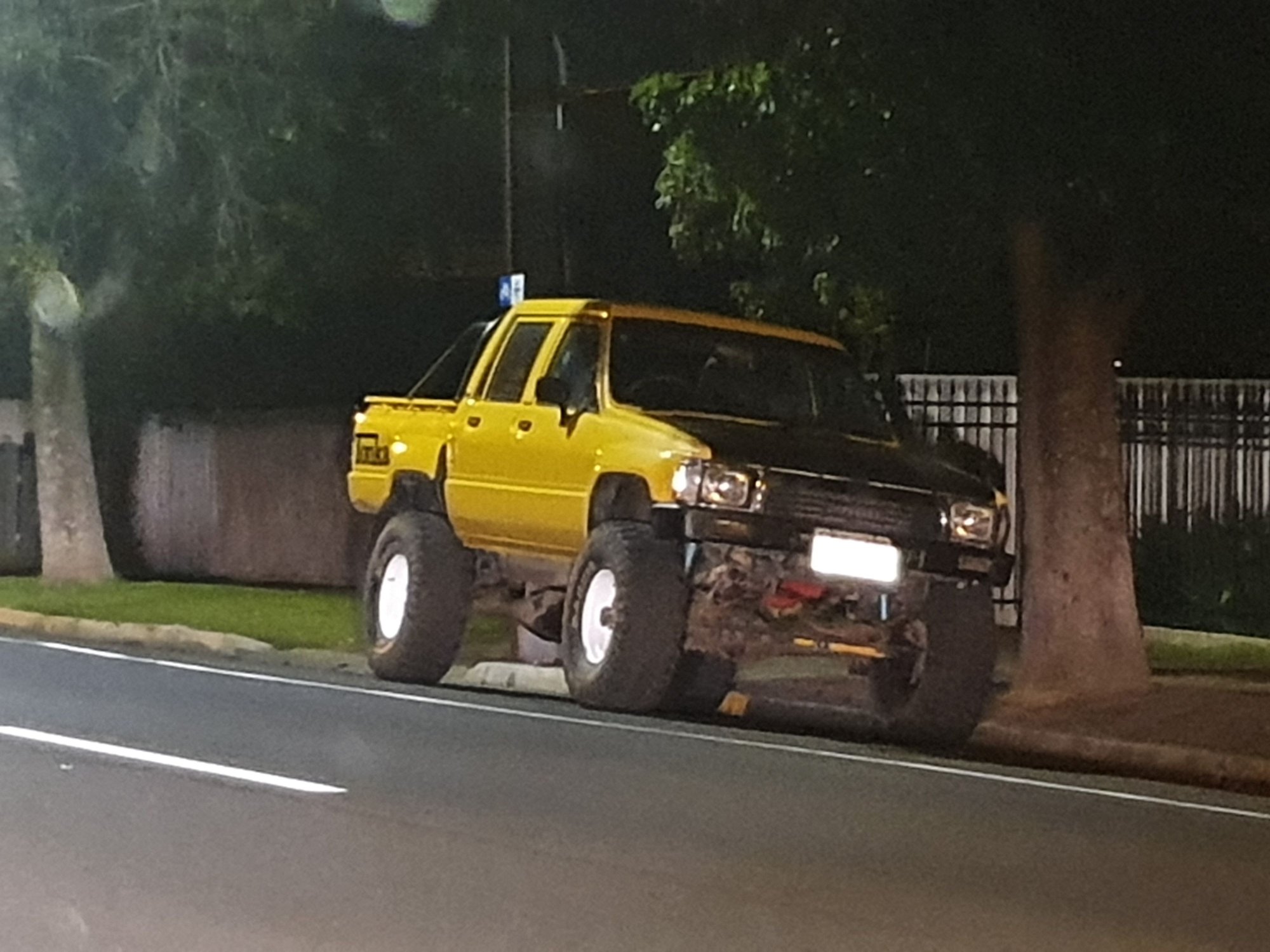

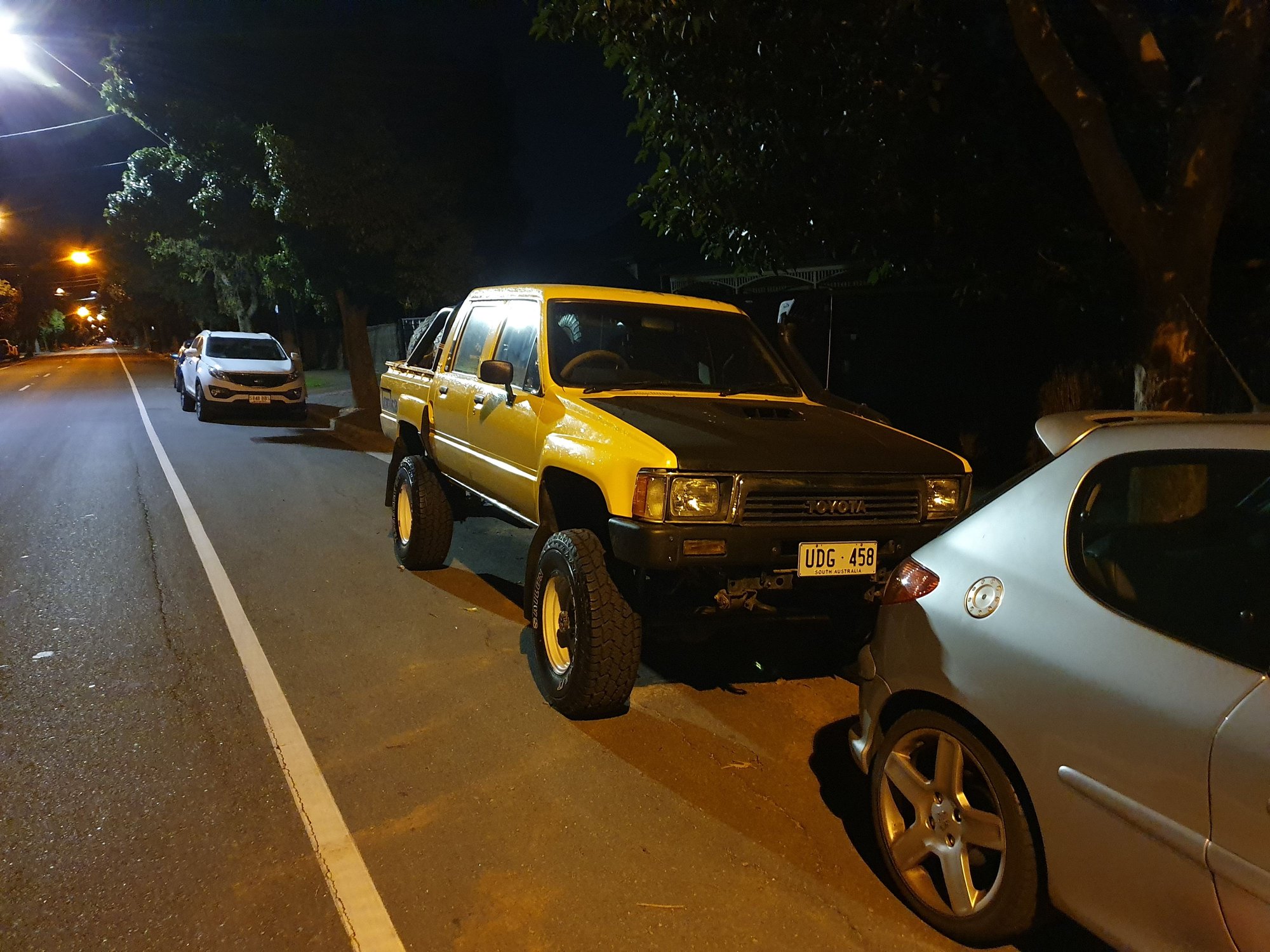

one of the most recent pics before I started taking it apart
The engine with the turbo install... uh as you can see the snorkel is not doing much
The worn 35s were a bit much, back to 31s for now

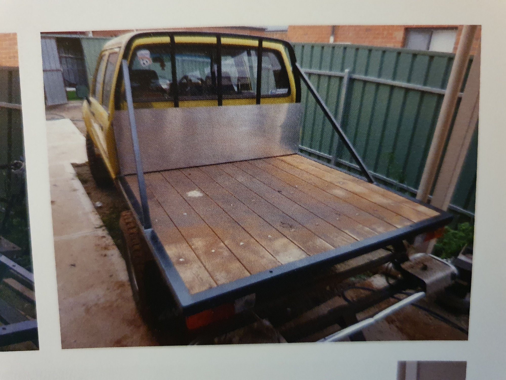

The tray I built (mid-build)

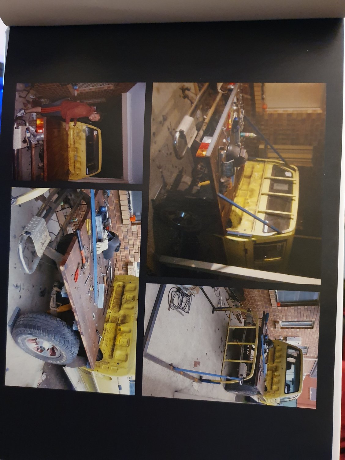

More tray pics from the book Sax made me

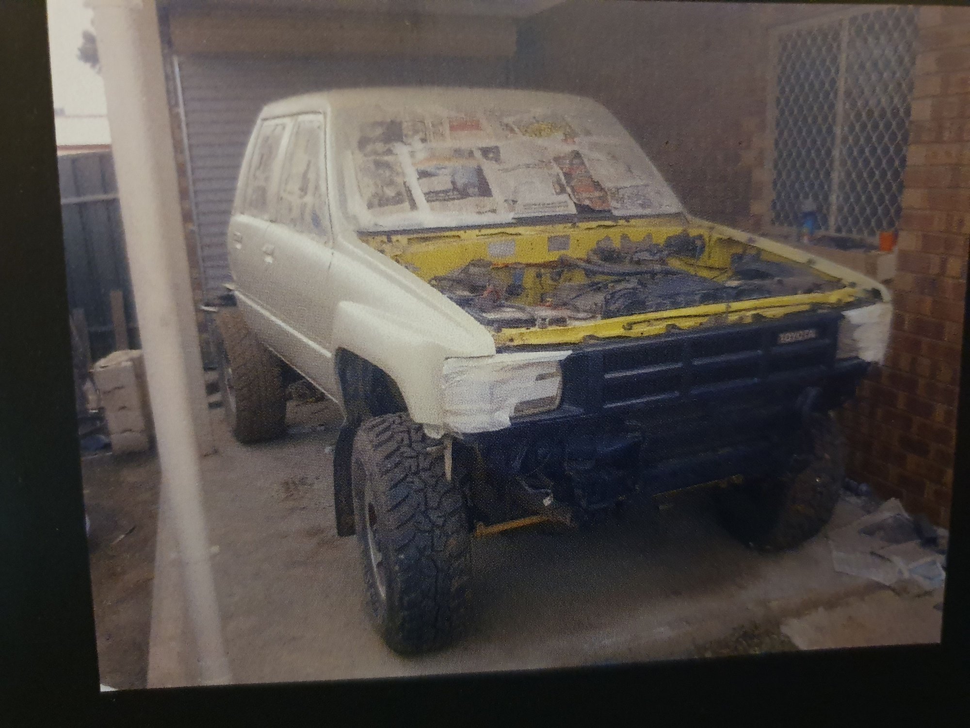

When I was painting it cream white

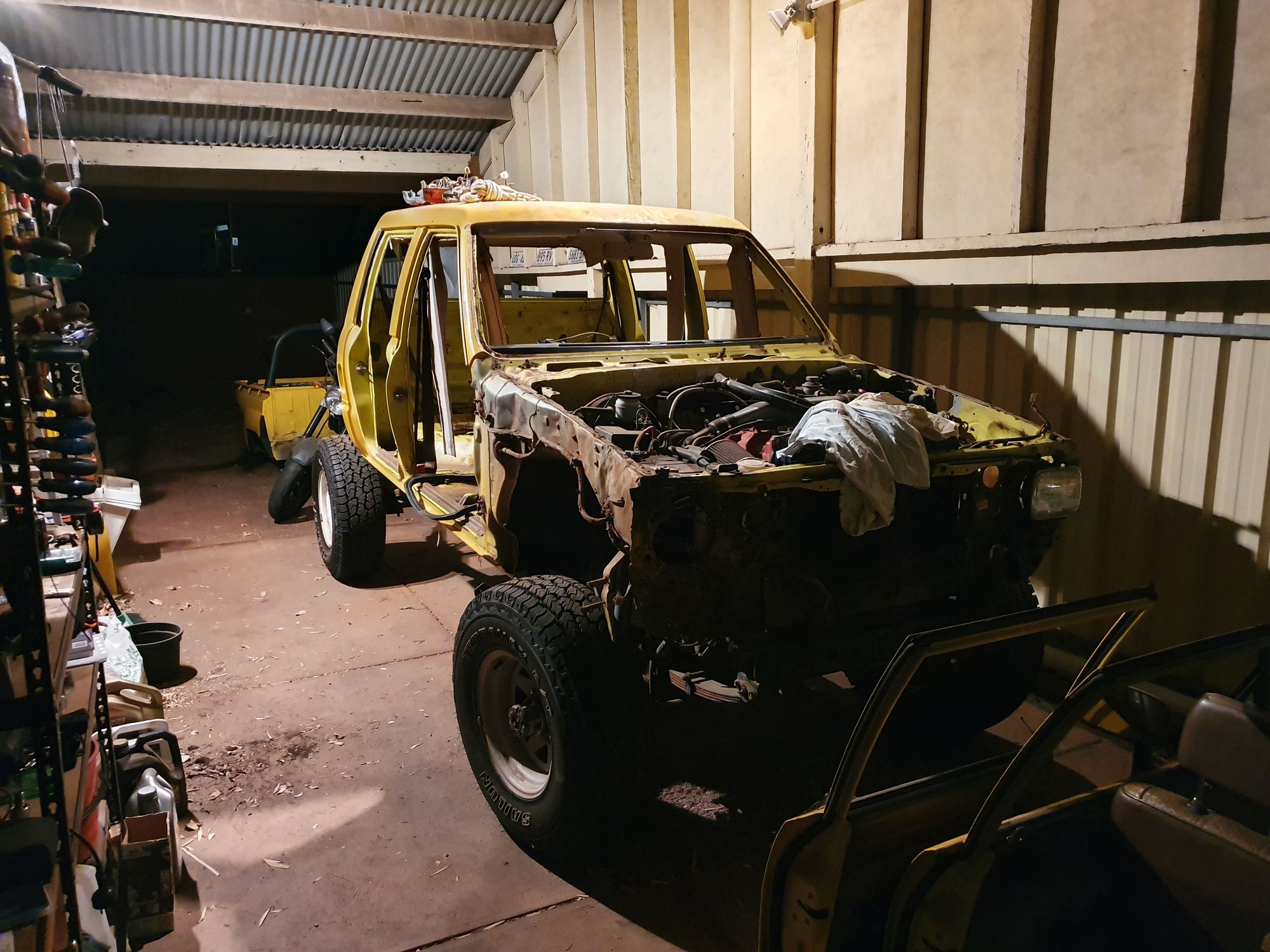

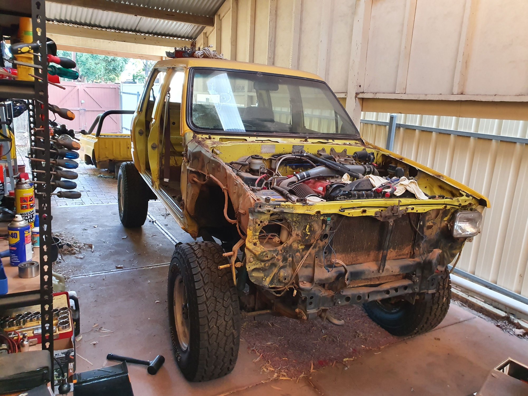

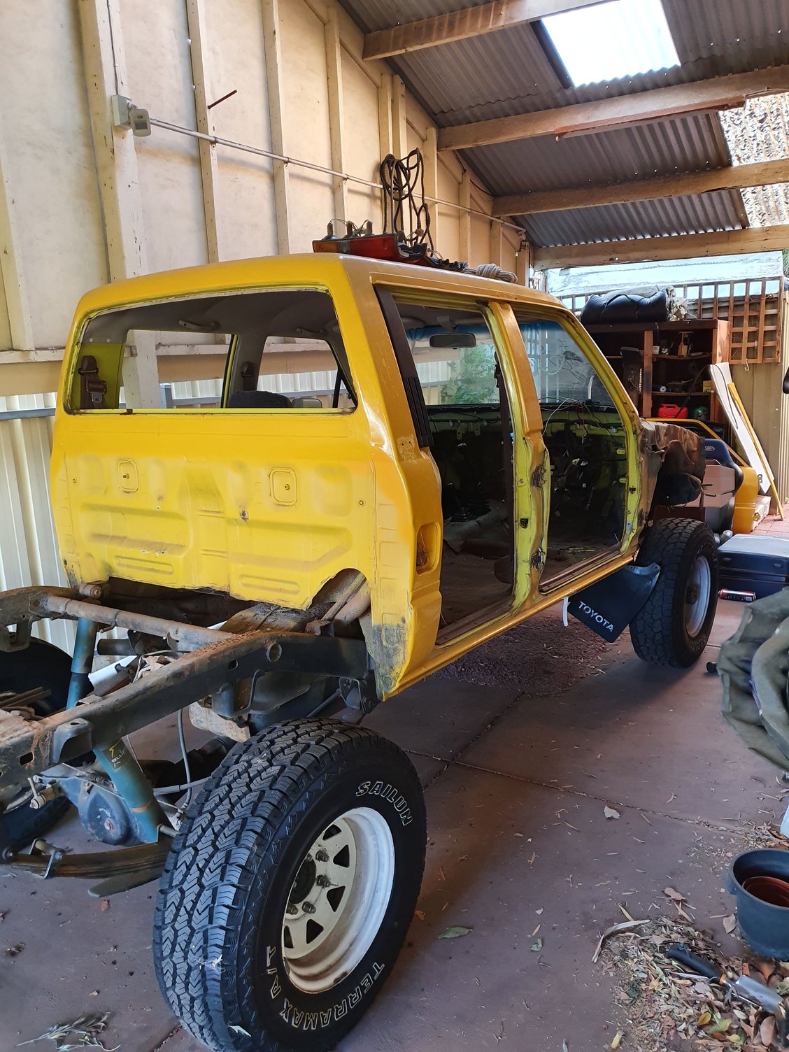

And this is today, in the process of stripping it down
Im a little torn on exactly HOW FAR to go with the repairs. Im not really equipped to fully remove the cab where I am. Im thinking Ill just fix what I can on the firewall, and in the cabin pillars/window edges/etc. And then paint and reassemble everything. I could go all out and clean the chassis and every bent piece of forward and rear chassis, but I dont think Ill have the time to really get it done. Its pretty daunting. I have a stick welder and and air compressor but Im very much at an amature enthusiast level, as opposed to a lot of the brilliant builds I see here by people who have a lot of skill in fabrication.

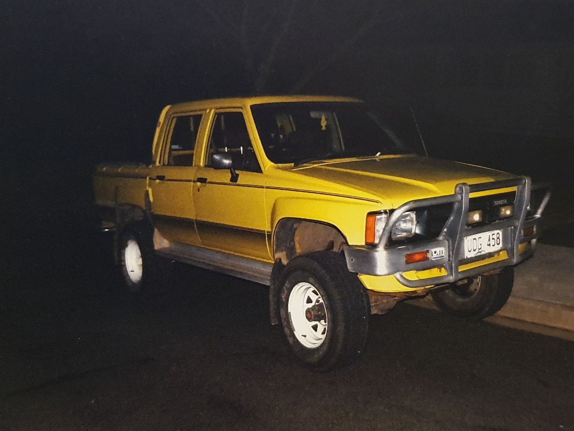

This is basically how I had it before selling it. This is pre-lift kit (still on the old sagged leaves)

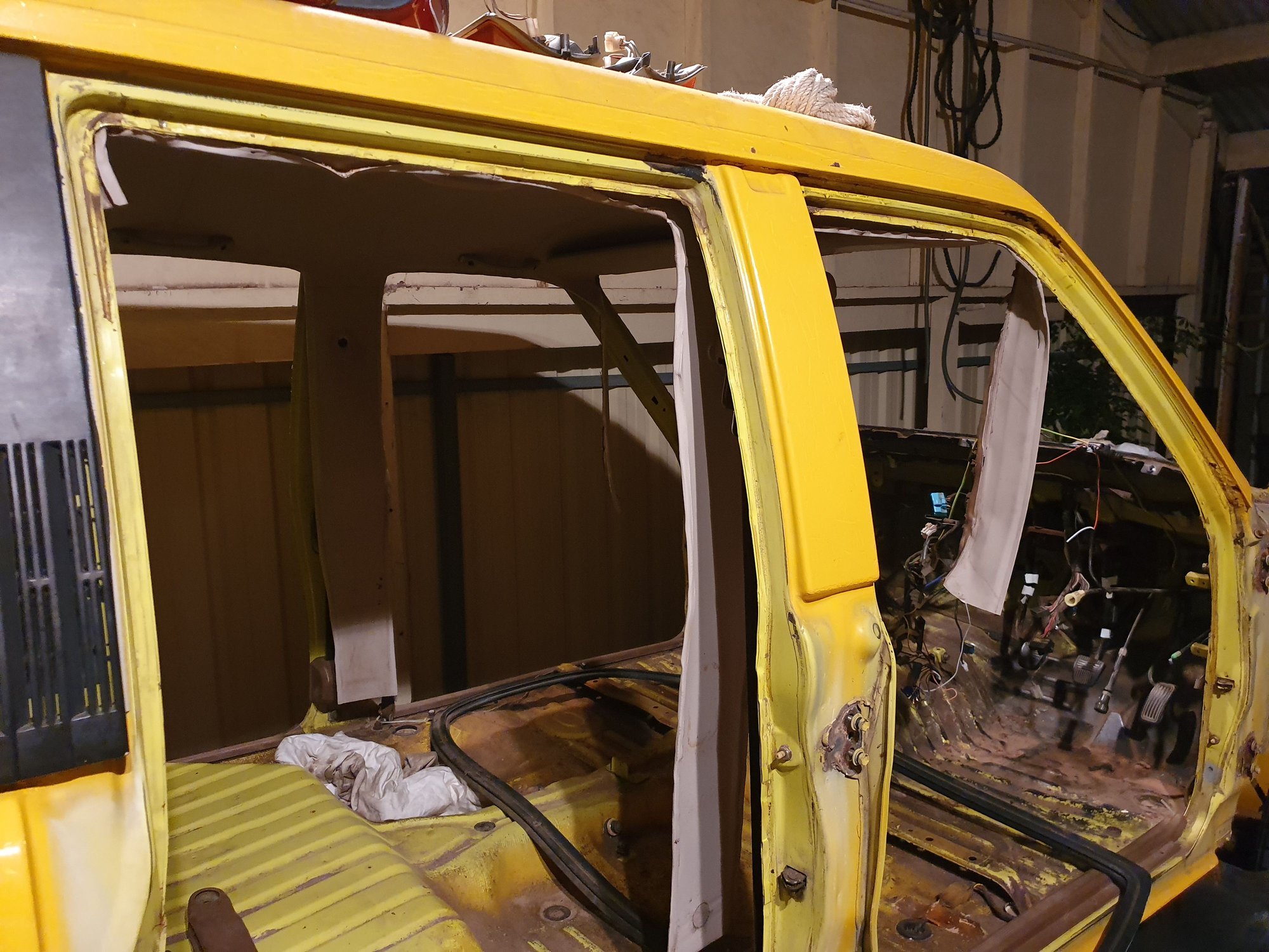

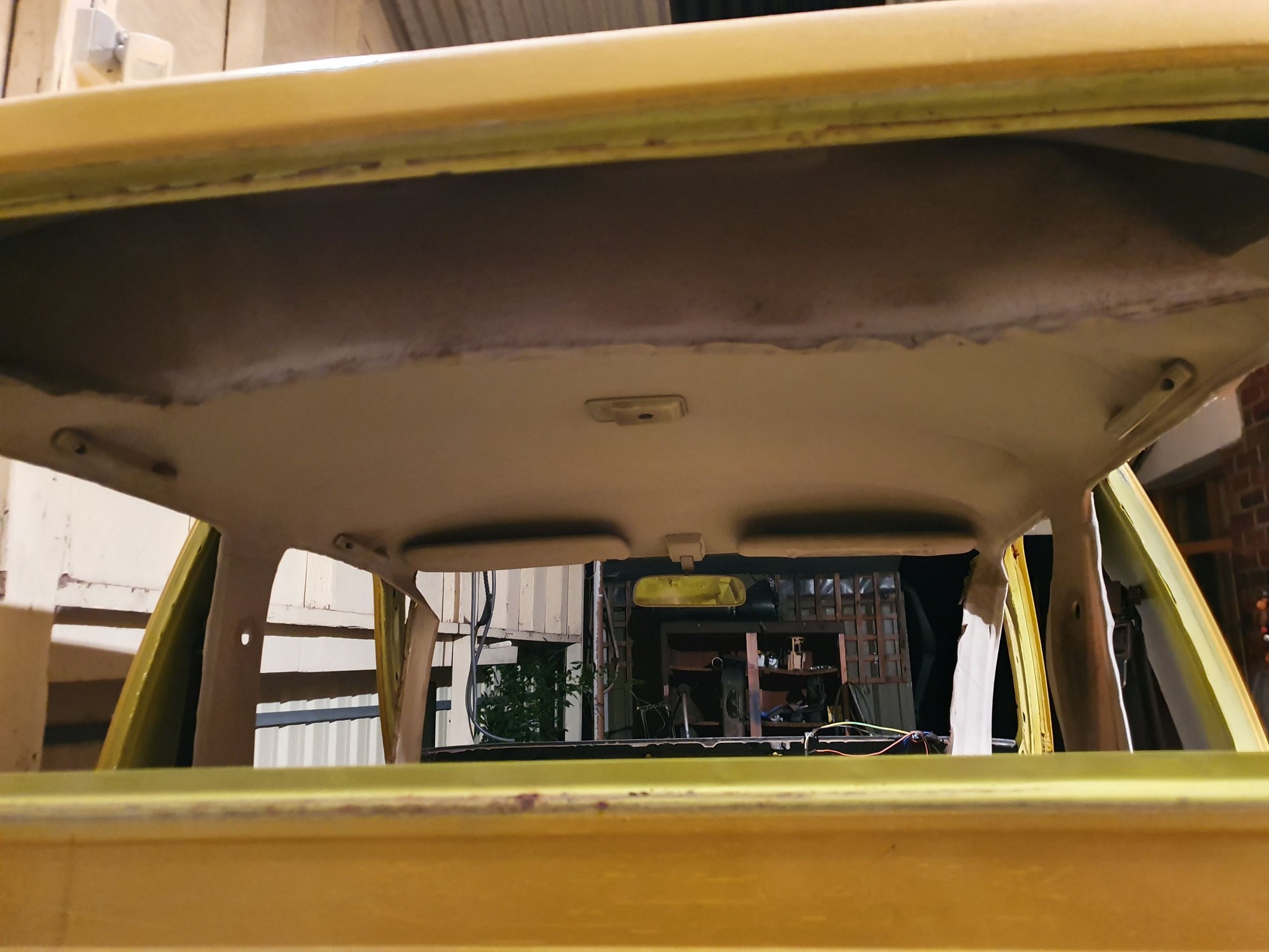

Got the headlining almost ready to come out. It was brittle at the back window and the front window, but like new all along the sides. I tore it in a couple of spots where it was brittle, maybe two or three 1-2cm rips. There was already one little rip on the driver A pillar. I may cut the pillar parts of the headlining part off, and just keep it as one large roof piece, then maybe put some similar vinyl down the pillars later. That way I eliminate most of the little rips too
I was sitting on an old tyre and I liked the angle

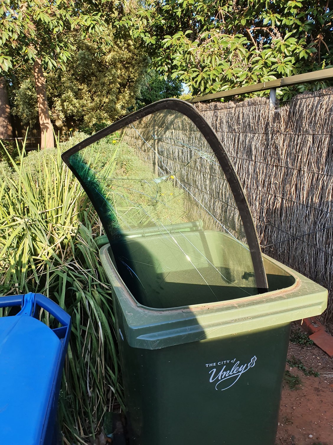

YES. I did. I broke the windshield when I was taking it out. I had a hard time finding information on how to take it out and in my haste a crack formed.... but at least that simplified the process after

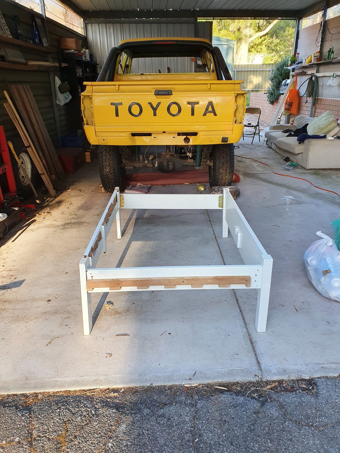

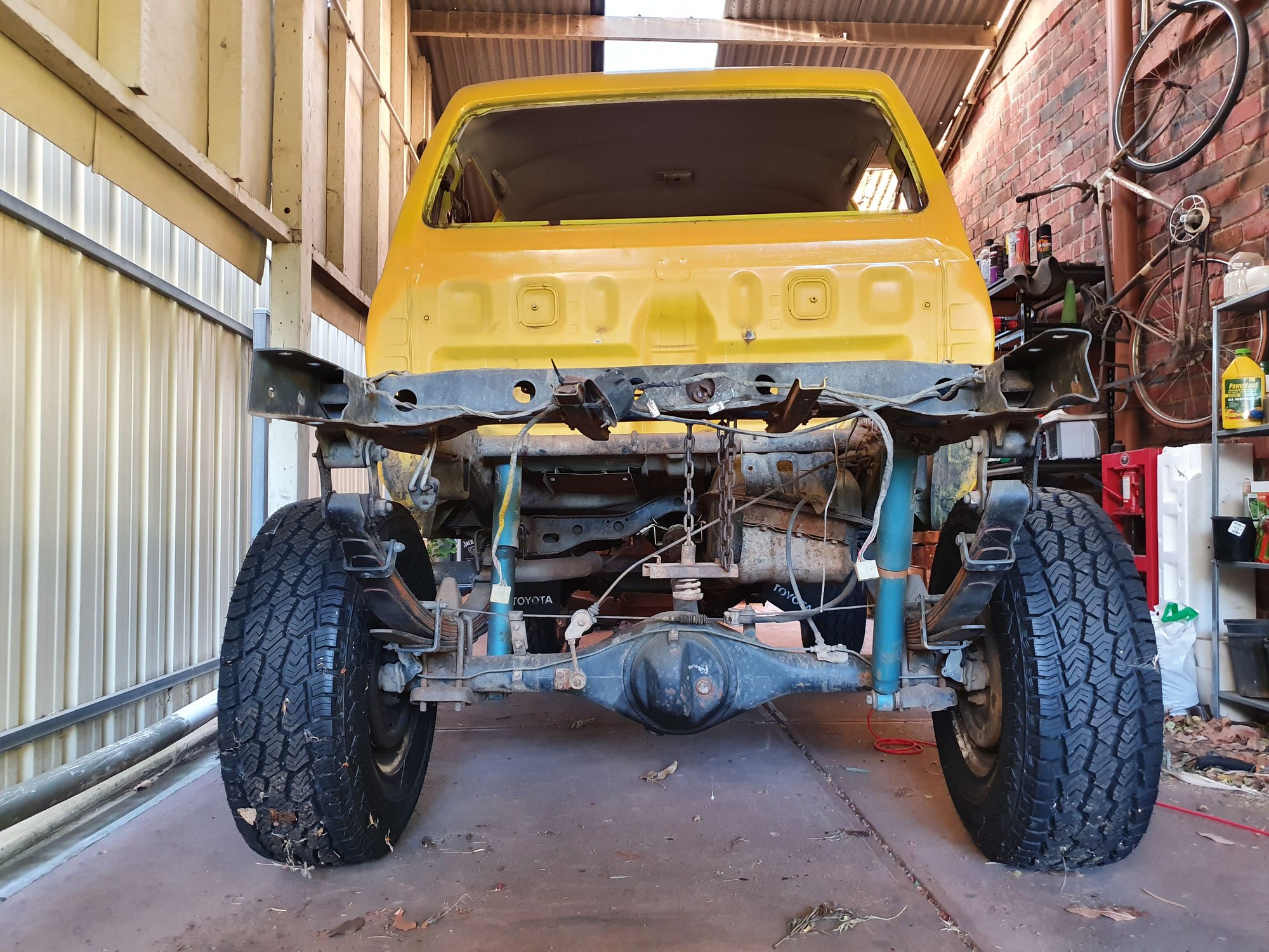

I built a little dolley the same width as the chassis with an old bed frame and two metal caster wheels from an old disused engine stand. The tray is surprisingly light, even with the roll bar and rubber mat in it. Its big so obviously I need an extra person to lift it up and down, but I would still guess its only about 100kg at most.
Unfortunately I had a hell of a last year. I had to suddenly move house a few weeks after I made my last posts, which meant shifting all of the Hilux parts and the vehicle itself to the new place. Then I discovered I had Tennis Elbow. My work is half physical and half mental, so the manager let me stay on light duties for the rest of the year while I had physiotherapy and looked after the arm. So here I am now, I finally have time free and a strong arm! Just in a new location.

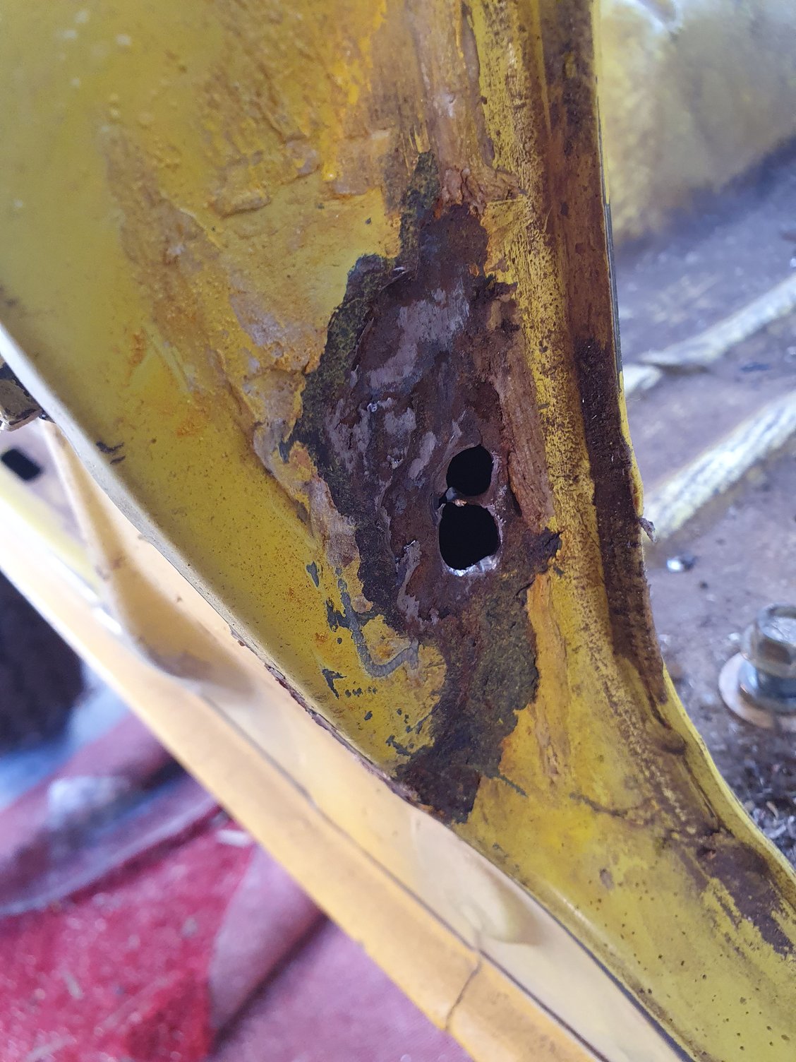

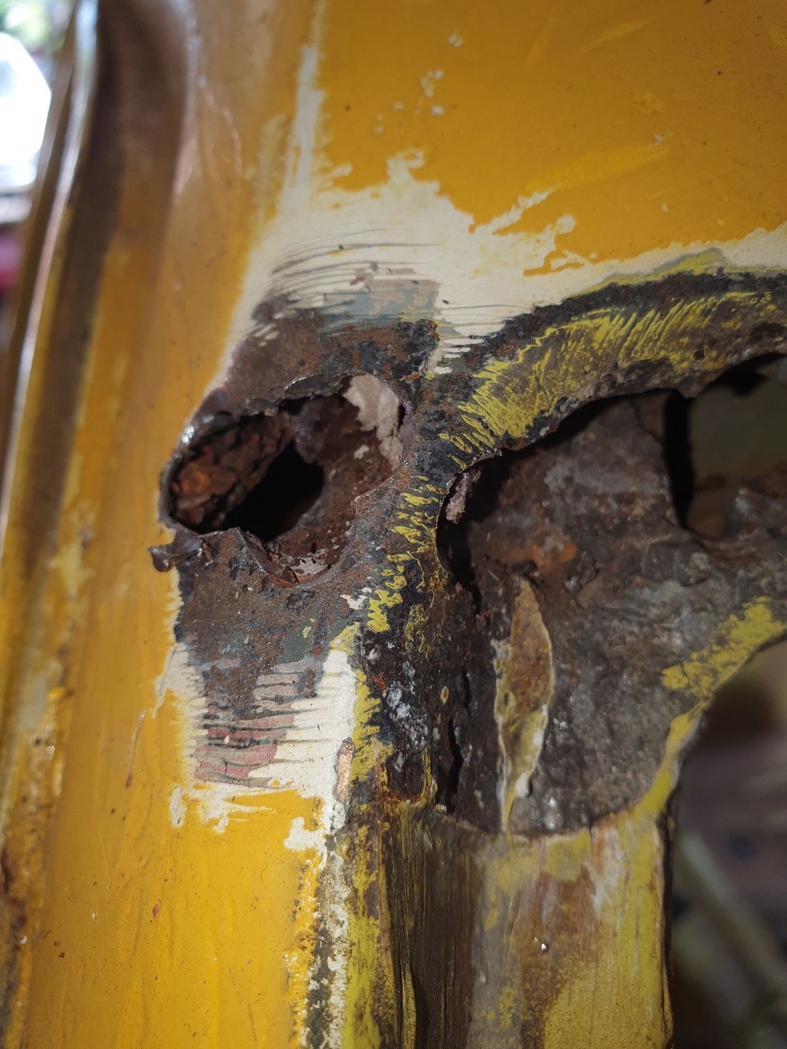

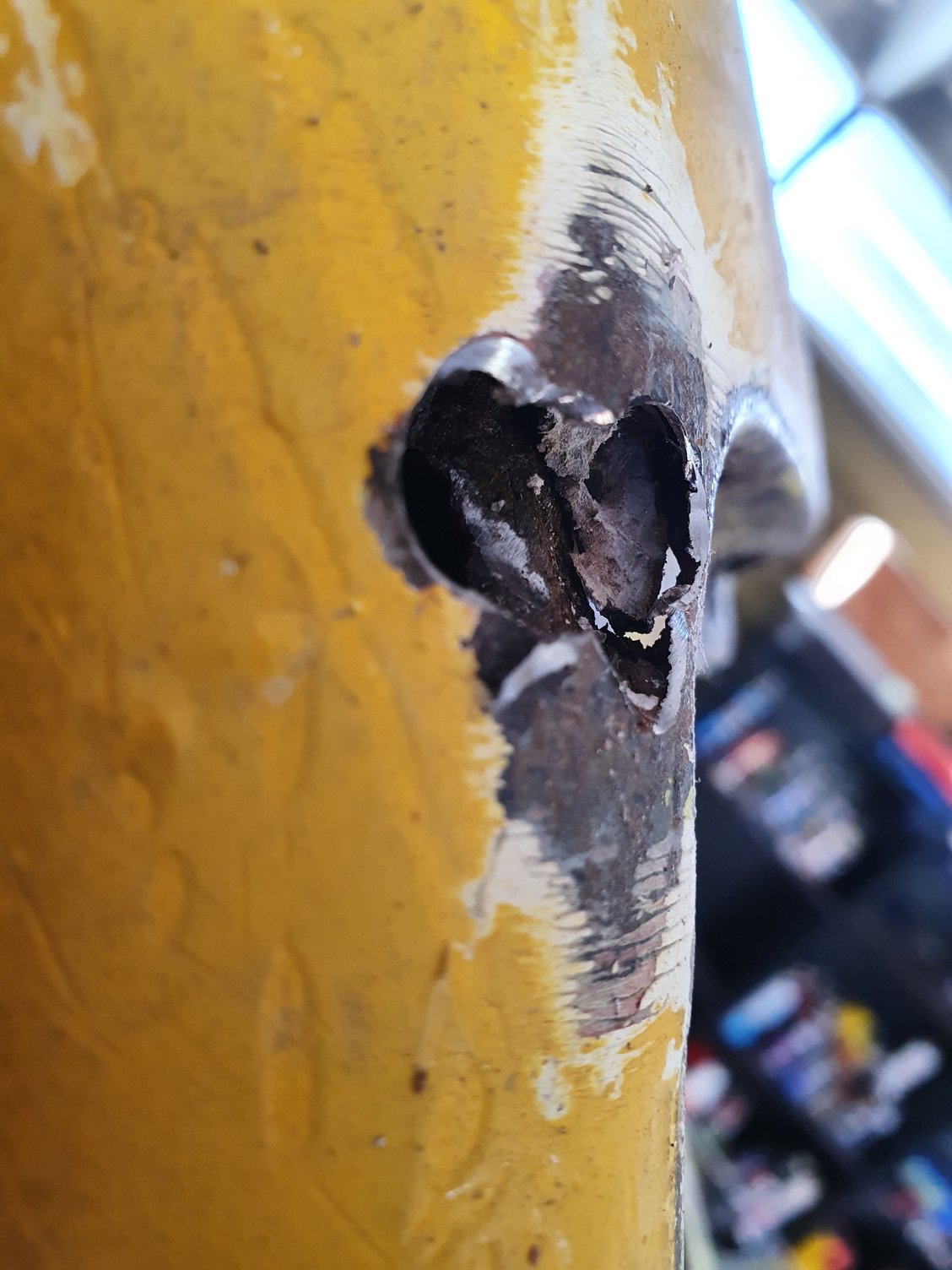

Some of the rust Im working on. These areas arent so bad. Ive followed a few rust spots down a few seams, and I think I should be able to treat most of it. The most important parts are on the windows; I will have to do a bit of structural repair, likely in the form of metal grid sheets and fibreglass filler. Luckily I can get to it all as I have the roof lining off, etc. I know I wont be able to REALLY get everything in every spot, under the body or on the inside of the pillars, but I can say that I will keep the body in ok condition for another 10 years, without rust being visible on the window edge. I have the sheer luck of living in one of the driest regions on Earth. We have no road salt, or anything like that, because it never snows, not even close, and for 1/2 of the year we get almost no rain. When I was a teenager we had a drought for 10 years! So my memories of high school are of dry dead sports fields and 2 minute egg timer timed showers.
But then there is the dreaded footwell. I will almost definitely have to cut some of it out and do a bit of careful stick welding. And under the dash where the fire panel has a horizontal seam, I have to awkwardly remove and patch rust. Thats the zone that was poorly engineered by Toyota, that rusts when water pools in the gutterways that take the windscreen runoff water. Right where a seam happens to be as a weak spot. Its how water gets into the footwell to begin with, which wets the carpet without you knowing and starts the rust in these models.

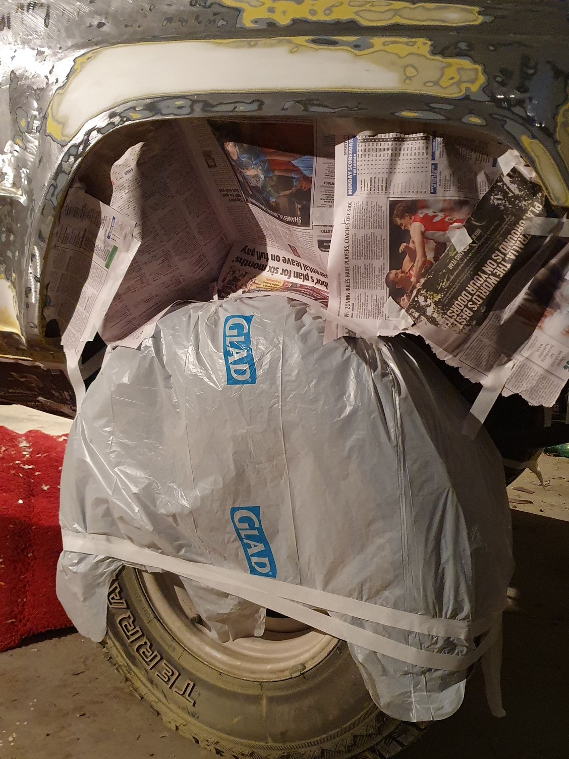

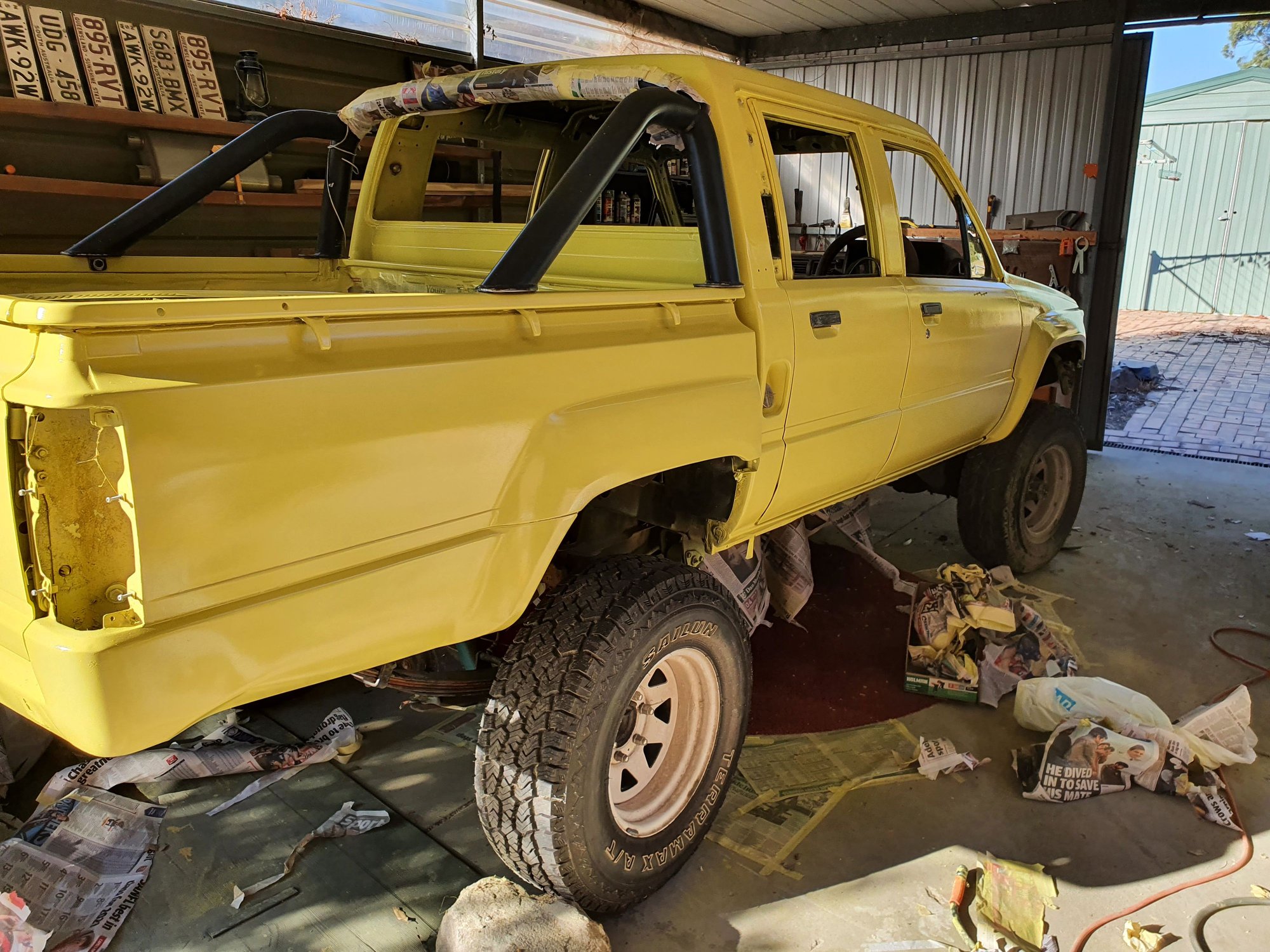

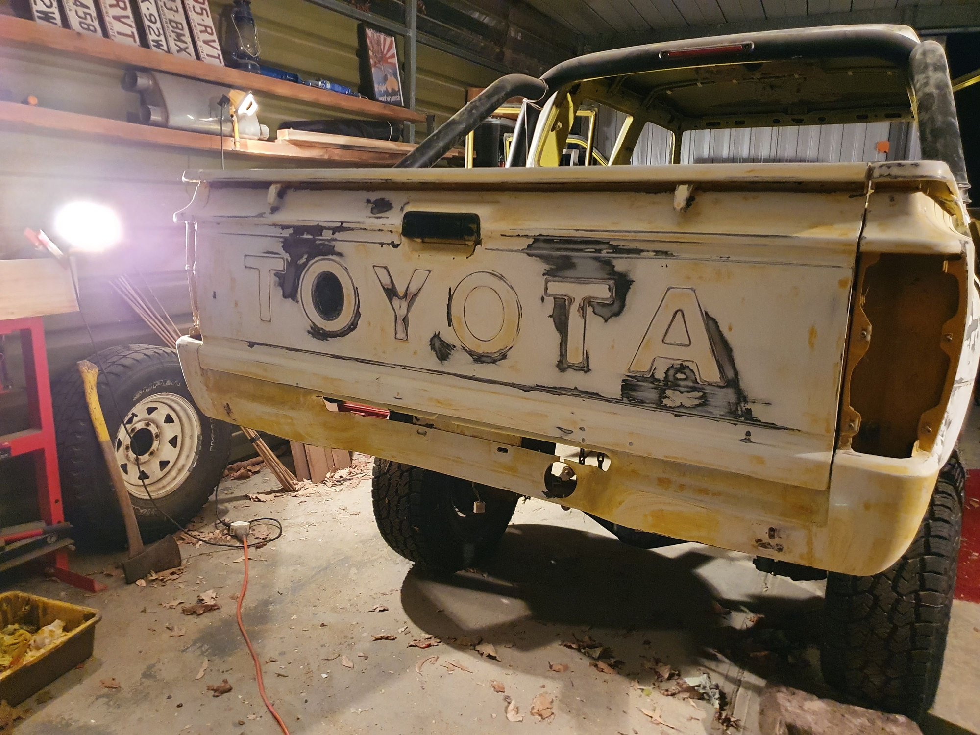

I ended up doing a fair bit of sanding back to metal, in places where it would help overall, where the old paint was still hanging on, or it was really thick in general (This thing has been painted a few times now). Im almost finished doing the main hand sanding on the cabin, and just have the tray to get through before I can start getting ready to spray!

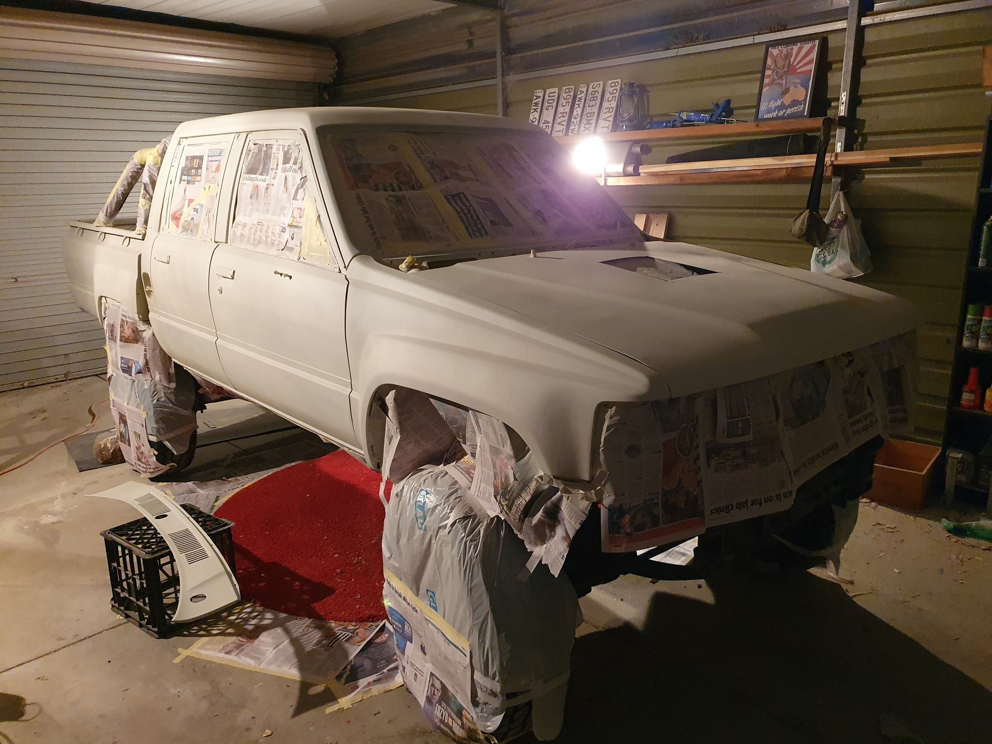

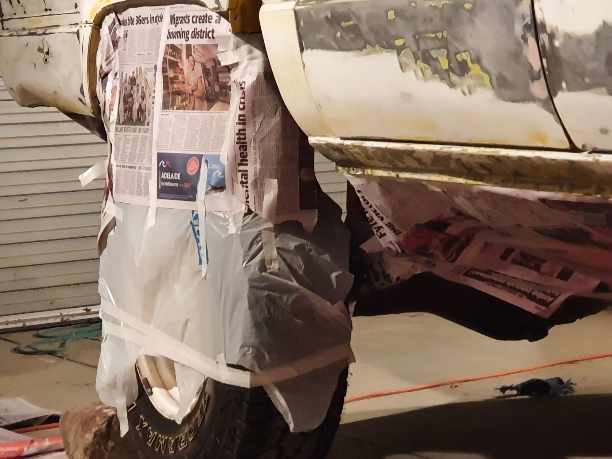

Im finally starting to mask it up ready for primer

trust me, the prep is smooth.... well, as smooth as I can bother :p

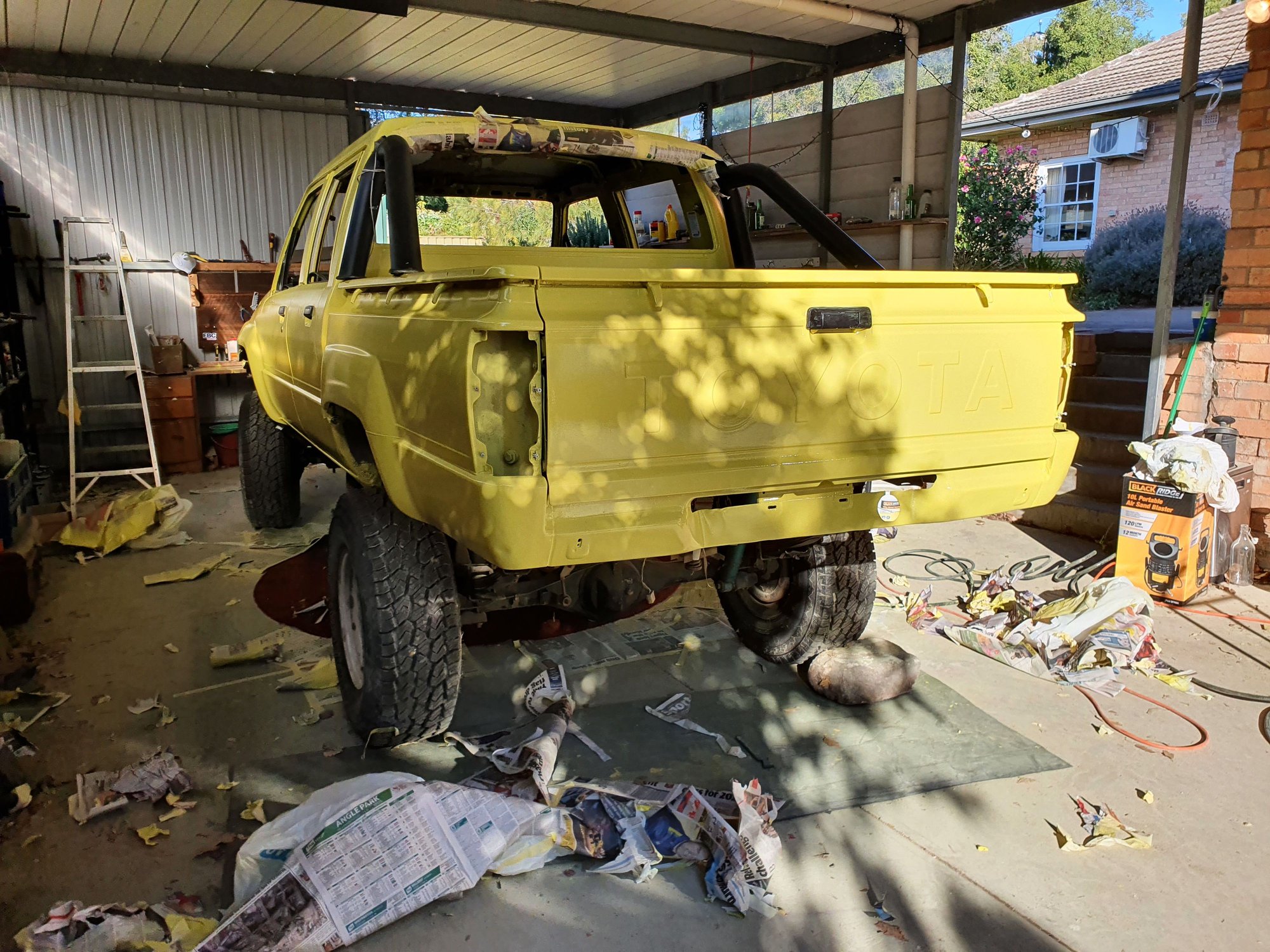

Ba Da Bing
Ba Da Boom

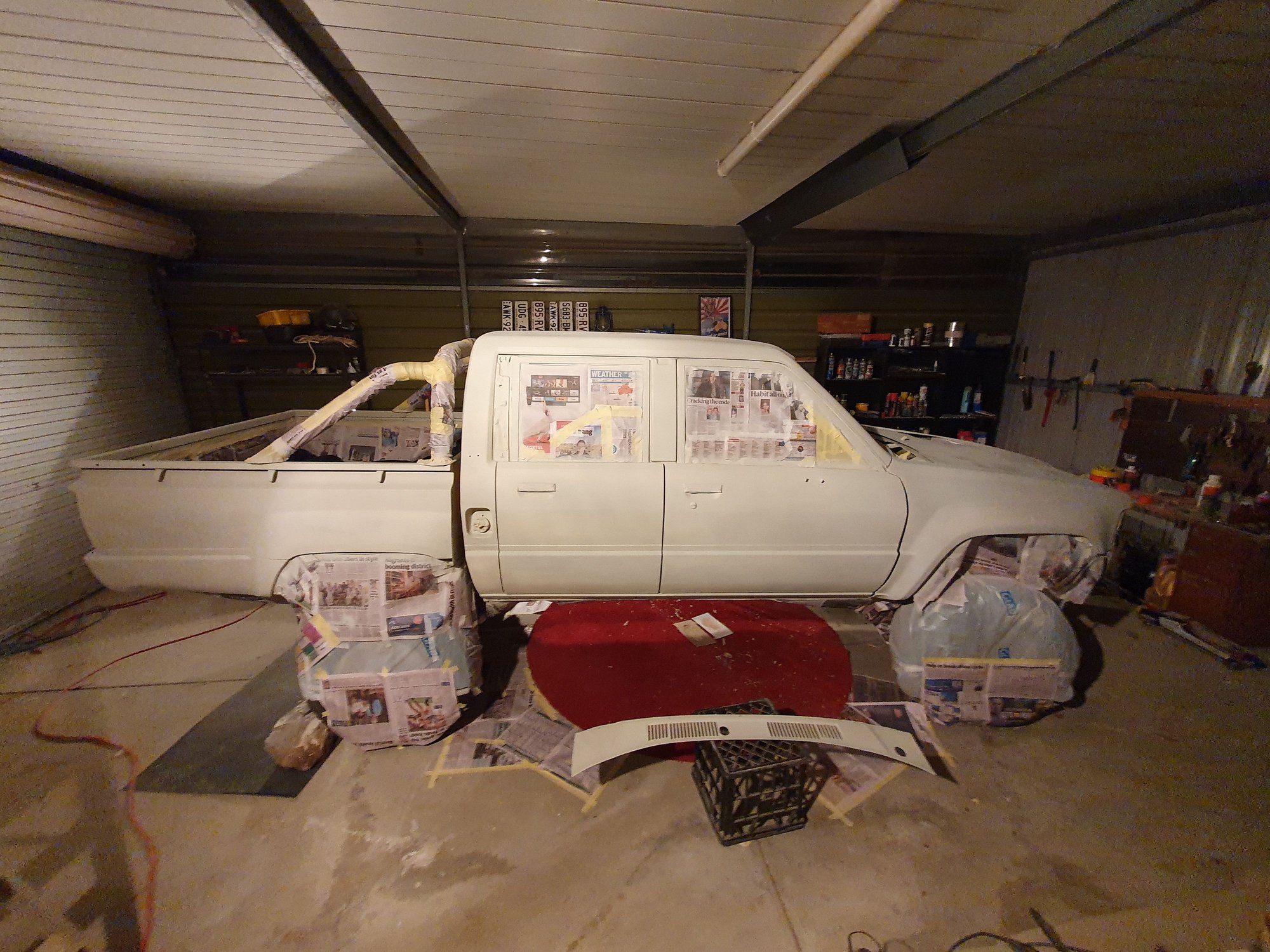

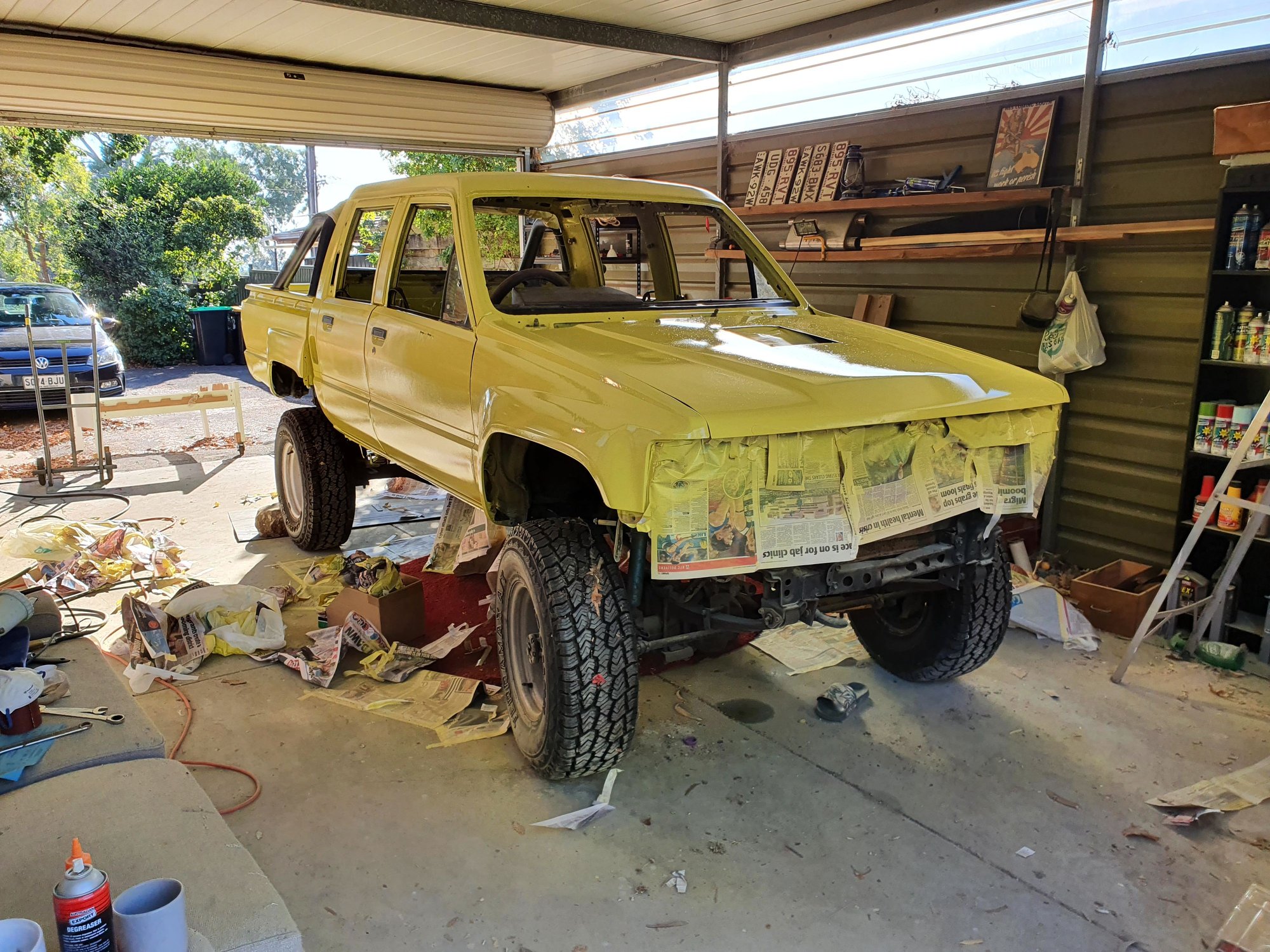

So the paint shop (it's a great place called Crash Supplies in Adelaide) didnt have a recipe for Toyota 561 yellow in 2-pack. They sent off for a recipe converaion from acrylic, but we're given this as an almost identical option via colour matching instead. It's an Audi "Brilliantgelb" (has a few numbers on the tin, I think: LY1B, but maybe F1136 or 510). It's nearly identical to the original yellow, but I'd say it has a more solid, rich pigment. Ever so slightly. It's pretty good actually!

Well... I mean dont get up too close and its amazing. I was still spraying with a $90 Gun, in a fairly dusty environment. I was surprised there were no insects about, trying to land on the fresh spray.
On an old BMW I had, I used the same gun and had a fly fly through the spray, and so it got thrown onto the surface.
Oh, and I really skimped on the roof, simply because I was spraying from thw tray and a ladder, and once the sides and tray were wet I didnt want to bother climbing back in and holding the dirty hose around, or knocking it on paint.
I concentrated on the sides, just to relly give them a solid coating.
The gun also has slow leak that occasionally would fling off at a random trajectory. So lets just say the bonnet was sprayed with a lot of different distances and angles while I was making sure no drips were coming off.
Id be keen to buy a proper spray gun or set one day, as I think Im starting to get the hang of how to do it cheaply but fairly well.

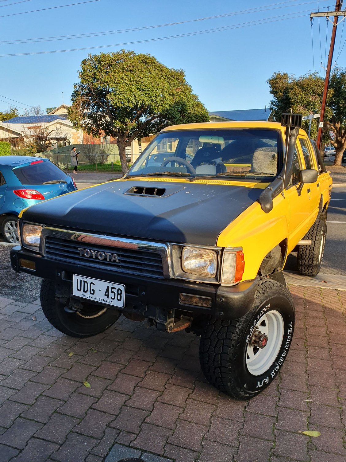

The window is in now. Cost a fair amount to have it installed, and I got a new seal. The old one was probably... 20 years old maybe. The guy did in 20 minutes what would have taken me many hours, especially by myself.

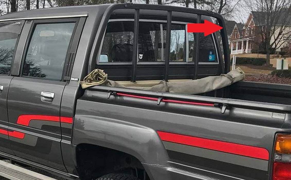

The pickups around here came with the rear glass protection you can see in your first comment photo, do you plan to install it back?

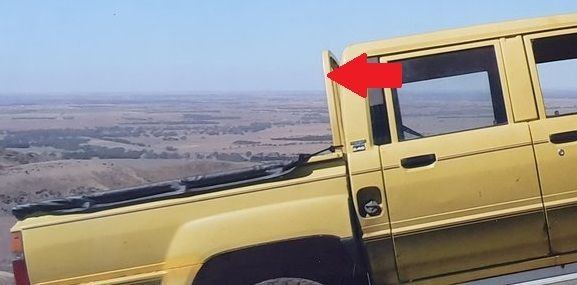

No I didnt get the part number, I think theyre generally the same on the same model. I mean most of the parts are the same throughout, but there are some differences so dont take my word on it!
Im going to put the same rear glass back in (factory glass with factory vehicle maintenance stickers) with its seal. It seems pretty easy, compared to the front. Id really love one of those sliding windowa for the back though. I dont see them here.

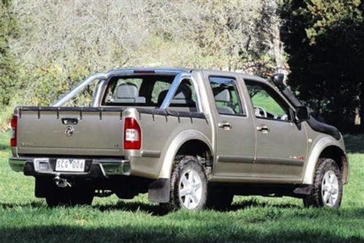

So, the rollbar is an aluminium Holden Rodeo bar, painted black. It was a factory option, and on special editions in something like 2003. It fits well on the Hilux by chance, though its a bit bulky, i.e. the feet of it jut out a bit over the thin tray wall, inside and out.

I meant the metal protection behind the cab, do you plan to re install it?:
