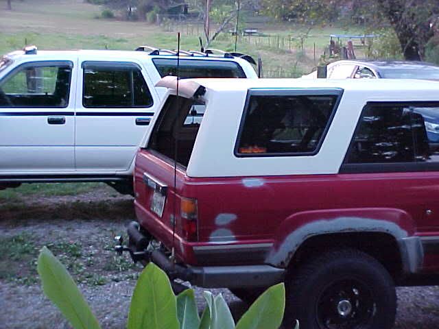

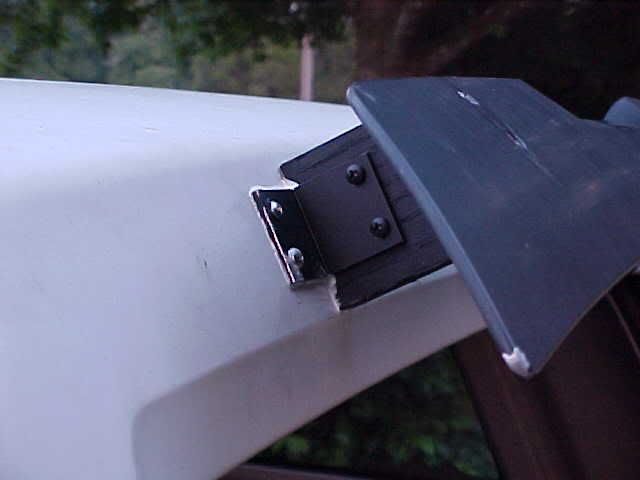

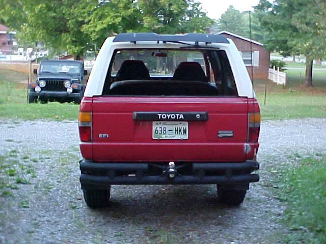

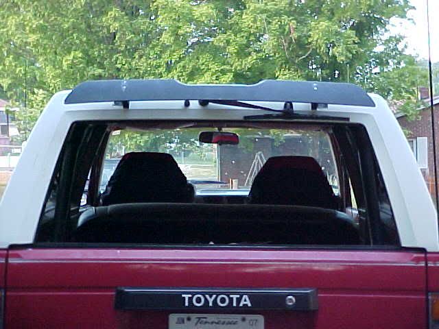

You all will remember my question regarding the fumes that roll in the rear window on my 4 runner. FIXED IT !
I bought a spoiler from a 95 on e-bay - the mounts would not work as the roof lines are different. I could not find anything that would work except wood. I used 1 X 3 solid oak to make the mounts - sealed with black gelcoat and mounted with 1 X 1 aluminum angle brackets and stainless steel screws. Sealed to the roof with 3M 5200. I did spend the last 24 years in the boat business !!!!
The spoiler works like a charm - slow speed or fast.
What do you think ? Red neck engineering !!!

I looked in JC Whitney but could not find anything that I thought would work.
I used my 2nd generation spoiler as a test and then went that route.
Maybe not the best solution but it works ! The oak wood blocks are sealed
and the 5200 seals and will never leak. I could not believe how much exhaust gets pulled through that rear window ! I was afraid for my dog to ride back there.
