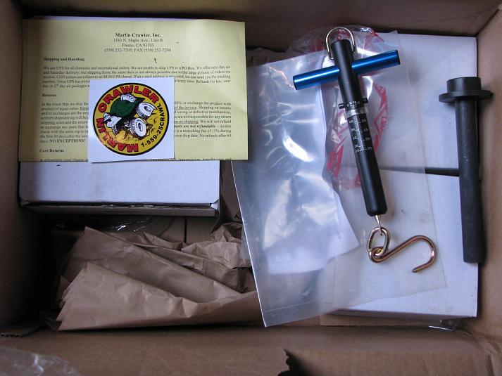

marlin crawler get the heavy duty inner axle seals.
Attached Thumbnails 1985 4 runner Front Differential/Axle Leak-winter-09-049.jpg
