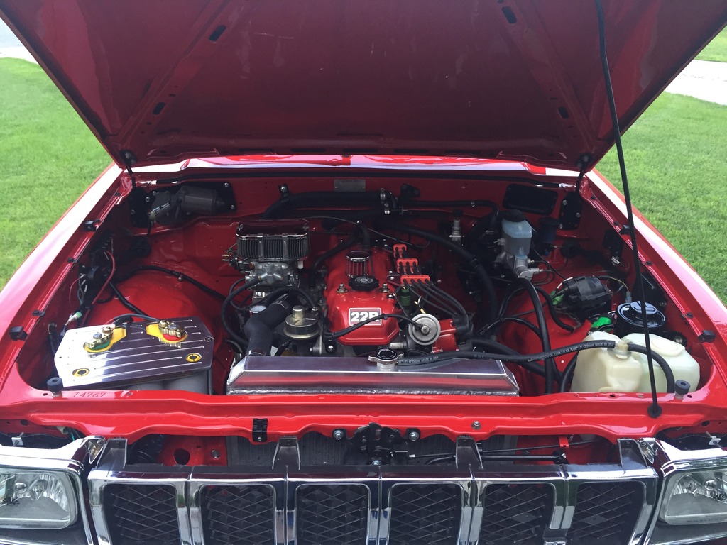

Have been screwing with it for a few days now.... It's a 84 with an 86 carb, ran with very high idle when cold started, now I'm going to do an egr delete because I heard it makes them run better, and I'm lost there are a few differences between 84-86 and I'm not sure what I need/don't need.
Old Jul 9, 2015 | 11:01 AM
kawazx636's Avatar
iTrader: (3)
Joined: Jan 2012
Posts: 3,218
Likes: 26
From: Salisbury, MD
What you need for hoses:
-Distributor vacuum advance (one or two vacuum hoses depending on which distributor you have)
-Brake booster vacuum hose
-Heater hose (assuming you keep your heater)
-Radiator hoses
-Fuel lines (Assuming you have a mechanical fuel pump - one return from the pump to the tank, one supply form the tank to the pump and one supply from the pump to the carb)
-PCV hose
Sensors/wires need on the engine:
-Oil pressure dummy light sensor
-Oil pressure gauge sender (if you have one)
-Water temp sensor
-Distributor pickup plug
-Coil wire
-Electric choke (if you have one)
-Ground cables
The rest goes. Read up here, it'll tell you everything you need to know:
https://www.yotatech.com/forums/f114...torial-264405/
Your engine will look something like this when you are done:
