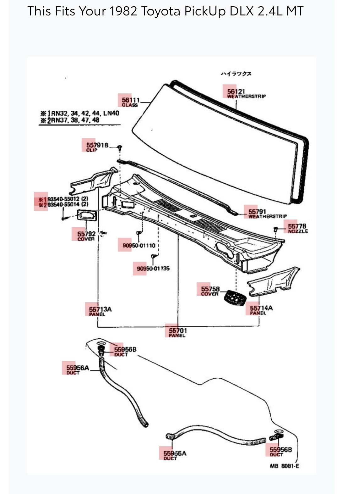

I got my 1982 pickup today and not long after it started raining. It didn’t take long for me to realize that the gasket has shrunk and dry-rotted. I need to replace is ASAP and would prefer to go with OEM unless there is something better. Do I just need part number 56121 or do I also need 55791?

55791 is a gasket for the cowl panel, actually where the hood sits on the cowl panel, you don't need it. Rockauto has gaskets also. My local glass shop said they can get the gasket too, probably from Rockauto. Is it still available from the dealer?
