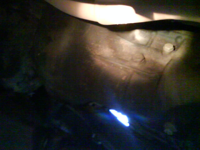

oh crap i meant driver side was watching wabbits cam and tryng to type
went and got pics of mine look at me giving advise like i think i know somthing
Attached Thumbnails where do you check tansmission fluid level on 81 pick up-dsc00507.jpg   where do you check tansmission fluid level on 81 pick up-dsc00506.jpg

lol thanks guys how full should it be? like should it be leaking out when i take the bolt off or should it be lower?
Old Apr 22, 2010 | 07:34 AM
dropzone's Avatar
Fossilized
iTrader: (6)
Joined: Oct 2005
Posts: 19,771
Likes: 456
From: PNW
it should be right even with the bottom of the hole...make sense?
if you have more than that (not sure if you have a side shifting L43 or a top shift L45 or L50) you could have some water in there....unless it is a top shift, sometimes people will fill the transmission through the shift hole..
Old Apr 22, 2010 | 12:55 PM
83's Avatar
83
Joined: May 2008
Posts: 4,591
Likes: 126
From: Montana
As mentioned already, if you stick your finger in there, it should get wet. If you don't easily hit gear oil with your finger, you need to top it off. What I do with mine is fill it up until it starts to run out, then put the bolt in. So when I go to check mine (if there's no leak), a very small amount will run out of the fill hole. But as long as the level is right up there at the top of the hole, and you can get some on your finger, it's likely full enough.
