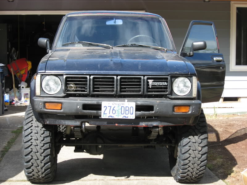

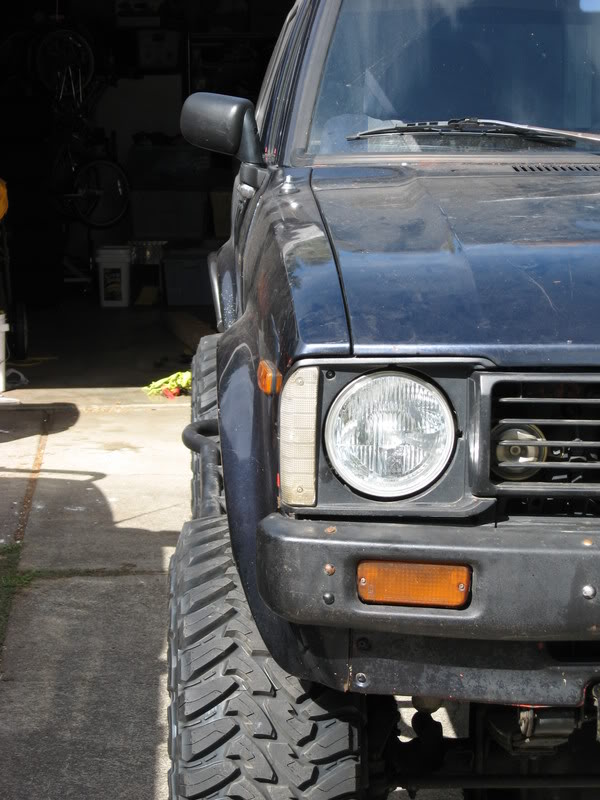

here are what 1.5" spacers did for me on my '81, granted these are 3" BS 15x8's..not sure if it helps. Just be sure to stay away from something like a 1/4" spacer from Schucks or somewhere like that. You won't get enough threads biting for the lug nuts...had a bad experience with that on my '84 about 10 years ago.
Also do a test fit before you buy them. I have two used rims from the pro's at Les Schwab that have got to be IFS rims (won't clear the caliper at all) but they swore up and down that they were SA rims. Realized it too late to return them
Before spacers:
After 1.5" spacers:
Now the tires are fairly even with the sliders but stick out a ways:
