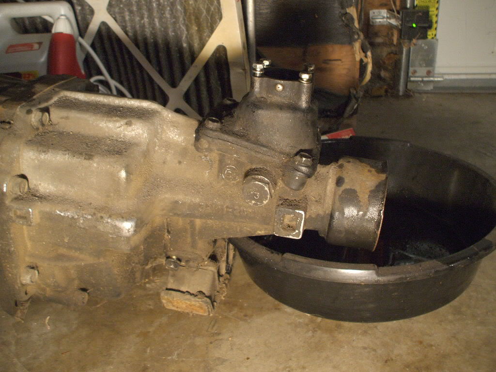

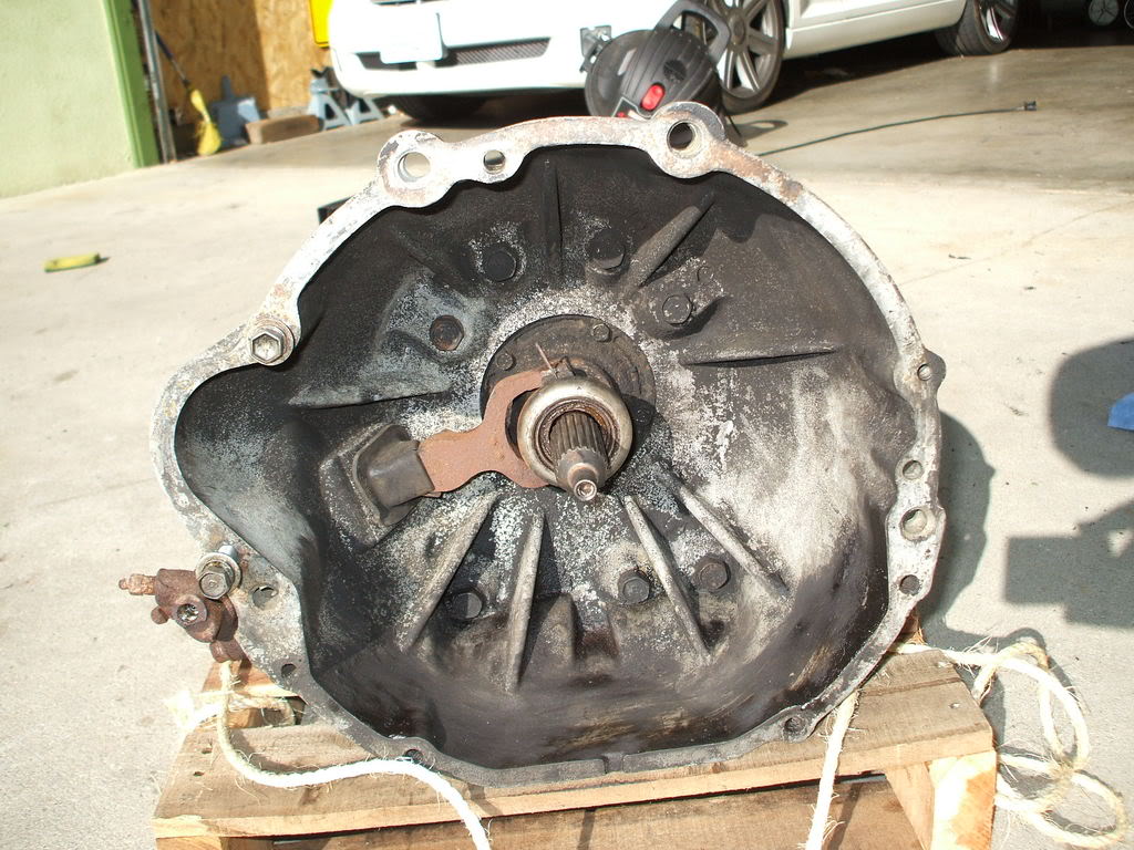

What transmission is this?
Not sure what this is, i cant find a picture of a l45.
anyhelp is appreciated, The motor and tranny are for sale if you want them.

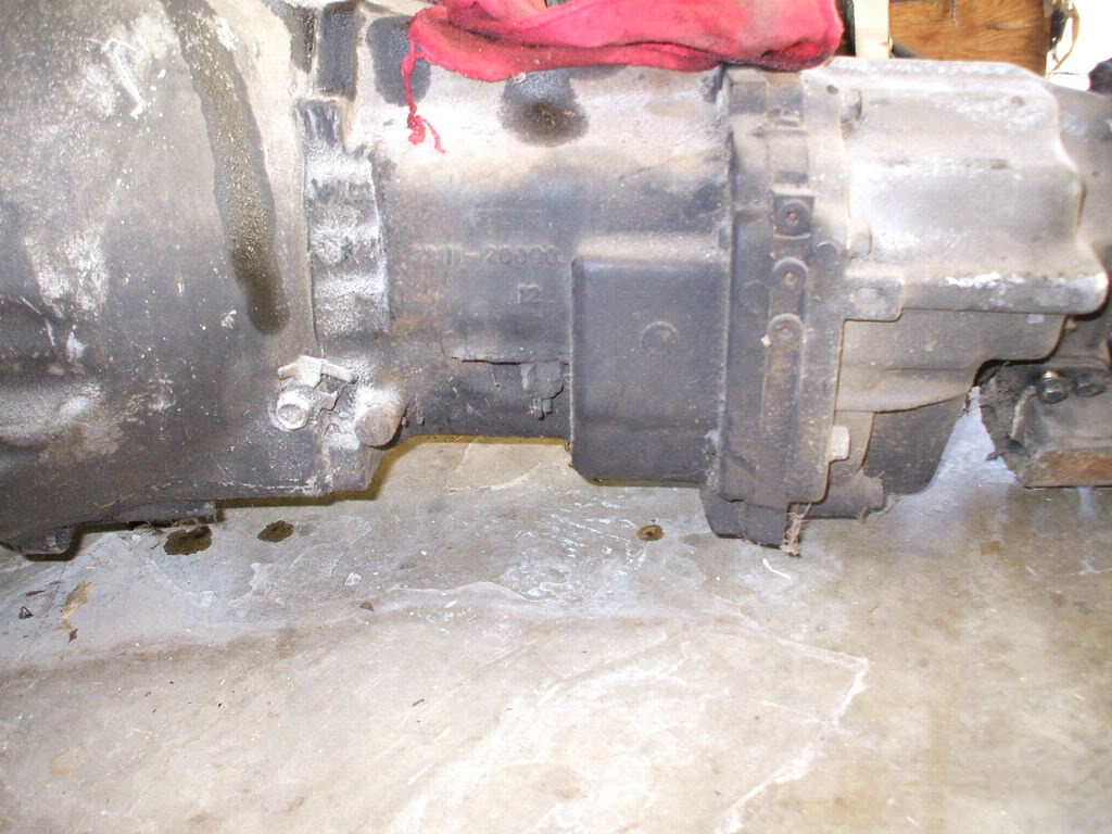

the 200090 on the side is also on the side of my w50

If its really from a 79 truck as you stated, it will be a W42.

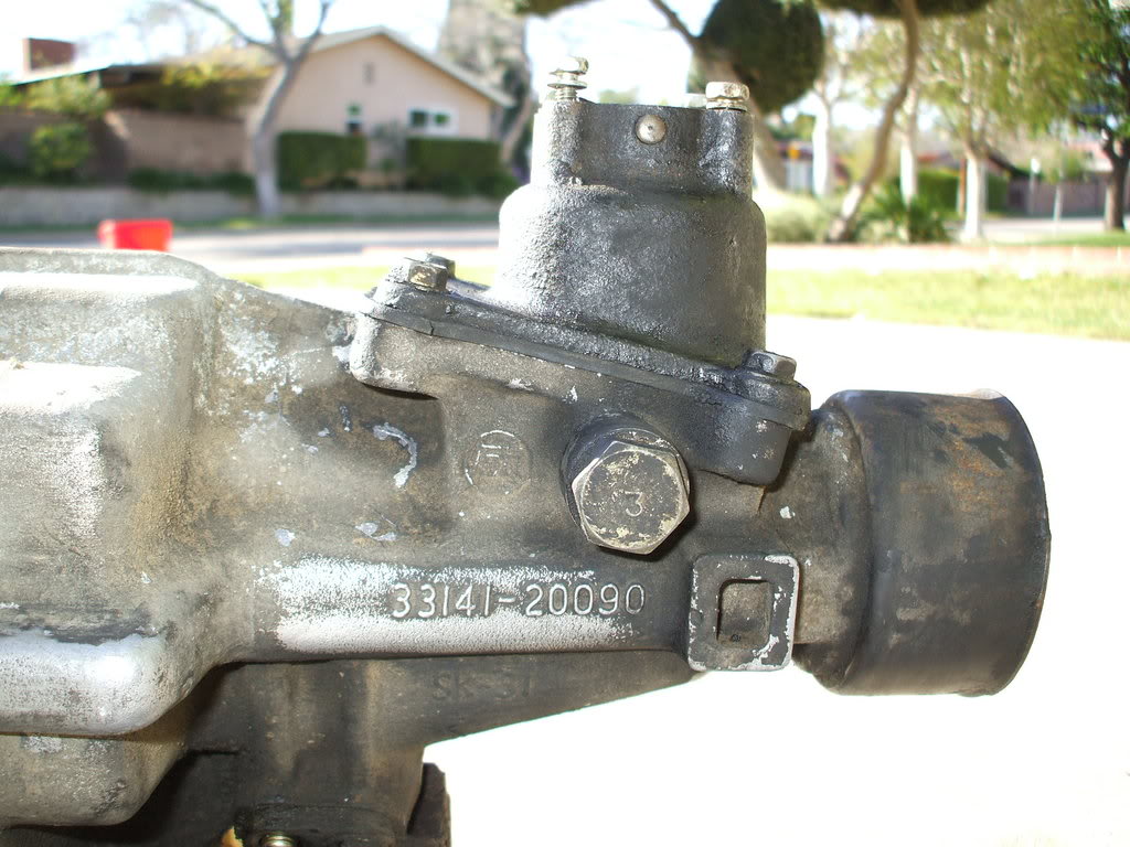

the number on the side of the trans is 33111-20090.

Though yours looks a little different,
the numbers are the same as on the side of mine- w50 (5-speed)
a somewhat better way of telling, does yours have 33141-20090 stamped towards the rear? if so, i'm 999.9% its a w50
Ill check tonight. Would you happen to have a extra shifter?

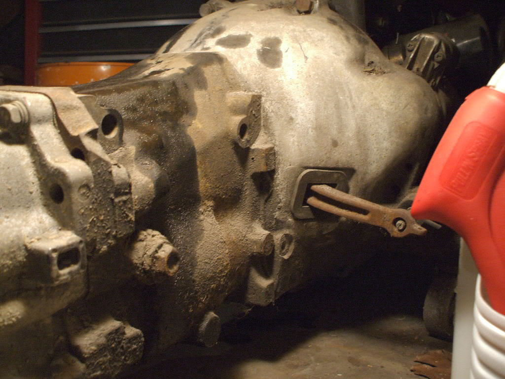

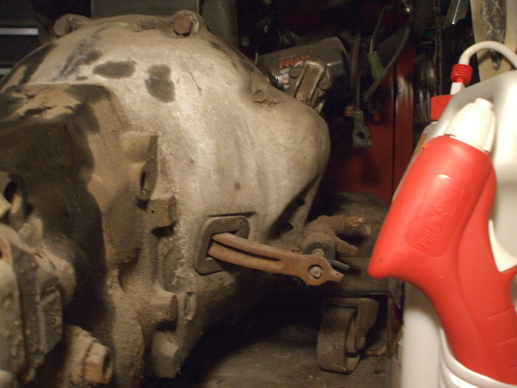

well i have a good one for you. i drained the tranny fluid the other day and stuck a magnet in it and there is no metal shaving in it. all the gears spin smooth.

Aluminum bell housing/cast iron midsection/aluminum tail shaft housing = W50 5 speed 2WD....just like the one in my '79 longbed.
