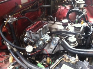

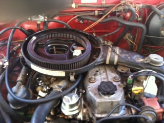

Just recently installed a offy dual port intake and weber 32/36 carb with electric choke on my 86 pickup. Also added a 1 inch spiral spacer. Removed all emission related components. Noticeable difference in power and it has a nice sound to it. Getting slightly better mpg as well. Another bonus is that it really cleans up the engine compartment.
Attached Thumbnails Weber & Offenhauser Questions-truck-1.jpg   Weber & Offenhauser Questions-truck-3.jpg
WOW! that does look a heck of a lot better! I am looking to do this conversion myself. Just rebuilt my 22R with a cam and other some other goodies, threw a w56 behind it as well, so i need a few performance products to match.
Hoping to find the dual offy and a matching Weber somewhere around here in the NW. I know people have they laying around from old projects. Speaking of which PM me if you are interesting in selling that extra weber you now have.
I have also not heard much about the C-series, what exactly is the difference between the two?
