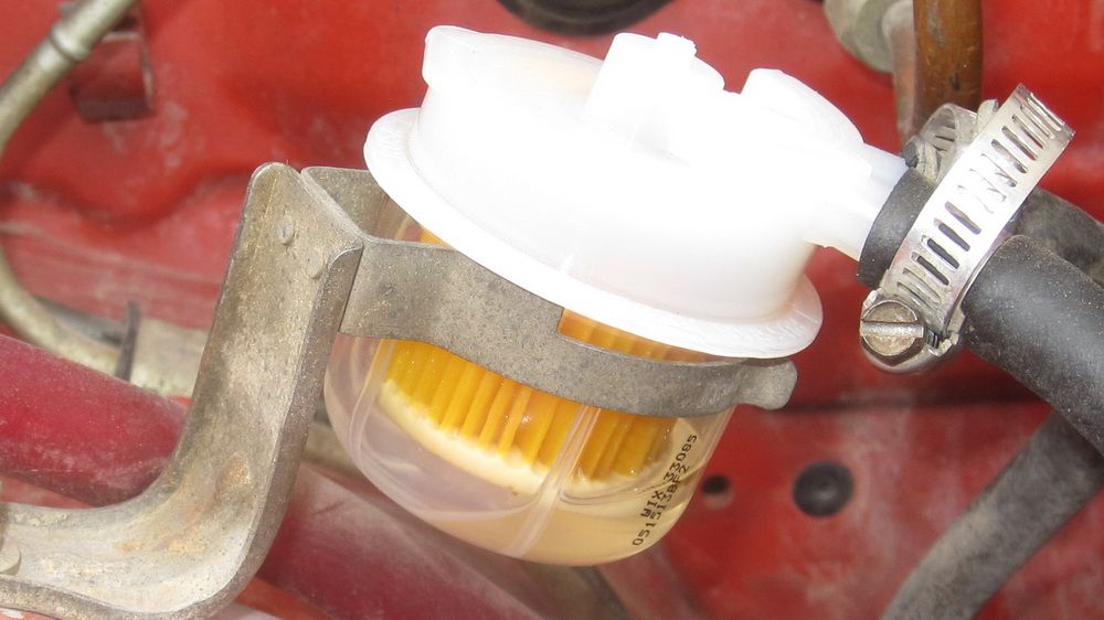

Also, it seems like my fuel filter is practically empty when I try to start the truck.
I thought that may be the reason it takes so long to get it started, but noticed it looks about the same level after it is warmed up and running. I replaced it with a new one but it has the same level. Maybe this is normal?

As for the fuel filter mine does the same and I think it is normal.

Good to know, thanks!
