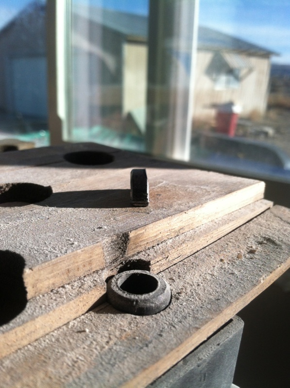

Here you can see noticeable wear at the center of the Key.

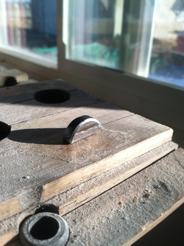

Here, you can see the wear at the top of the key, yet still minimal.

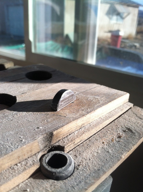

Just another angle to show the wear a little better.

I'm pretty relieved though, it could have been much worse. I suppose these old 20r's are a little stronger than I anticipated. I was gearing up for a completely mangled Key Way.
I'll keep every one posted on how the re-install goes. Thank you for the tips, cause I may still need them. But as of now, it seems like a new key will be a nice tight fit.
