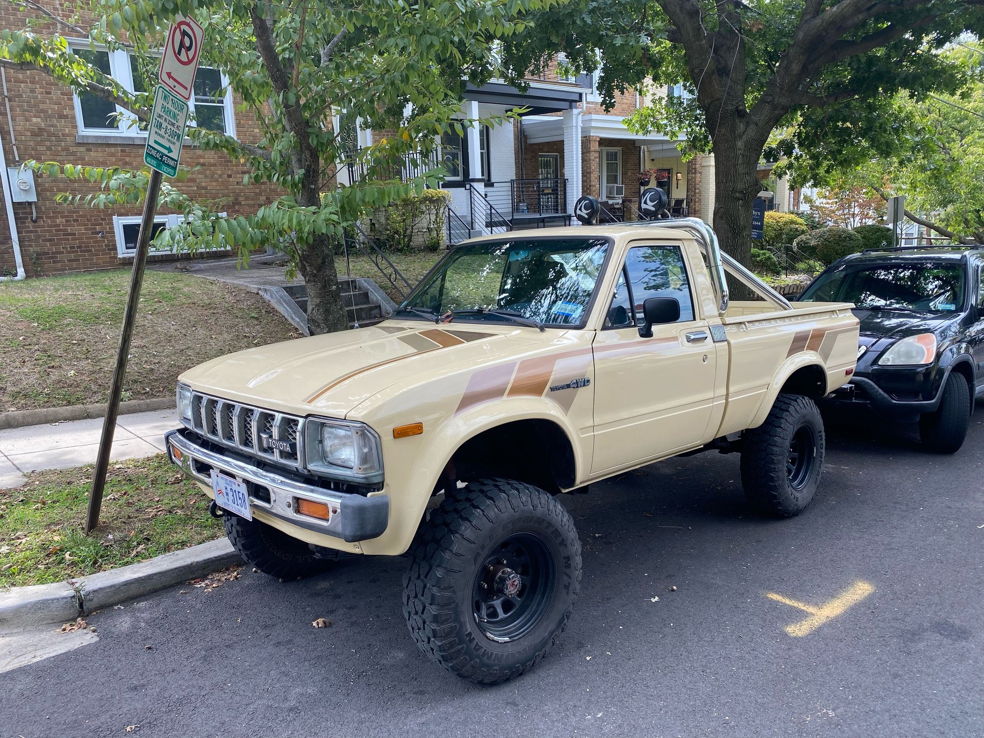

Good looking truck. Bite the bullet and do it right. The "while you are there" list may seem long but it's better than having to go back into it.
