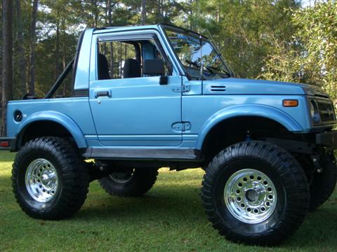

Here's a picture of the Samurai that I recently built and sold.
Mike
