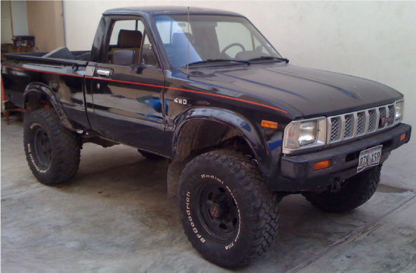

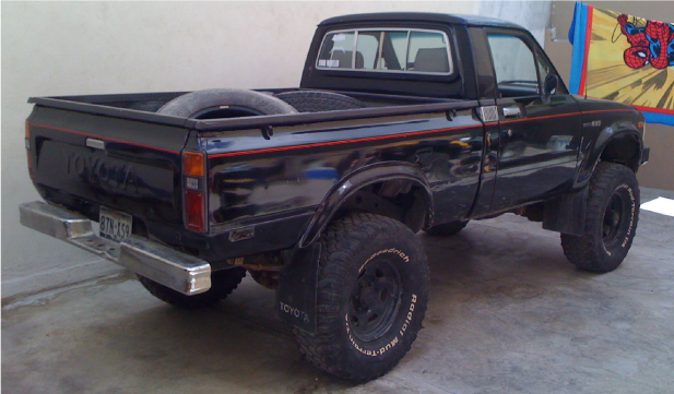

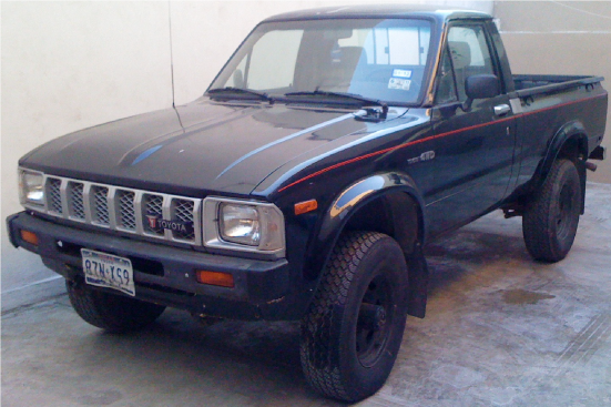

Here are some before and after pics of my baby...
Sorry for the shots not being action shots, but at least you can tell the diference.
I love the way these little trucks look with some moderate lift and bigger tires...

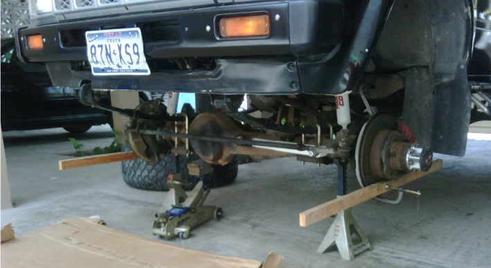

I did the alignment my self, I followed the 2 pieces of wood attached to each wheel disk procedure.
Before I did any adjustments, I measured both front and back, the diference was about 1 inch. The front was measuring about 54", and the back measured 53".
After adjustments, front read 53 9/16, rear measured 53½, only a 1/16 difference (I could get them to measure exactly the same).
I drove my truck after this and the steering wondering went away, now the steering follows werever I tell it to go.
Here are some pics of the method I used for adjusting the alignment.
I also adjusted the steering box adjusting screw and tightenned that one and kept the play tighter.
Again, thank you all for your help...
