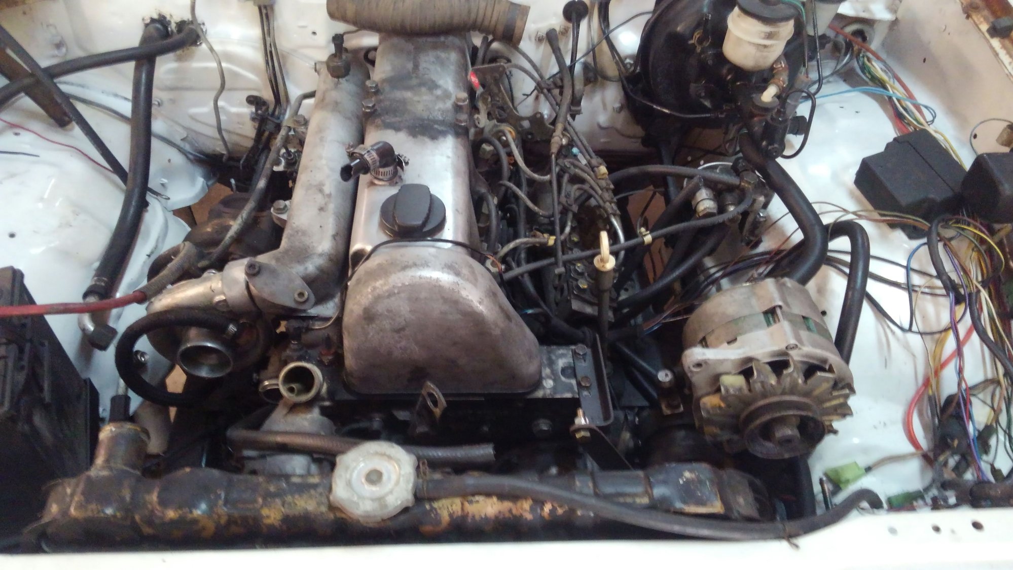

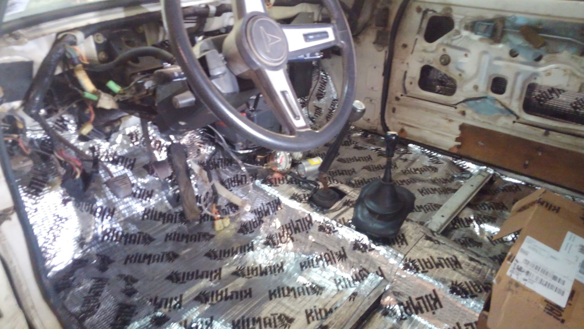

Its been a while, so to keep this going, here's a few updates. I haven't got as much done as I wanted but here it is.
I got the crossmember and driveshafts in.
finished up the accessory brackets except for the belt tensioner.
I got some KilMat to help with the cabin noise and Carpet is on the way. While I'm waiting, I'm going to convert all the dash lights to LED, and fix a few of switches that need replaced.

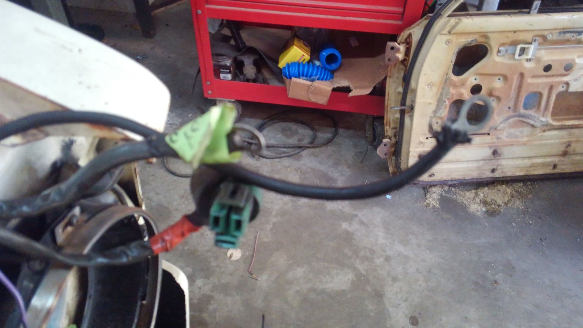

I'm running into one road block if anyone on here can help with. I'm going back with the factory, externally regulated alternator, and I didn't mark the two spade end wires coming form the same harness as the Alt plug. Anyone know where these go?

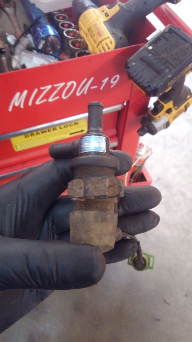

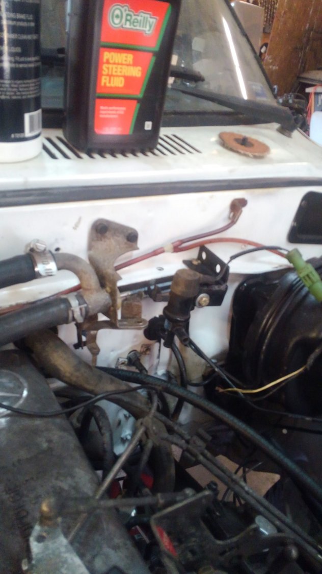

I took a couple of days off and got through quite a few of the little things i had lined up. I was hoping to have a First Start Vid for you today but I was short a few clamps and ran out of time. I did get the engine turned over and got it to build oil pressure so far, NO Leaks!
I got around to running the Vac Lines to the breaks and the Fuel Shutoff Solenoid. I reused a solenoid form the EVAP system.
It's wired right(Power to Close) I mounted it up to the firewall, now I just need to find a keyed hot circuit.

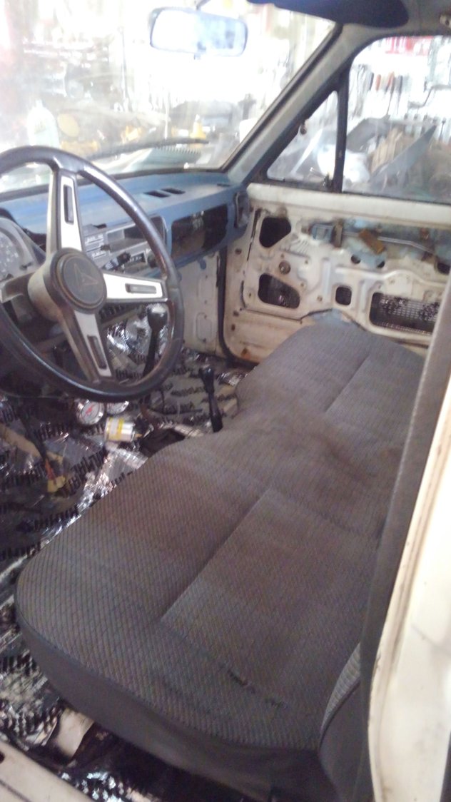

Once I figured out I wasn't going to get it started, I threw the seat in to make sure that I could still shift the 4WD lever, I can but it's close, I'd still like to find a pair of old Bucket Seats.

Success!,
It's been a while but I finally got it running and moving under it's own power.(sorry can't figure out how to upload a video on here)
the evap solenoid I used for a the fuel shutoff works great. Now I need some exhaust and I can do some shakedown runs.
