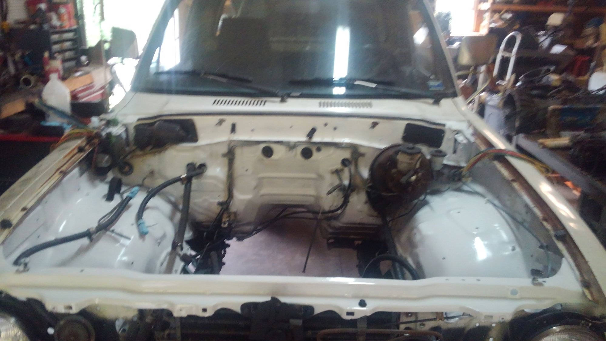

I posted some of this under the Diesel Swap section, but I figured it would fit better here.
I'd been planning on a repower for a bit so when a coworker gave me a deal on an 82 300D, I decided that was the way I was going to go.
I drove it on the trailer, and after a few hours at the shop, I took the power washer to the engine.
that's were the engine sets right now.
I've got a gasket kit ordered for it to take care of some oil leaks, and I still need to get with Joe at Doomsday, for the adapter, I've just been dragging my feet.
While the engine was out, I went ahead and pulled out anything I thought I wouldn't need anymore (Voltage regulator, Evap can, etc) and started cleaning up the inner fenders.
Before:
Test fir the Engine, It's gonna be tight.
After:
Next is more clean-up, and over to the Pic-n-Pull to find an A/C compressor that I can squeeze in.
I've got a Rough Country 3" lift laying in the corner, and a W-56 to go behind it, that I need to pay some attention to.
