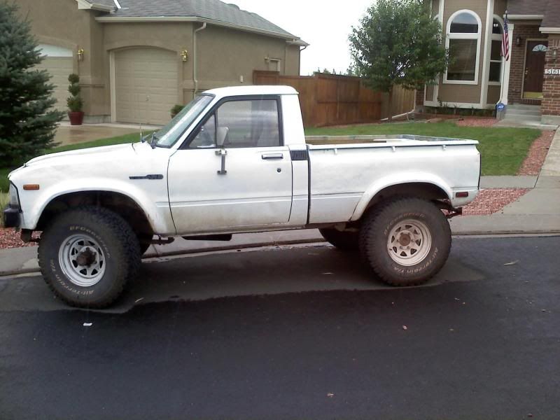

been worknig on the idea of bobing my bed. but not to sure how hard it is do. I dont need all the space in my bed so I want to shorten it about 12" or even make it as lon as it is wide... I want to keep all my bed hooks on the sides and keep all the body lines and the rear marker light...
I also want to build a bed rack that goes up cab height andhas a rack up top to carry extra but is removeable and cover it with canvas to make a soft top with roll up sides
here is a pick how I want to do it (had fun in photoshop)
