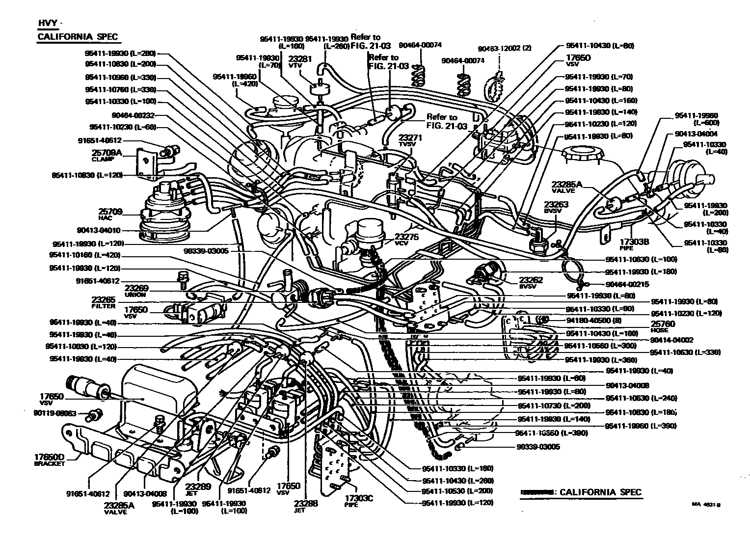

1981 Vacuum Diagram
Here are a few diagrams.
Attached Thumbnails Need a 1981 CA vacuum diagram, FSM download/pic is Ideal-vacuum-piping-ma4928b.png   Need a 1981 CA vacuum diagram, FSM download/pic is Ideal-vacuum-piping-ma4929b.png   Need a 1981 CA vacuum diagram, FSM download/pic is Ideal-vacuum-piping-ma4931b.png
