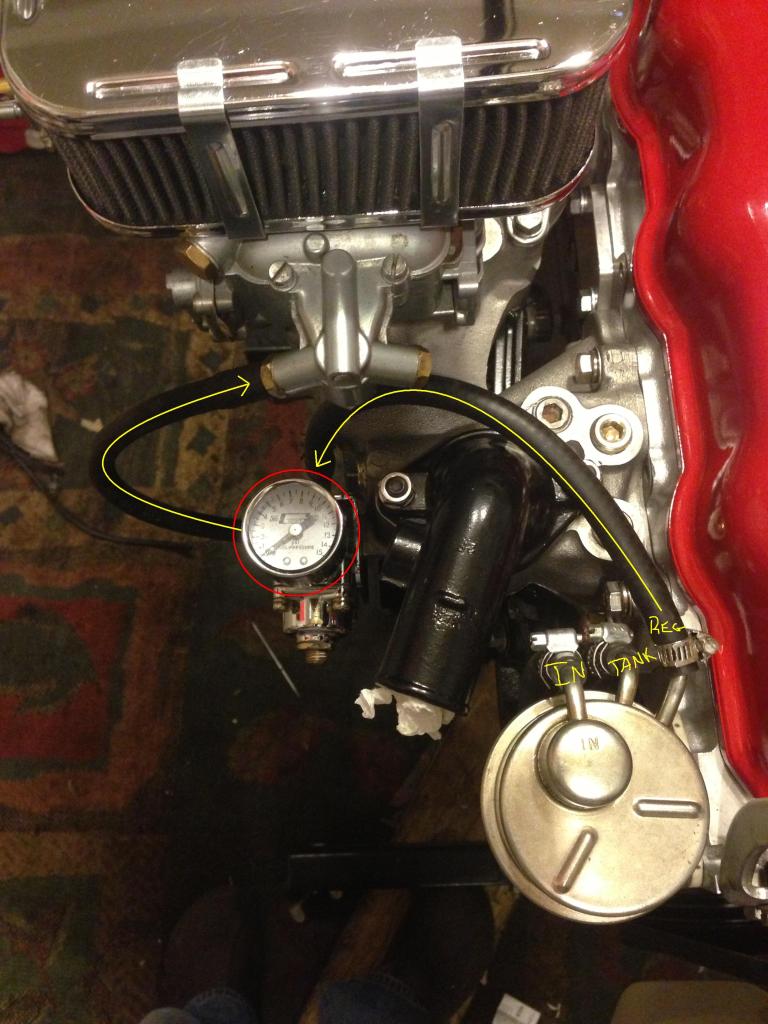

Originally Posted by 83Toyota88
I think you can find the picture on kawazak desmog thread that shows the different lines.

Originally Posted by toyospearo
Link?
Boom:

thattl work

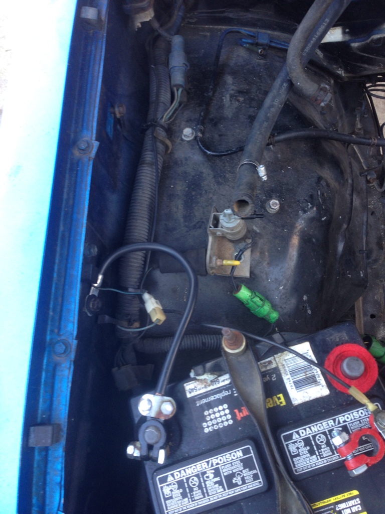

Dang, stealing my pictures again?! I was actually just able to post that exact picture LOL
I was thinking a flooded condition when you said it took a while to turn over, but eventually did. Then you said that you had the return line plugged and the flag went up. So basically what is happening is that you are force feeding your carb. The return line is there so that when the fuel pump is pumping more fuel than the carb actually needs, it will return the excess to the fuel tank. It is also there to help relieve pressure on the fuel line to the carb when the engine is shut off. So with out it, I imagine that you have some residual pressure on the fuel line to the carb that is flooding the carb while the engine is not running which would also indicate that you either removed your fuel shutoff solenoid or it may not be working properly. Does the engine diesel down when you turn it off?
And the return line to the take should be located on the passenger side fender wall. You can see it here in the very top of this picture:

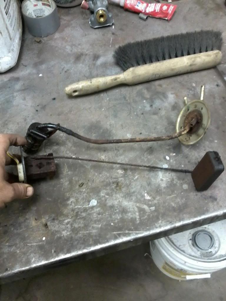

Not sure if it your problem, but I have seen several trucks with clogged return lines on both injected and carbed trucks. May be due to the humidity of the area that I live in or the poor quality of fuel that we have now a days. If I recall right on a carbed truck both the supply and return line is on the inner fender.
I try to blow on the return line with the pressure of my lungs and see if it clear. If it is clogged, I use a gear oil bottle cap as a funnel and fill it with Marvel Mystery oil and let it soak a few days and keep filling it as it works it way thru the lines. Then I clear it with a high pressure air hose to clear the lines with gas cap removed. If you just try to clear it with high pressure air, I feel you could compress the debri in the lines. The mechanical pump does put out a lot of fuel pressure and seems in my mind it could cause flooding.
You also have an in tank filter that I have seen clogged with a varnish like shell around it. You can see one I have in the background. Fuel filter is hard as a rock also.
Part number for a new intank filter is #77023-12050. On ebay it is called a TOYOTA FACTORY NIB FUEL FILTER SUCTION TUBE DIESEL. It was selling for $4.50 when I finally found it. I paid $15 at Toyota.
