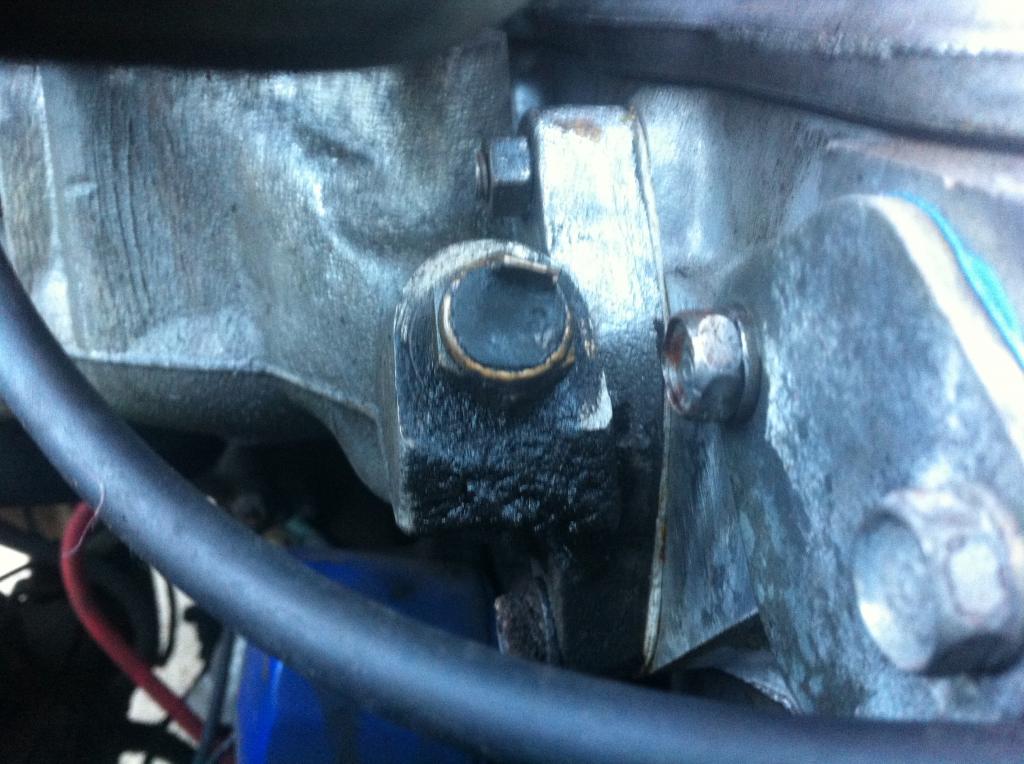

But I found where it went pretty quick, on that piece right underneath it, this thing. What is this and what does it do?

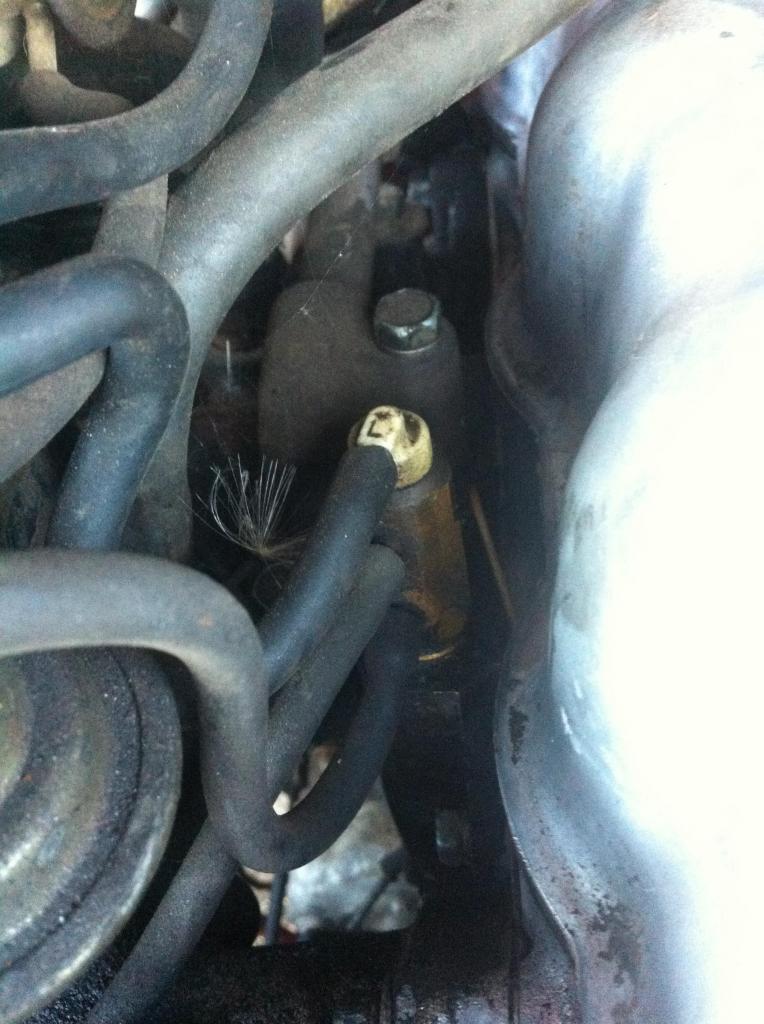

I also found this, it's a bad picture but it looks like a sending unit or something like that. It's mounted on the intake manifold and there's no wires anywhere near it, any idea what it's for?

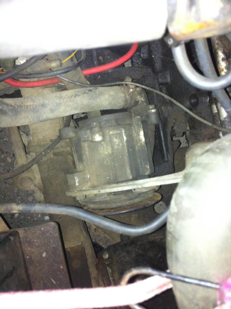

And then there's this, there's no belt connected to it so it's not doing anything anyway, just curious. At first I thought AC compressor but then saw that those big hoses on it go into the air filter housing. Smog pump?

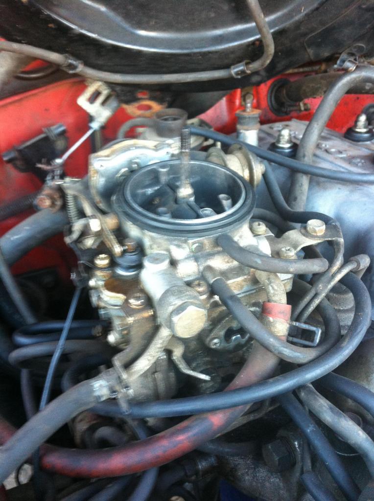

As far as the carb itself, is this the stock one? It has Aisan stamped on it.

Yes a loose vacuum hose could cause your problems.
That pulley is your smog pump. Having it disconnected shouldn't effect much. It pumps air into the mixture to help burn up any unburnt fuel. Mine is disconnected in my truck, and the only thing that happened is it stopped backfiring
Most of your questions are asking about the emissions system. Most of us know pretty much nothing about how all that stuff works. If you really want to figure it out...that would be great! Then teach us all. Most responses you'll get around here about all those vacuum hoses is: disconnect and plug them all, ie "desmog".

That vacuum switch you connected the vacuum hose too is part of the carb choke system most likely.
