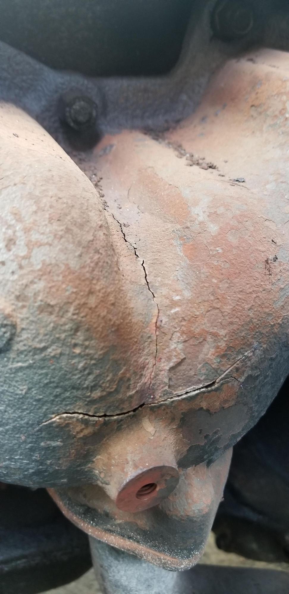

Pulled off the heat shield to start and found this little surprise.
Old Oct 19, 2019 | 11:10 AM
IdleIvey's Avatar
Joined: Sep 2019
Posts: 16
420 braze it boys!
Old Oct 19, 2019 | 04:57 PM
Punjab's Avatar
Joined: Jun 2017
Posts: 237
Likes: 54
From: Crawlorado
Haha yep close it up!

Originally Posted by IdleIvey
420 braze it boys!
Or, buy a header from LCE when you order the EGR block-off plate.
Old Oct 20, 2019 | 12:05 PM
IdleIvey's Avatar
Joined: Sep 2019
Posts: 16
Headers would be a cool upgrade but I'm on a budget. LCE headers are like 360 and I imagine I might to do some fab work on the exhaust to get it to line up.
Brazing would be a lot cheaper if I can find someone with an O/A torch.
