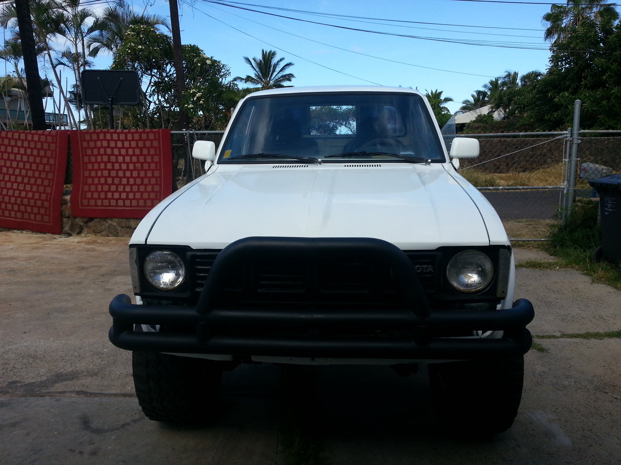

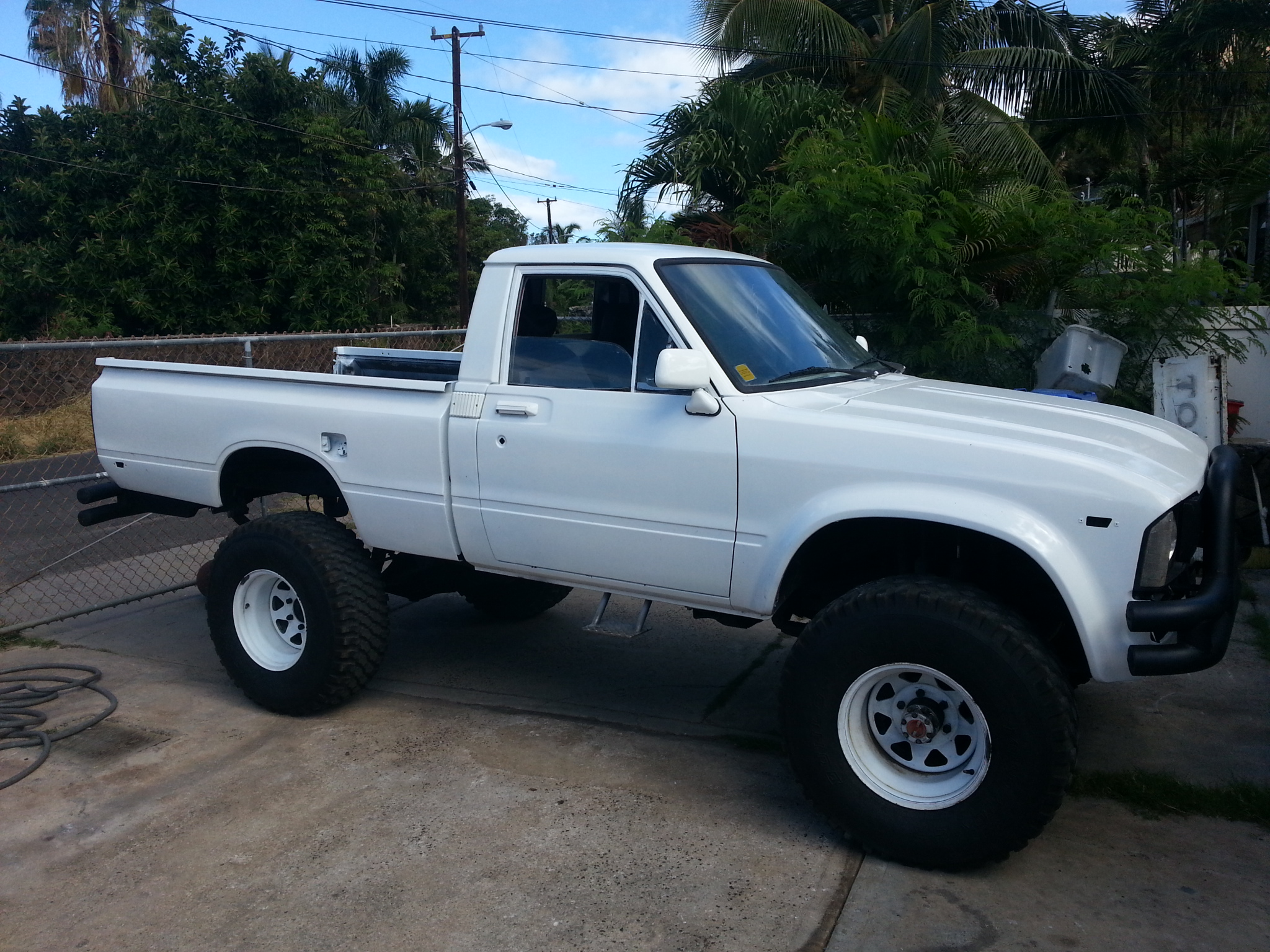

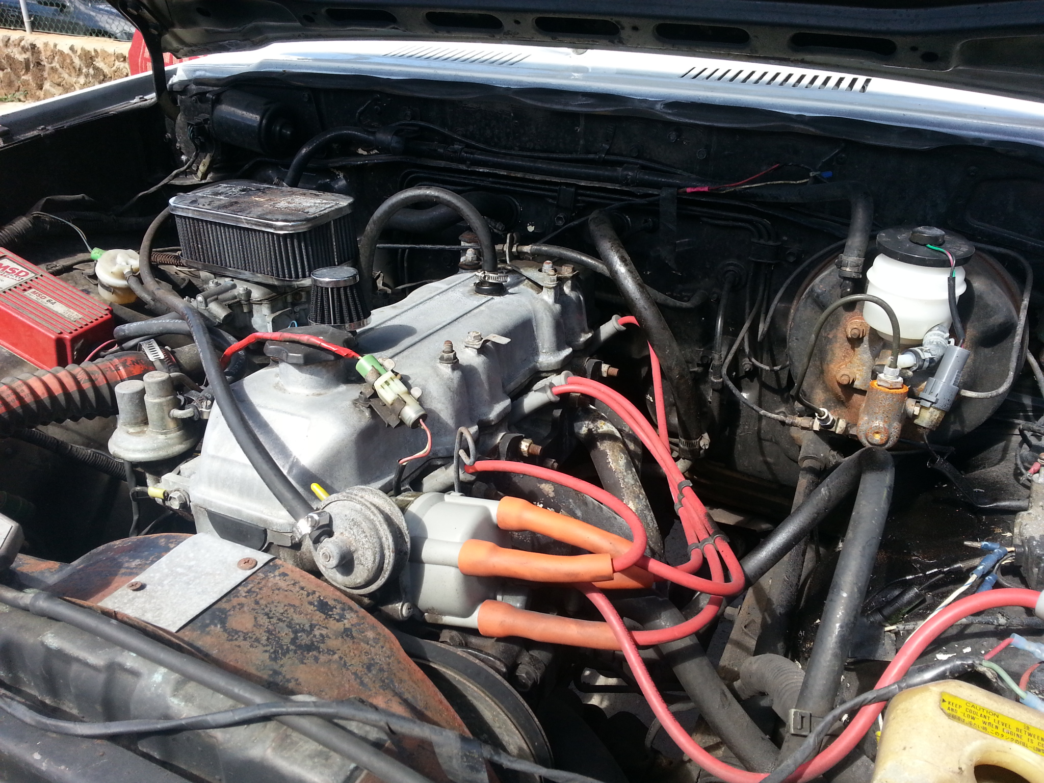

81 toyota short with custom long bed
i just blew the trany on it and was wondering whats compatible? 22r4,5spd,4x4.i had to break hard or else i would have ran over a little souyu burner,i hit the clutch skid my tires and just missed that little honda.i was in third gear and dropped to second when i hit the breaks,i shifted back to third and fourth then tried to go in fifth. it wouldn't so i kept going in fourth when i got off the free way gear oil was every where.i
long story short i had to tow it home.i just dropped the trany. now im in search of another.any help is appreciated.

donedeal, I like those mirrors! Did you get them off of another vehicle or are they the generic aftermarket joints?
Yea those mirrors are generic. Pretty cheap like less than $30 for the pair. They were chrome plated.

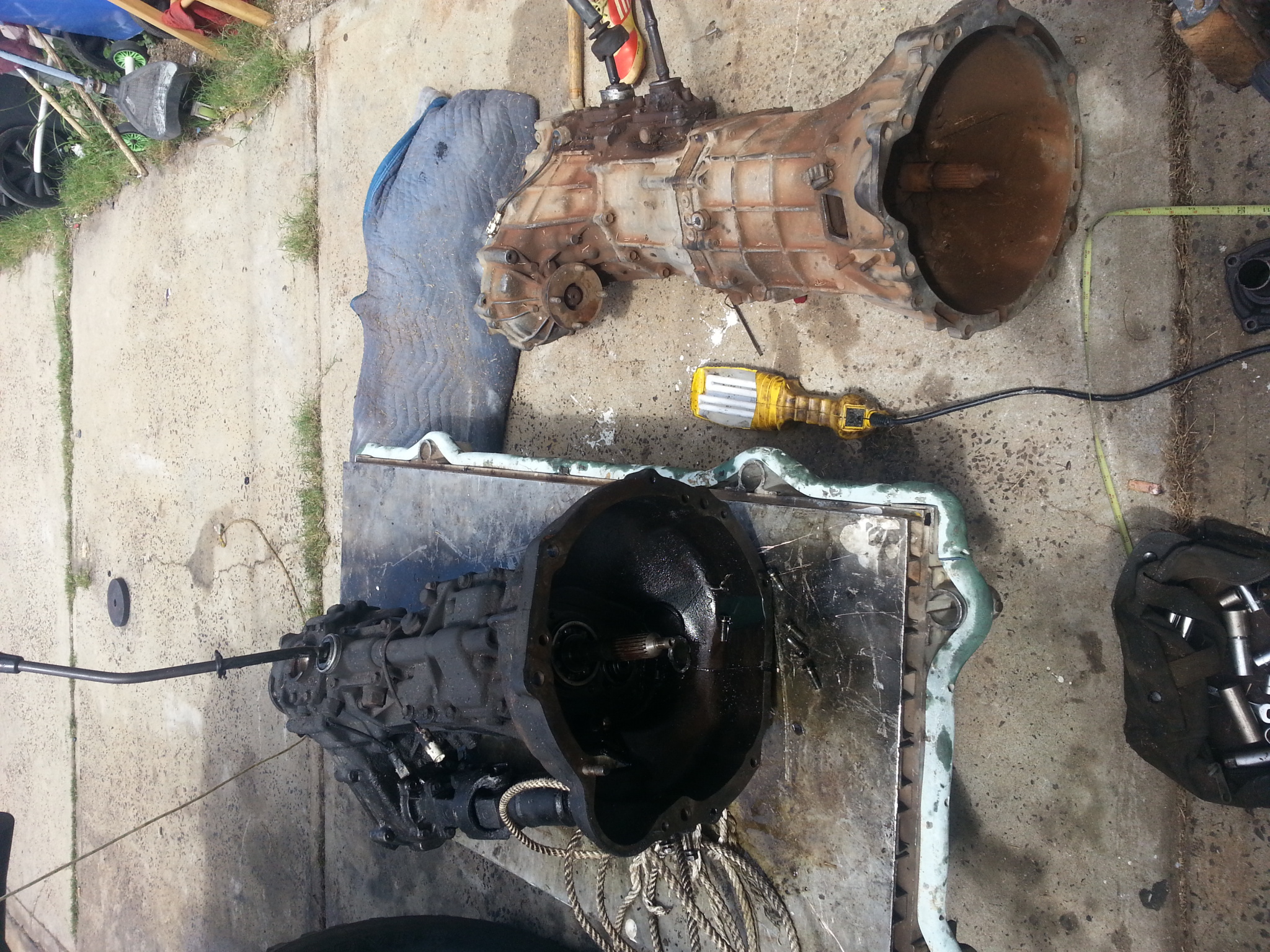

Thanks for the offer but the shipping would kill me. I'm on Oahu. Here's my head ache. I've got another trans but no luck. How can I I'd this trans?

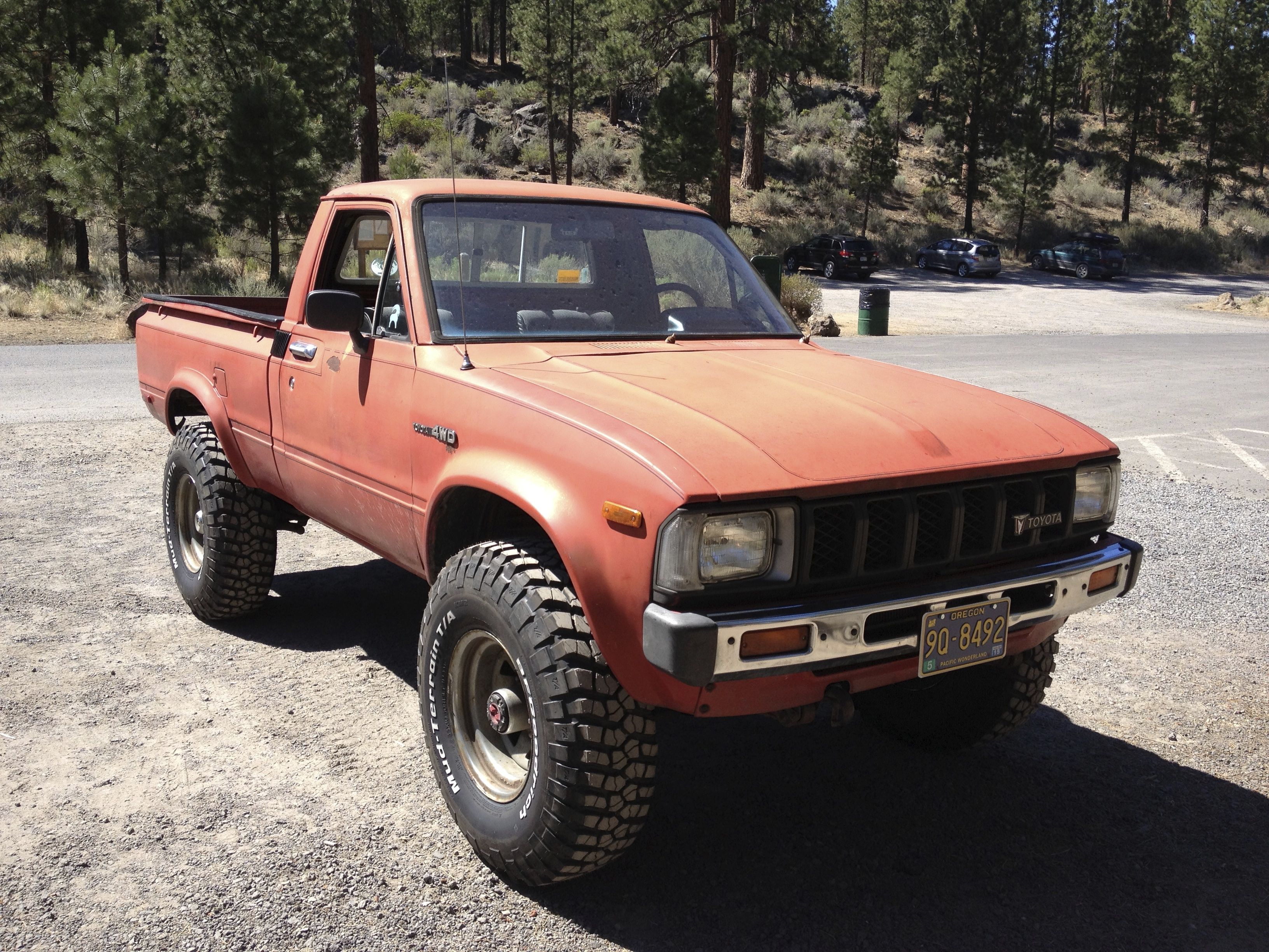

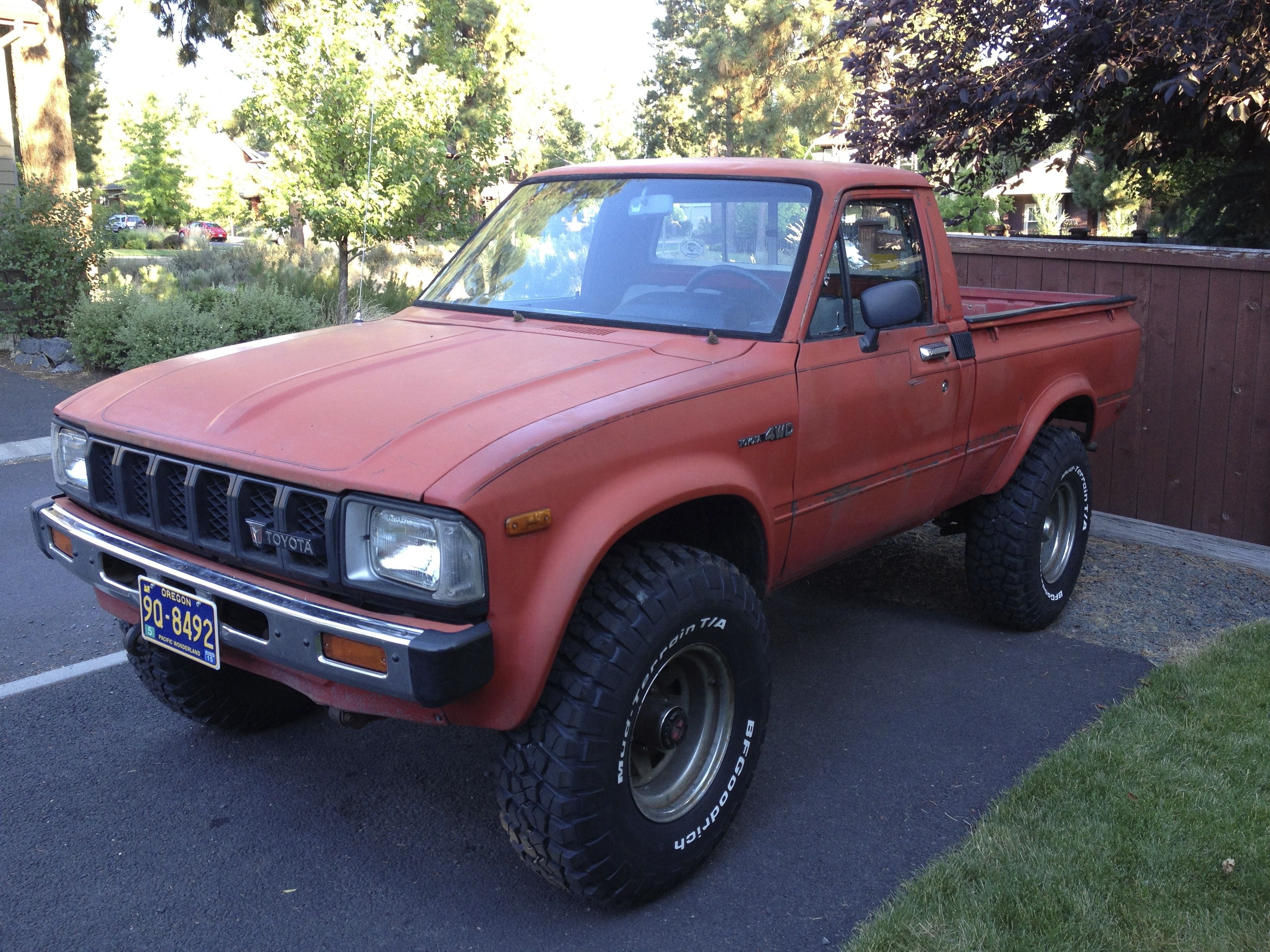

Just threw some 33x10.50 BFG Mud Terrains on my 83. No lift, just slight fender trimming.
Regearing to 4.88's soon, I hope.
go on marlin crawlers site ,look at the pics.

I'm on my way to go pick up a trans from a guy off of craigslist its a five speed 4x4 just lke mine that came off a 22r..any pointers or things I might over look b4 I buy it.and same with the install should it b straightforward any tips.thanks
Old Jul 30, 2013 | 02:43 PM
  #2393
cman1's Avatar
Joined: Jul 2010
Posts: 856
From: greenville,wi
make SURE they are the same length.http://www.marlincrawler.com/
Yea I'm an idiot.its to dam long . What a idiot. Well I got it up their new it looks asbif I need to fab the cross member and do something with the D/S ahhhhhhh. I'm screwed

anything but L-series transmissions (21'ish" long) all others require moving the t/c mount back 4" and lengthening front d/s, shorten rear d/s
edit: I just saw your picture, I think you have a chain drive t/c, check the number of bolts on the output cover.
