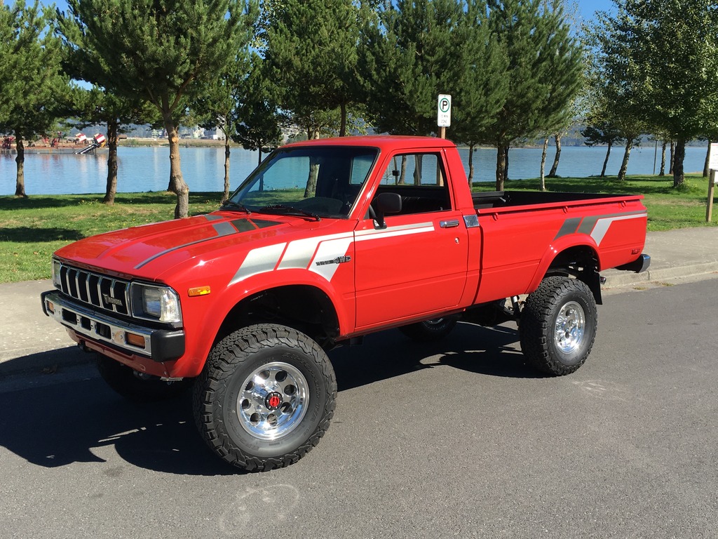

Nice truck, what's your end goal with it? Good daily driver, or barely road legal rock crawler? The 22r may seem sluggish as you still have stock gearing in the axles with the larger 31 inch tires. That combo really slows these trucks down. My advice over an engine swap would be 4:56 gears, then build the motor you have slightly with an RV cam, Weber carb, headers, offenhauser dual port intake, etc... You can do all of this for about $1200 if you do all the work yourself. I don't advise a motor swap or even a 22re swap if you don't have much experience. I swapped a diesel a few years ago into an FJ40 and this took all of the skills I had plus my large shop, and several thousands in unexpected costs during the swap. No offense, but if your asking how to wire a radio in, then a motor swap will be very frustrating for you and cost much more than you'll anticipate. The previous modification I recommended can be accomplished by most novices in they're back yard with basic tools, and will make a very noticeable difference in power.
What part of the PNW are you in? I'm down here in Oregon and currently building my 82, mostly stock tho. Here's my project for some motivation. My truck was in pretty bad shape when I bought it, worse than yours so anything's possible lol. Good luck, and I hope my advice is worth something to you.
