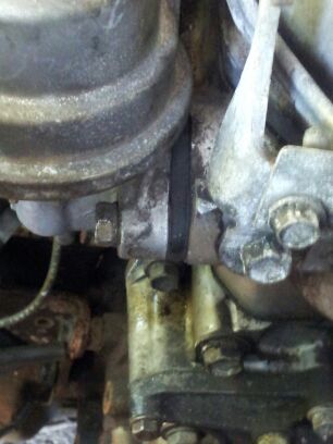

So, my 22R came with a mechanical one in the head. Is this the correct way to mount it, with the spacer? Or should I take the black spacer out?

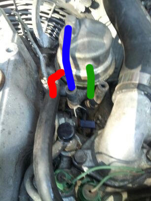

And now, I can't figure out what lines go where. I know the red line below goes to the carb, but what about the blue and green? which one comes from the tank?

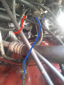

And these two fuel lines below the intake manifold come off the blue and green lines from the pump and picture above.

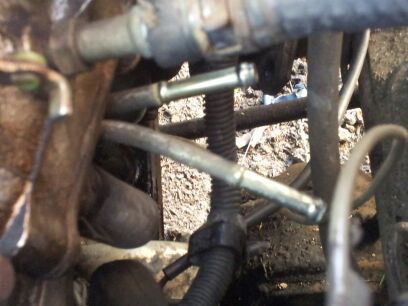

But, it makes be feel okay to put this in here.

Absolutely use the spacer.
As far as which hose goes where...I don't remember without my truck in front of me...

I believe the blue one is the line to the carb. Usually "Out" is stamped near it.
second-highest should be return, and the lowest should be the inlet.

The line farthest to the left is inlet and the middle is outlet.

The red line is the inlet line coming from the tank and blue is outlet line going to the tank.

Thank you thank you thank you!
RUNS on its own now!
