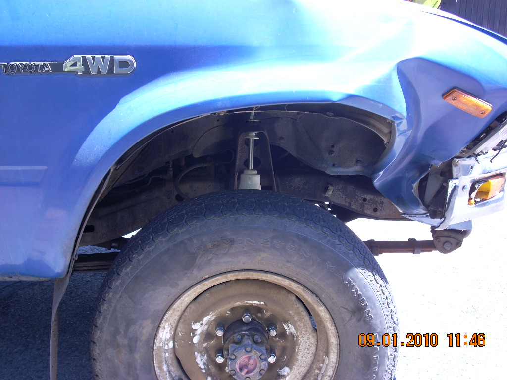

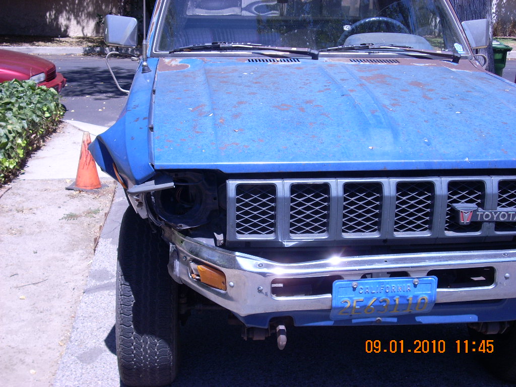

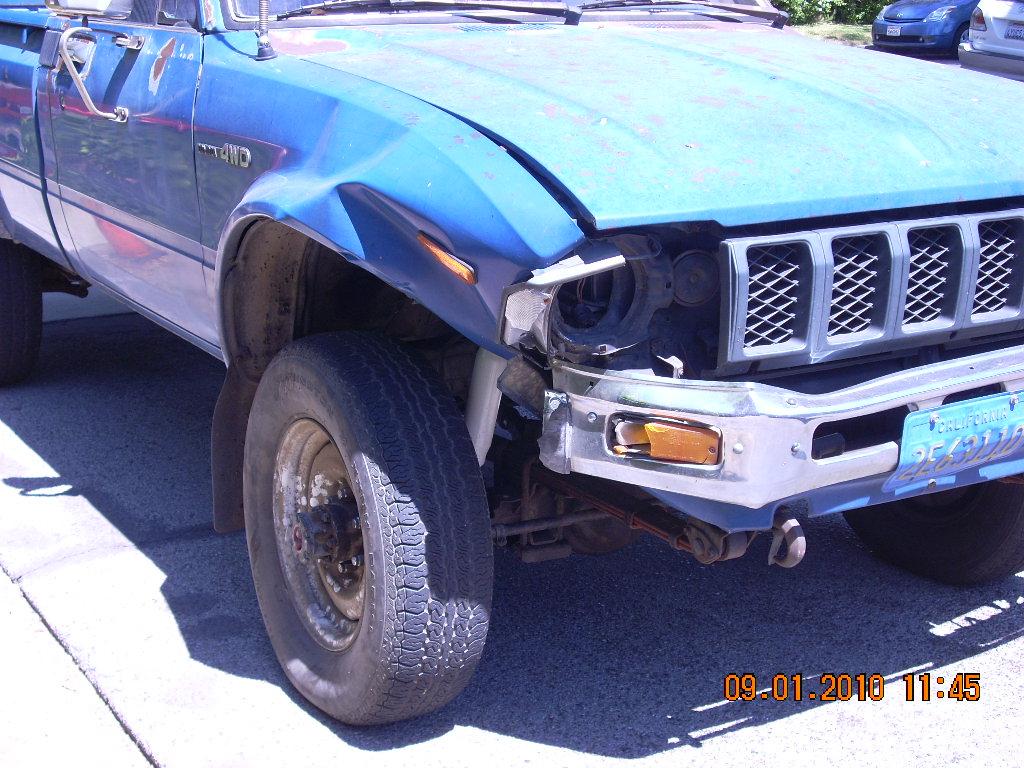

Attached Thumbnails DIY Straightening Frame, any ideas?-crash-8-30-10-2-008.jpg   DIY Straightening Frame, any ideas?-crash-8-30-10-2-009.jpg   DIY Straightening Frame, any ideas?-crash-8-30-10-2-010.jpg
