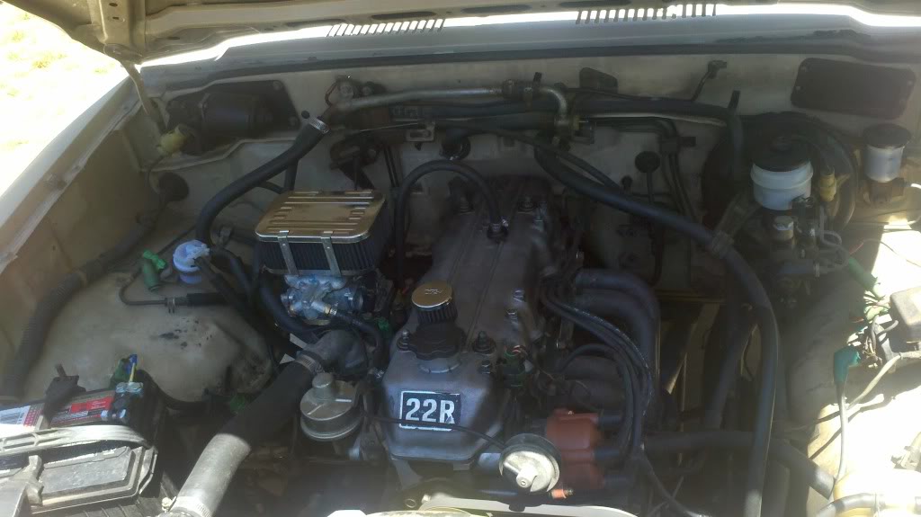

Desmoged! headman header w 32/36 weber, soon to have an electric fan.

Is that your fuel filter on the pass side?
One other question, the hose directly in front of the filter, where do you have that going? I was just asking in a different thread what it was. I believe it is vent or return.
How do you like your setup?
Yes that my fuel filter.. (always keep a spare!) that hose by it goes to my charcoal canaster for the fuel tank vent..
I really like this setup, easy to tune, no junk in the way and i get about 28-32 mpg driving 89 miles a day doing 70-80 mph. i have straight pipe (2 1/2) to a 40 series flowmaster than a 21/2 to the stock exit place.. all manderal bent tube. Sounds really nice.

You get 28-32 mpg? Never heard of this with a 22r.

5 gallons of 91 gets me about 130 140 miles...

Ok.... A couple questions for you. When installing the weber, did you plug the fuel return? Also did you leave the charcoal canister in place? Just looking for info on these two things. It appears that you have all egr stuff removed completely and blocked off.

the return line goes from the fuel pump to the tank... dident mess with it.. yes the canister is still there and hooked up,i put a 2 stroke fuel filter on the one vacume line openeings to close it up. i got the egr block off kit from lcengineering.

I'll have to play around with the return and the canister. On the weber install directions it stated to plug the return and I can't recall on the canister, but I know mine isn't in there. I've been working on getting it to run the best it can and efficiently as well and those were my next stops, so it all kinda worked out.

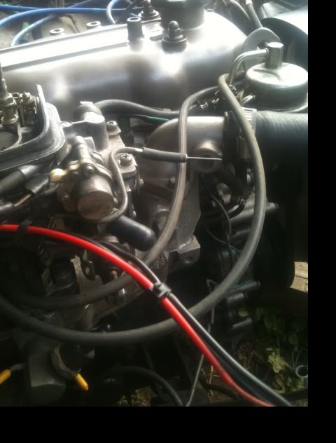

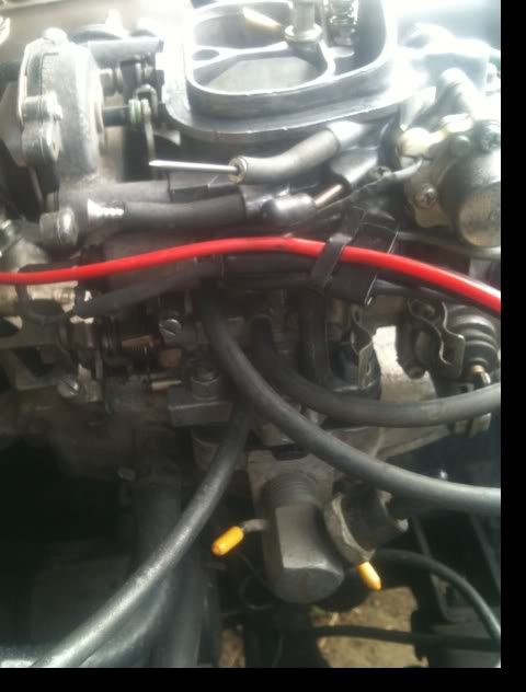

I am de smogging a buddies stocker. I got it pretty much all done and plugged up but I cant get it to idle at 800 it will at 1200 but anything lower it will miss and sputter. If I punch it it will come down and die. It is also dieseling and I ran the white wire to the ground from the fuel cutoff solenoid. So I am not sure if I missed something or plugged something I shouldn't have
Please help.

Lookin good so far! Here's what I would try:
It does sound like a fuel cutoff solenoid issue, I have had that problem myself. Lets ensure that is working before troubleshooting further.
There are two wires to the fuel cutoff solenoid, the colors vary by year. Mine are white and black, some peoples are red and white. The thing about solenoid operation is that in most cases you only need voltage across the contacts to get the thing to operate. In the stock harness, on the fuel cutoff solenoid, white was usually ground/battery return. It doesn't particularly matter which lead you use for which purpose in most cases.
If you have a multimeter (from your previous posts on this site, I'll bet you do), you should verify that neither contact (black or white wire) is grounding out first before proceeding. Put the multimeter to tone or ohms, put one probe on the battery negative/ground, and make sure that you get 0 ohms(no continuity) on both wires with the other probe.
Next step is to check for solenoid operation. Use alligator clips or scrap wire to jump battery voltage from 12v positive to one wire, and return/ground out the other. You should hear the solenoid click when you complete the circuit. I you don't hear the click, you probably have a bad solenoid.
If the solenoid operats, and you want to bypass a bunch of bad factory wiring, you can finish out your install/desmog by wiring a new run of power to an ignition hot lead on your fusebox, and one run to battery return. This solenoid was computer actuated when your smog computer used to operate, moving forward, you just want it to be open when the ignition is on.
Let me know if you need more help, and post results!
