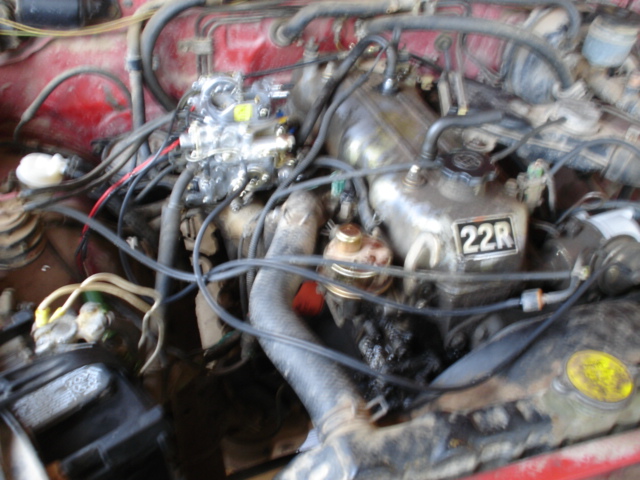

Hey Guys I am right in the middle of the desmog and now I am running the vacume. I need a bit of help to get to the finish.
Here is a over all shot( sorry its a bit blurry)

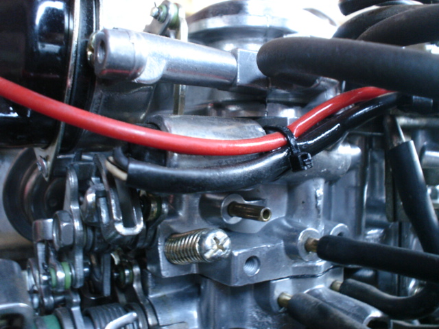

I will use 1 and 2 for the dissy advance just like the op did.
In this pic the line my hand is on is running to the number 1 below that the line goes to the fuel return vent.

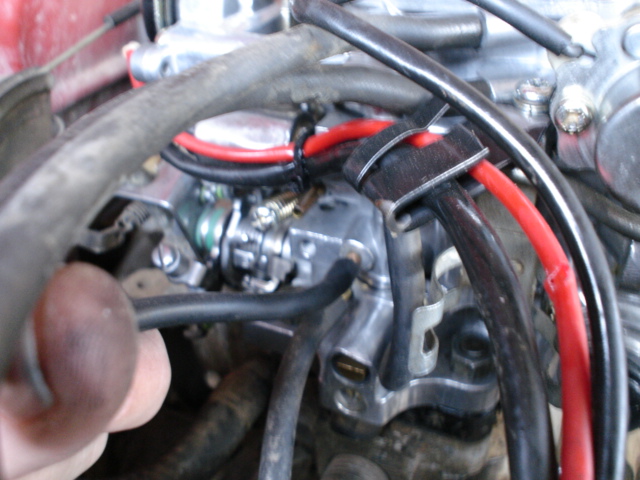

Here is another look
The uncaped line I have caped when running. The J shaped line I have running to number 2 on the dissy.
Right now she fires right up, but idles crappy and sending some bluish smoke out the pipe.
She did idle better before the d smog.
Thanks guys!!

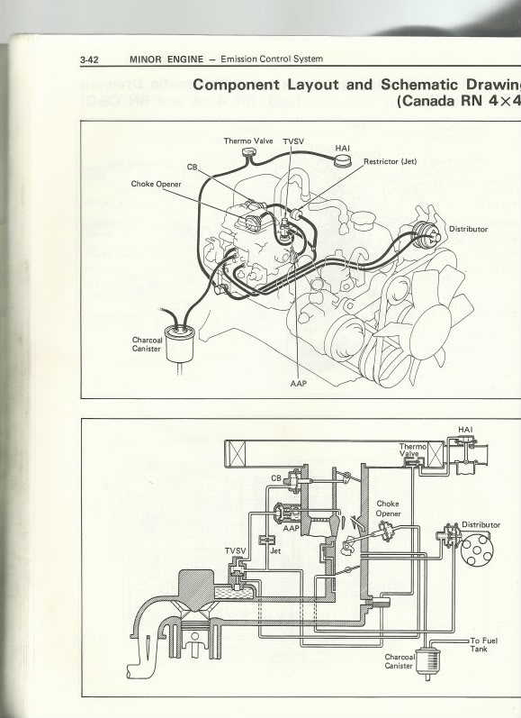

I found a digram off of a 81 canada model,
Will try this!
If this does not work I need to try vacuume advance.
Old Nov 5, 2012 | 02:55 PM

Once I get to that point in my rebuild, that was the diagram I was going to use for my vacuum hookup. I've also desmoged my 22R

toastyjosh - Did you get it figured out? That canada model diagram should work well for you. If you still have idle issues afterwards, make sure that EVERYTHING with a vacuum port is capped securely except for the lines shown in that diagram.
When I first did mine, I had 2 issues: one of those hard lines that wraps around to the dizzy had a hairline crack, and one of the brand new vacuum caps I had put on rotted out within a week. That has never happened to me before, or since.
I got a brand new package of vacuum caps, and 20' of vacuum line (about 30 cents per foot), and ran it from scratch to test. It purred along just fine.
