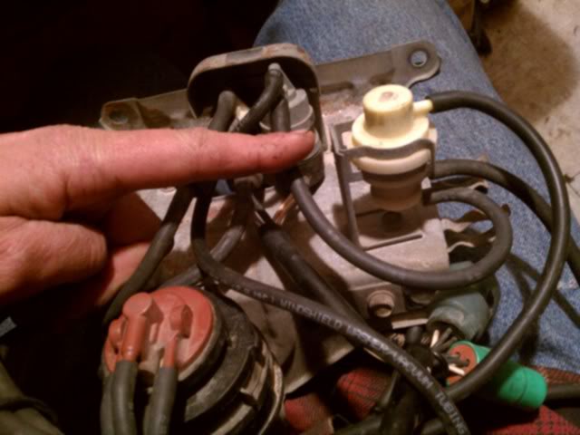

I need help. I just rebuilt my engine, and now have to smog it in California.
The vacuum mess is bad. I have an 82 PU (motorhome, actually).
I have (mostly) figured everything out, except for the high altitude spec circuit.
Here's a vacuum diagram, but it leaves out exactly where some of the items connect:
I managed to find an 82 Pu in a junk yard, and it is a CA model, but doesn't have the high altitude spec. It was manufactured February of 1981, and mine was manufactured August of 1981. Here is it's underhood vacuum diagram:
So, my main question is, on the VCV next to the HAC (In the top diagram, upper left hand corner) where does the middle line (It's mark S,X,Y, the middle line I need to know where it goes, is marked "X") go?
In this picture I am pointing to the VCV. Please, can anyone help me?

My advice is to skip the hac until it is smogged. Why add potential complications? Go base minimum until it passes, then get fancy.
The diagram for federal smog is in this forum earlier, use that as your baseline. Cap off anything that is unused. See how close you do on a precheck at that point.
That seems like sound advice. Should I remove the brackets and the HAC/ VCV valves? If I don't, what's to stop them from failing the visual?
According to the blue diagram I got from the truck in the junkyard today, I have everything hooked up right. Right now only the HAC system is in question.

The HAC is not a California requirement, what they will be looking for in the visual will be EGR, and possibly reed valve. You can remove hac and bracket if you like, but I doubt it will matter.
