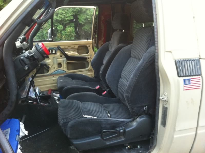

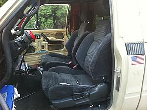

Buddy ran 90s Acura seats in his 83. I run them now.

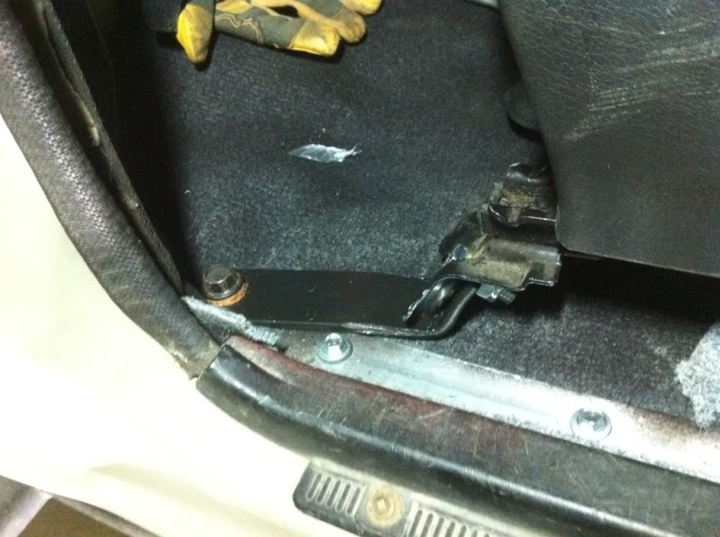

^^This. practically a direct bolt in, you will need to make a couple of brackets for the rear mounts- the outer front bracket is at the correct angle but offset by about 1.25" . I ran 95-96 Prelude (same as integra seats) seats in my Trekker, they are now mounted in my 94
sorry i don't have more pics but photobucket really screwed some of us long term users so i posted the two i had
Attached Thumbnails comfy replacement seats 1982 4WD-prelude-seats.jpg   comfy replacement seats 1982 4WD-prelude-back-bracket.jpg
