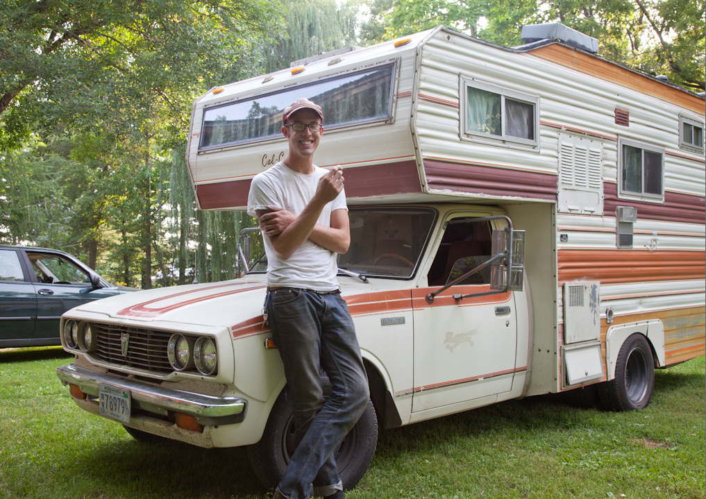

You're going to need to post photos of this rig...
Old Nov 22, 2013 | 12:00 PM
mrjack's Avatar
Joined: Nov 2013
Posts: 7
This is the only one I got....
Old Nov 22, 2013 | 01:04 PM
83's Avatar
83
Joined: May 2008
Posts: 4,591
Likes: 126
From: Montana
Nice! Bigger than mine.
Do you know how to tell if you have a true one-tone rear axle?
www.toyotamotorhomes.com is a great site.

Oh and Zach, somehow missed that last post. yes I got a one tone rear axle with duelies. I love this camper.... Hope to get her back on the road soon.
