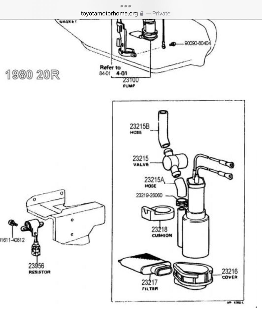

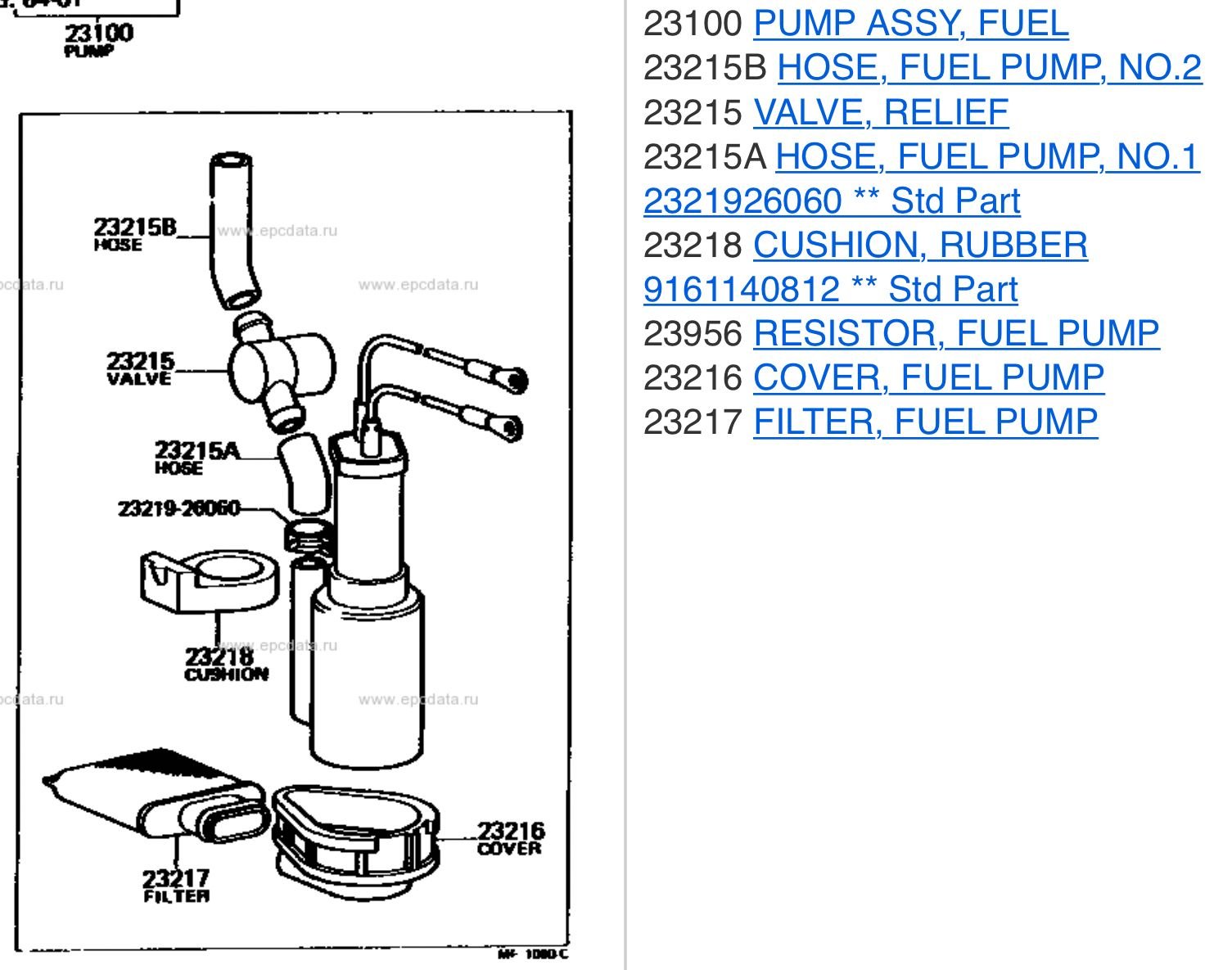

I'm trying to salvage this nasty fuel sender from my 1976 Chinook project. I've got everything cleaned up but I'm concerned about this thing above my fuel pump. Can anyone tell me what it is? Maybe a pressure regulator? I can blow straight through it, and with one side plugged no air comes out the side vent.

Maybe a check valve that keeps the fuel in the line from draining back into the tank?

Here you go…

I don' see how mine can be a check valve, I can look straight through it.

You’re correct, it’s a relief valve.
