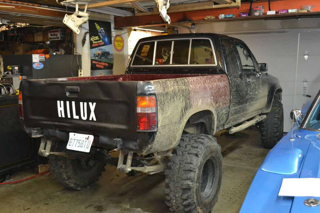

not a first gen truck but on my 3rd gen i did 10 inches and 63's. the frame sticks out a bit but i plan on have a custom bumper made to work with it
usually chevys move the rear spring mounts back 4inchs and foward 11ish... so if you dont want to have your springs stick out measure 5 inches or so back from your current location and and bob it from there.
