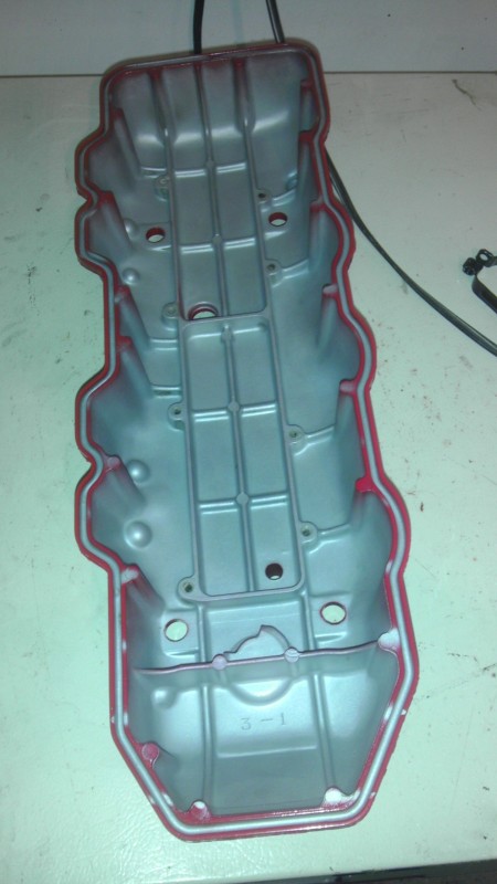

Pull the valve cover and make sure someone didn't remove the plate inside. The pcv "port" should not be visable on the inside of the valve cover withouut removing the plate.

Yea for sure should have the plate. I just took mine apart to powder coat it. Had to order the better gasket kit so I could have the inner plate gasket. Also I figure replace the valve while I'm.in there

Well when I first purchased the truck I did not have this problem. Could this plate have came off on its own ?

This is what it looks like without it
This is the plate you should have
You can see how it lines up

Thank for the visual. Appreciate it. I'll pull it this weekend.
