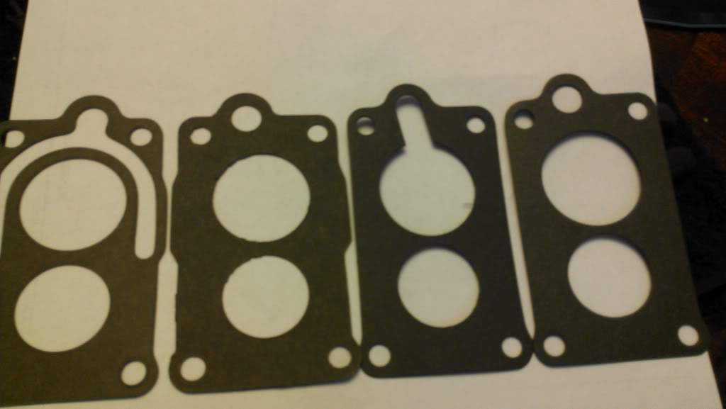

Ok this may be a stupid question but which gaskets do I use for the manifold to spacer and spacer to carb?

i figured out the gaskets. The one on the far left goes between the intake and the spacer. Second from the left goes between the carb and spacer.
