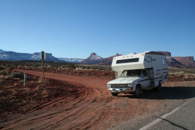

I have a 82 Odyssey RV- which is basically an 82 PU with a 1 ton axle. I recently damaged the engine to the point of a full rebuild. I am cheap and lazy, and the RV is so old and rarely used (but still loved), that I don't want to rebuild. I have a used engine available with around 180k that was in a rollover but is undamaged. But I don't have any other history. But if I drive 20,000k in the next ten years in the RV, I'll be surprised. I am not a total newbie, but I have never done anything more inside an engine than minor valve adjustment. But I can follow directions and have rebuilt the carb, rear axle, and brakes, in addition to swapping out the alternator, starter, and other parts and putting in a new wiring harness. I have also replaced the timing belt, steering gear, rear dif, starter, alt, and ball joints on my 91 (3.0) just to give an idea of my experience.

Front seal. Oil pan gasket. If you're going to do the oil pump might as well do the water pump.
Nice RV!
