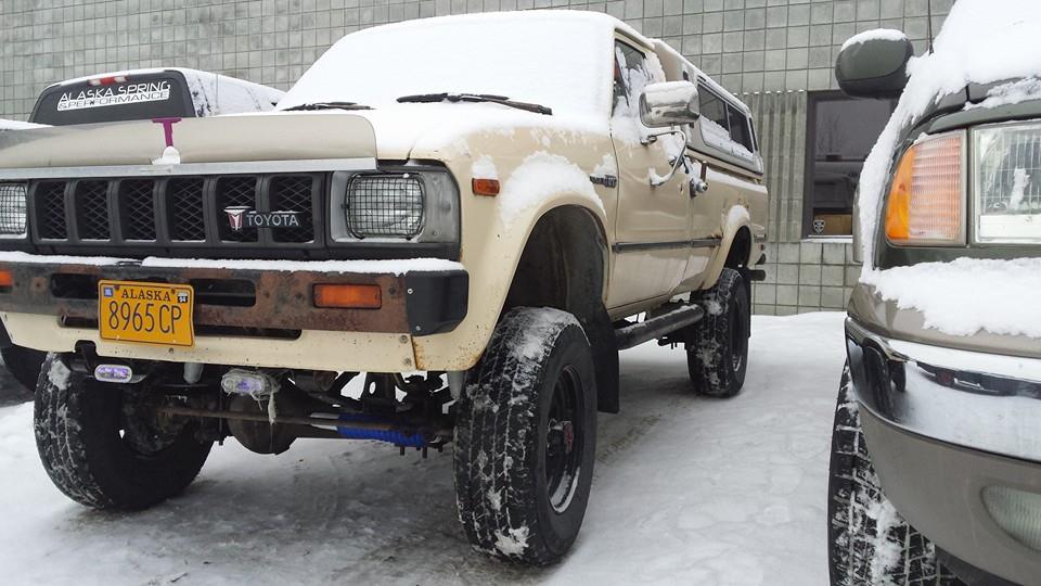

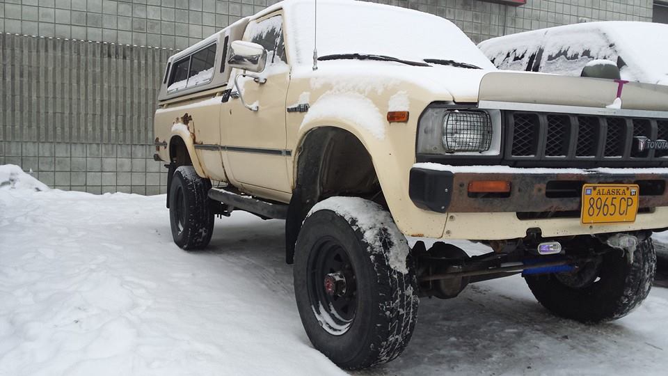

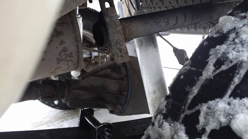

4in pro comp suspension lift kit from summit racing. Replaced the rear leafs, rebuilt front axle ill have pics from the front axle ring and pinion replacement. installed rear Spartan auto locker. Think I want to put 35s but I don't know how itll run em.

Looks like you have a little exhaust leak there after your muffler LOL
You might want to address that rear pinion angle, looks like it could be a bit unhealthy to me.

Pinion angle looks okay, maybe the driveshaft isn't connected to the transfer case?

That pinion is pointed up pretty far and the transfer output does not point down at that much of an angle - the pinion and the transfer output should be parallel to each other

35's will rub. Go 33x12.50
