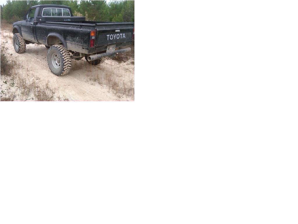

Alright... here we go!!! Hopefully this attachment will work! 1983' SR5 - Spent the last 6 years at my hunting camp... You cant imagine what she's been up, over and through! Lost our land (The Nature Conservancy Bought It & Kicked Us Off) - 33" x 12.50" x 15" Super Lift Suspension Lift - Newly Rebuilt R22 & L52 Tranny!

damn hippies! hope you got a good price for it... nice truck man, looking forward to seeing this thing cleaned up.

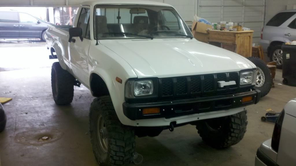

Im not sure I like the white emblem on the front grill... may have to repaint it flat black.

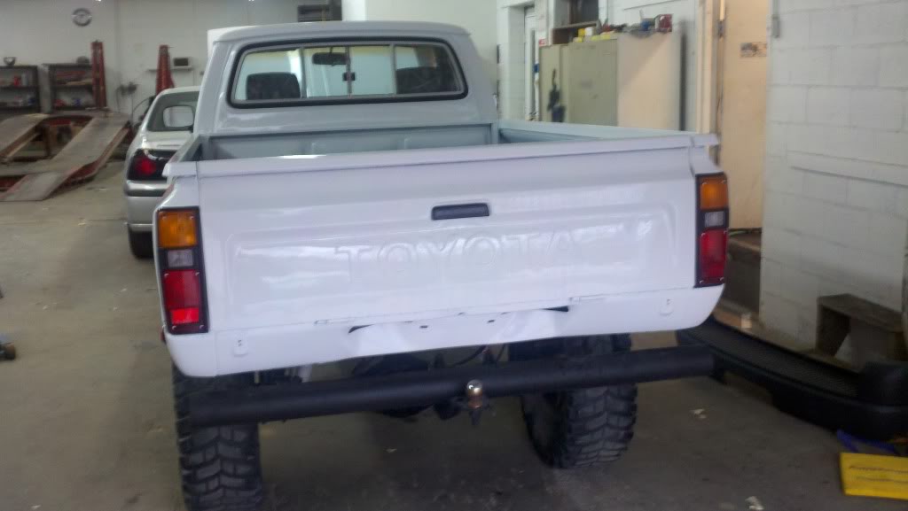

FIberglass Tailgate Photo
Unbelievable! This tailgate has perfect fitment! If I didnt tell you... you'd never know it was fiberglass.
If anyone needs a toyota body part - Bed or tailgate... call CJ @ www.toyotafiberglass.com!

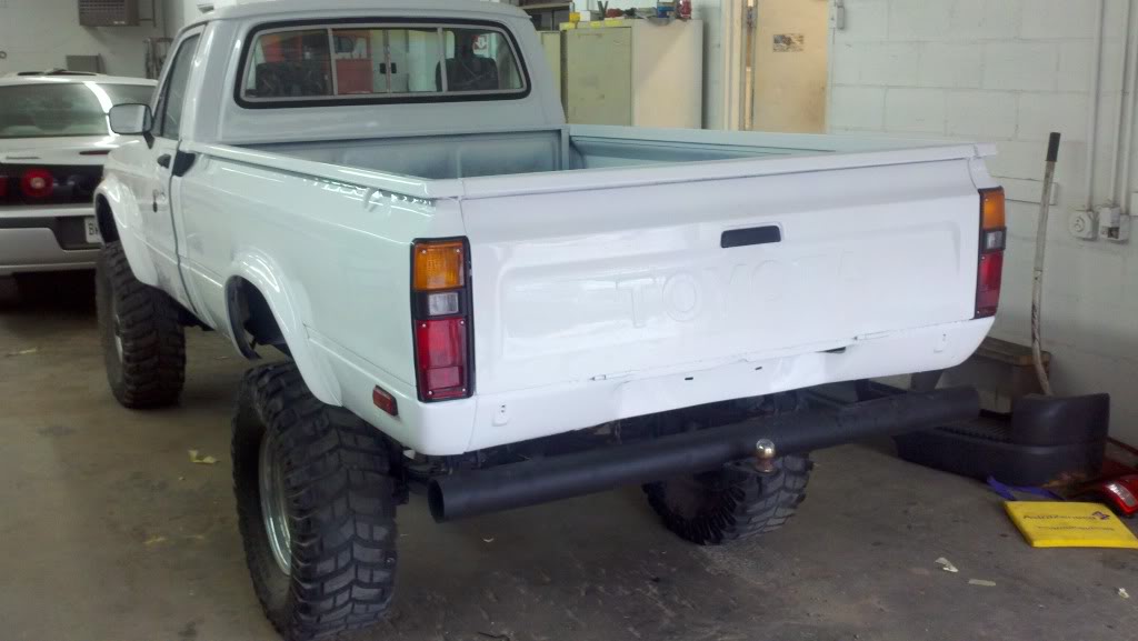

Rear Side View
I should have her finished up with the new wheels and tires.... detailed and ready for the road next week!
Whata truck! I'll bet it will creat some inquiries at the gas pump!
It was so much work... I need to get special insurance... parts are scarce on these things!

Thats cool Blake .. great work and nice truck !! and thank you for the "props"
hope you done mind if I "swipe" a picture for my web site do you ?
P/S .. I dont like the emblem either .. maybe do this

Emblem
Dang Corey... that Emblem looks awesome... how did you do that man? I would consider sending this to someone and paying them to make it look like that!

thanks .. so can I use/have a pic ?
doing the emblem is super easy, just takes a little time .. just tape off the chrome (painters tape works best) cut the edges of the tape with a sharp razor blade/knife . scuff up the rest with a scotch brite pad , and paint black . Then remove the tape , and with a very fine brush , hand paint the red

Sure.... go right ahead... a photo of the gate for your website.... a photo doesn't do it justice though! The thing is flawless!
My gate has some play in it when its latched... I gotta adjust something... I will get her figured out! Its a hardware issue... not the gate itself! (I supplied the hardware!)
As for buying a fiberglass bed.... $2500 is nothing for a truck like this if you needed one! The #1 problem with these 1st gen trucks are rusty beds and tailgates... nobody has replacements other than Corey at www.toyotafiberglass.com. Without a bed... you have a crawler in the making! If you want to own a true classic truck... that will be worth something later... a bed is an investment in "what you have" not "what you can sell it for!"
the majority of the emblem looks good but maybe it is just the lighting, but the chrome portion still looks pitted
yes it is .. I didnt have it rechromed .. just painted it (as mention above, taped off) .. chrome still has rock pits from 30 years of service , I tried some autosol , and other polishes , and got it the best I could . I would have no idea how to "buff" this out with out ruening the emblem .. you ?

I took my factory emblem and wiped it down with acetone and made it all chrome... I always have done this to any thing that is plastic with painted over chrome...I took my F150 grill and wiped off all the black paint and it was amazing the coments I got ( wow the new grill is awsome, hey when did you get the new grill, ect.) I never told them any diferent....just my $0.02

very nice , and corey yeah i see what you mean but 2500$ is alot of cash for a 17 yr old, just gonna hope to find a bed to fit and corey have you ever tried "never dull" worked wonders on my chrome, its like a cotton fiber that you pull of a can and apply, idk where to get it anymore

are those the hella head lights or the ebay knockoffs I thought about picking up the ebay ones but I dont know how well they work.
