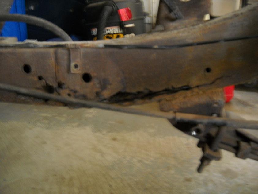

Well guys the day has finally come for me to address my rusty frame issue, I noticed that the top of the bed was rubbing the back of the cab. I have a really thick bed liner and its been holding my bed together for 2 years now, but it was really rusting away underneath, after removing the bed and jacking it up the frame started to twist, I was able to use two jacks and get it up at the same time and now its resting solid (somewhat) I started removing the bed mounts and made templates to have cut so I can box it in, might put some C channel in to make sure the front stays straight, going to have to remove my front leaf spring mount to box in the frame then weld it back, anyone know if I can just buy a new generic mount? I've not fabbed much before. It's a work in progress.
ouch, that is some serious rust but not the worst i have seen on this forum...as far as mounts, you will more than likely need to make some as I am not aware of any any premade mounts, even NOS.

Thanks, I know its bad, but I just hate to put it out to pasture, other than the frame and the bed, the rest is in great shape and it only has 130K miles, although it sat for a period of time and I think that killed the frame. I was looking on the sponsors page and wabfab has hangers for when you put on bigger springs and need to relocate the front hanger, $30 for a pair so I'm going to order a set. The worst part so far has been removing the 27 year old shackles. I swear the bushings and pins have become one! I have 3 of the 4 out, one is left and has been soaking in everything from PB blaster, liquid wrench and kerosene. They are toast and not reusable so I will order a new set as well. I'm not sure my budget will let me put a flat bed on it as soon as I would like, but that gives me time to plan it out. I just need it to be drivable as quick as possible. I dropped of the templates I made with a local fabricator and should have them back by Friday they will cut them out and I can weld them back in. I cleaned up the passenger side today, but after spending 2 hours on the shackles I didn't get the front hangers cut off like I wanted. Seems like there is never enough time or cool air.

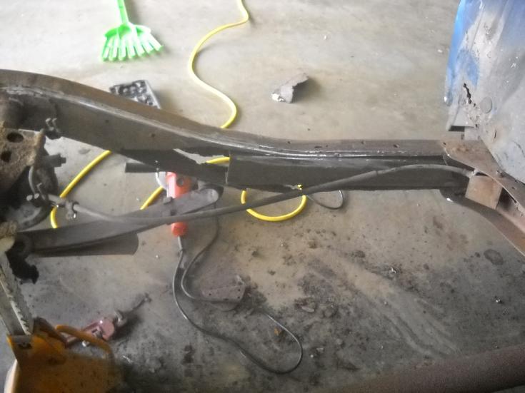

Ok, thanks for letting me rant, I have already removed all the bed mounts in the front and ground off the front hangers for the front of the leaf springs, I also removed what was left of the rear cross member that the spare tire winch was attached to, I removed the winch and have cleaned it up and plan on reusing it, I had some 3" c-channel cut to fit so that I can place them facing each other and then weld a plate over top to mount the winch to. I had a circle cut out of one of the channels to allow access to the winch, that has provided a lot more stability to the rear section already!
I've mainly been working on the drives side for now, I removed some of the inner metal to allow access inside the frame and welded in a piece of c-channel, it supports the frame area under the cab mount is and also right under where the leaf spring hanger will be, not sure if it was needed, but I had it and thought it would give me more piece of mind when going down the road.
Next, I welded on the outside template and top strap, I'm currently cleaning up the inside template metal, I had them cut with a little wiggle room, just to make sure, with a little work they will be ready to weld up tomorrow, I might take a day from work to get ahead some, I hate only having one truck on the road right now, getting up early to drop of the wife and then drive to work is getting old fast.

I know "no pics, it didn't happen" but I finished up, boxed the frame in with 3/16" steel, moved the front leaf spring hanger. used the stock lights for now. just turned them and mounted them with cheap angle brackets. Painted it with "Miracle Paint" like POR 15 has a really hard finish, but you gotta use gloves. Pics to follow when I get a chance.
