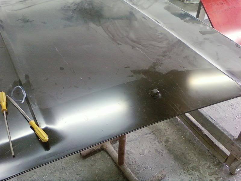

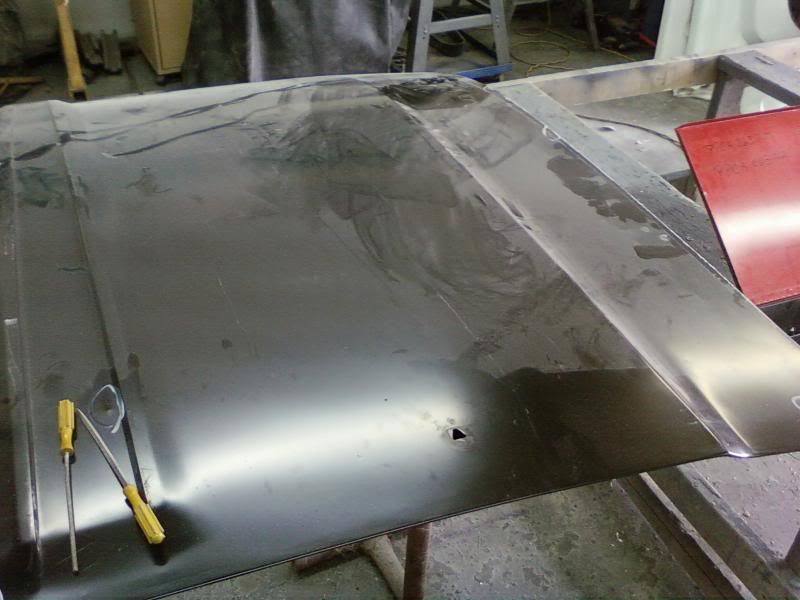

I smoothed my cowl , so I moved the squirters . I used second gen squirters on mine ..
these are easily adjustable . The ball inside the plastic rotates , you can move with just a pin

Couldnt we do roughly the same thing Slacker did with a drill and a dremel to get a universal nozzle onto the hood?
this idea is more attractive to me because then I wouldnt have to reach into the cowl ever again. But my truck is a rust bunny so i dont mind drilling and cutting up the body.
Old Sep 5, 2020 | 06:51 AM
Lons81's Avatar
Joined: Jan 2012
Posts: 711
Likes: 70
From: Stepheville, TX
It doesn’t take much, just measure to keep it about centered on the blade and drill the required size hole for the nozzle. Run the sprayer hoses. Take Slackers pic for reference. A must if you smooth the cowl
