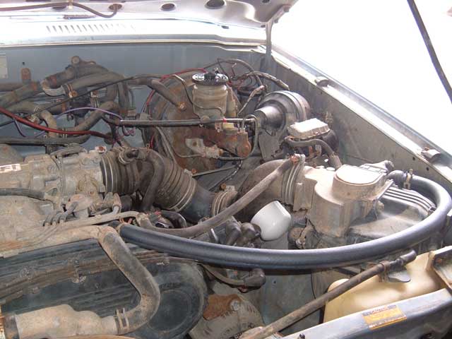

Mine was the cheapest $3! $1 for the pipe cap, and $2 for the hose!
It's more of a "ISB" (intake silencer BYPASS) but it works good!

I can see why you couldn't drill the holes to the proper size and use PCV grommets and the plastic PCV fittings for the hook ups. They seal air tight!! Just a thought!!
