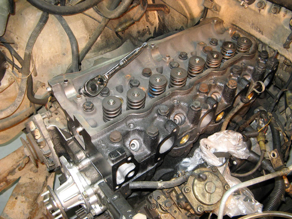

still working on mine (non-turbo)
The cylinders looked great, so just the head...
All new valves, full gasket kit, and going back together. Here is the head, back in place. Head bolt threads chased, head surface cleaned.

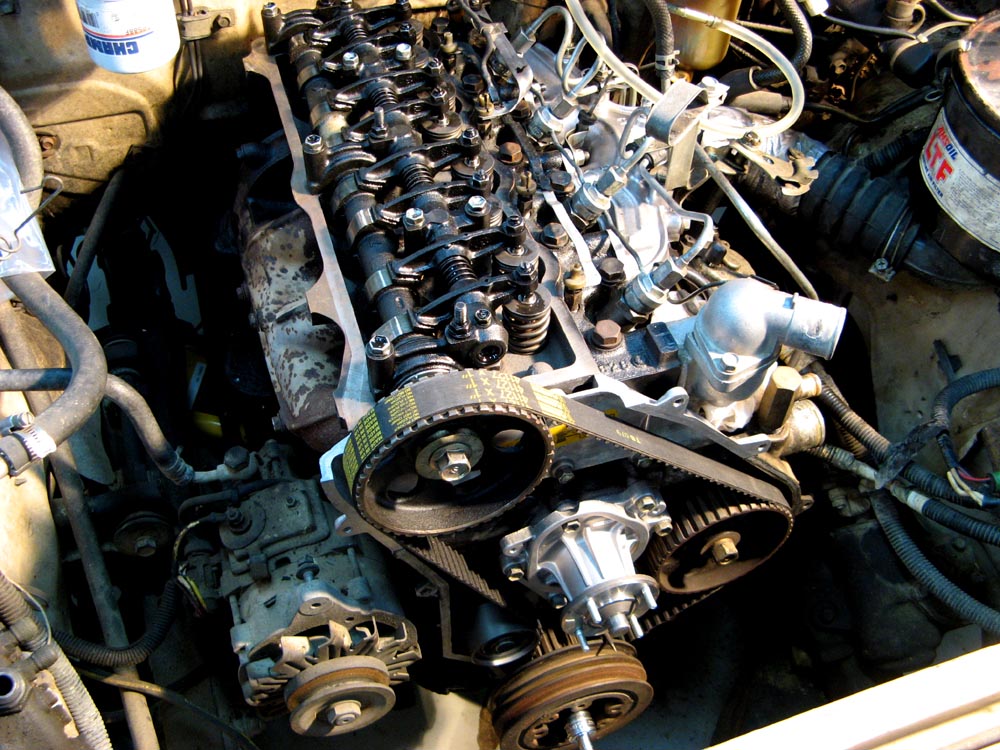

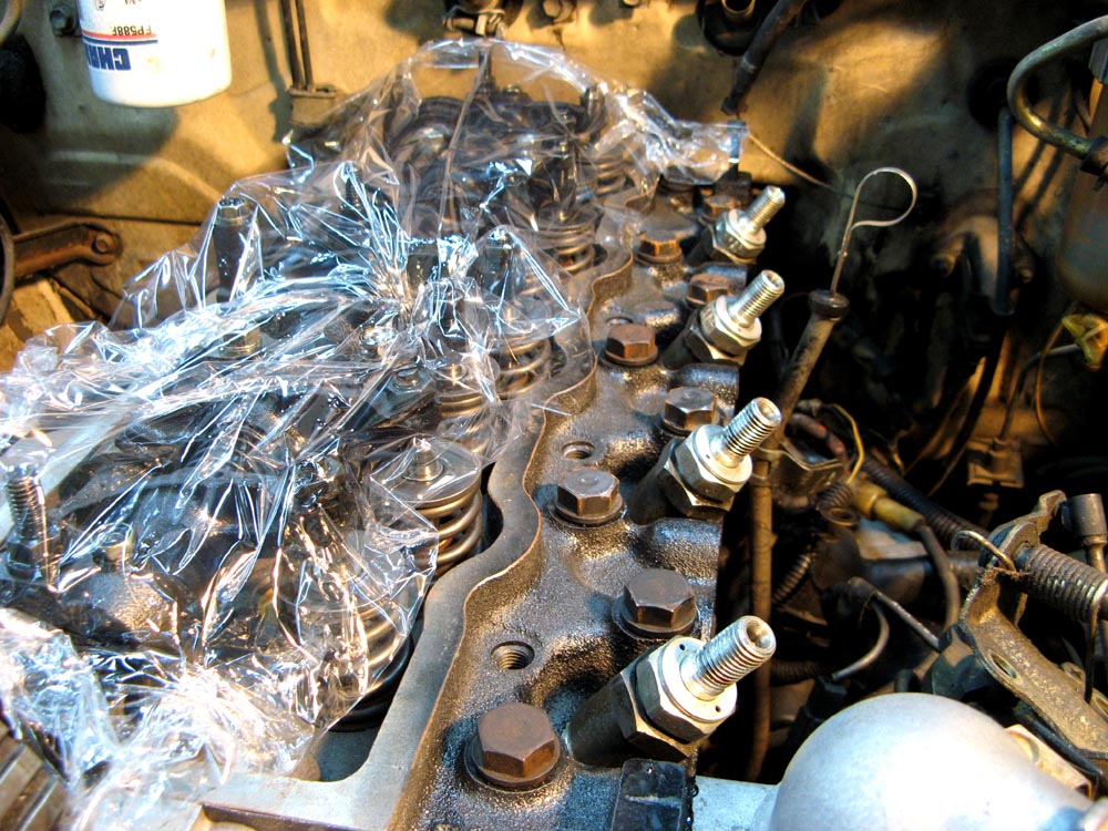

So I disassembled the injectors. They just needed cleaning. Here they are, back in (lubed with diesel!!).

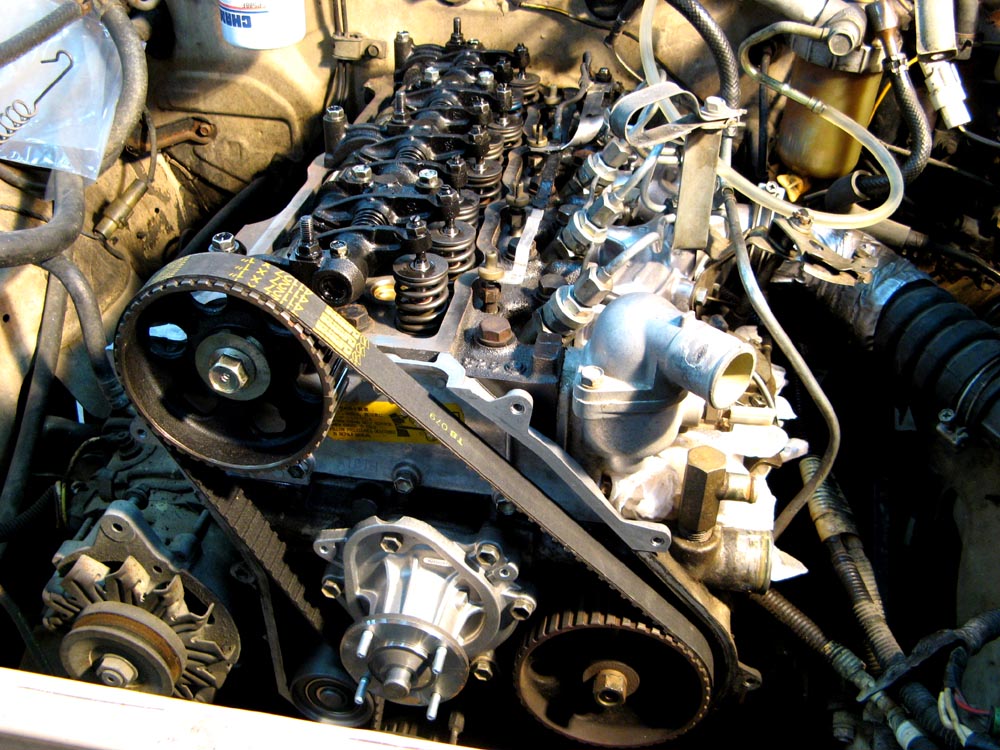

So I cleaned the piss out of the injector fuel supply tubes, the intake manifold, the glow plug harness (plate steel!), and assembled the complete intake system. Then connected a hanging fuel tank over the engine, and primed the system. The priming pump is EASY to use, and worked great. Fuel came out the return outlet on the injector supply line, I reconnected it to the fuel pump return and then installed the exhaust manifold. The crank is hard to turn even slowly (it wheezed! compression!...see the ratchet on the crank?), and you can see the tube connecting the alternative fuel supply for priming, and I'll leave it there for first start! Once it starts and runs, I'll restore the fuel tank connection. Can't wait.
New timing belt, water pump, timing belt tensioner too. Valve adjustment was a snap. All going smoothly. I think the priming will make this an instant start. I just need more time to work on it!!!
