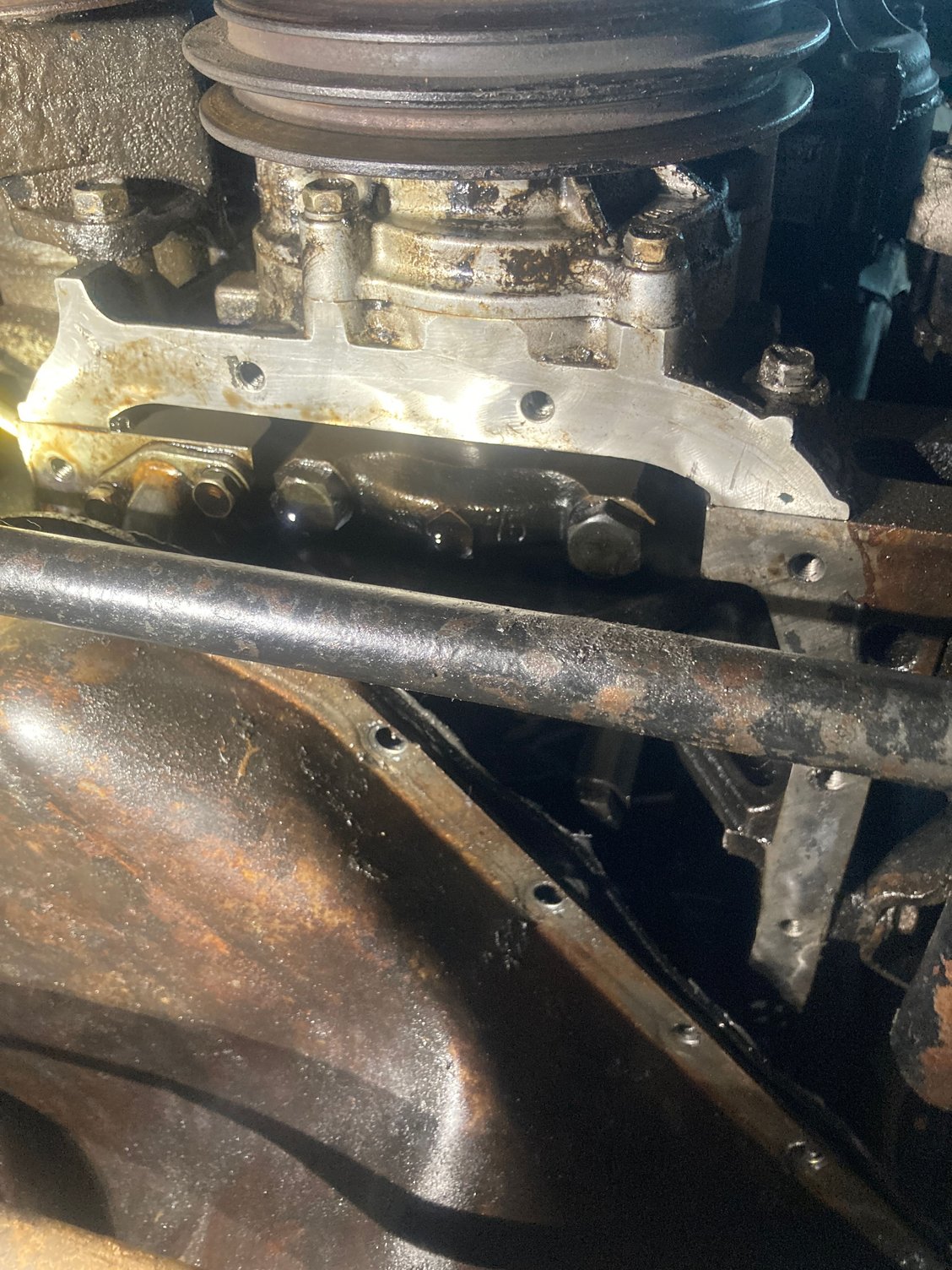

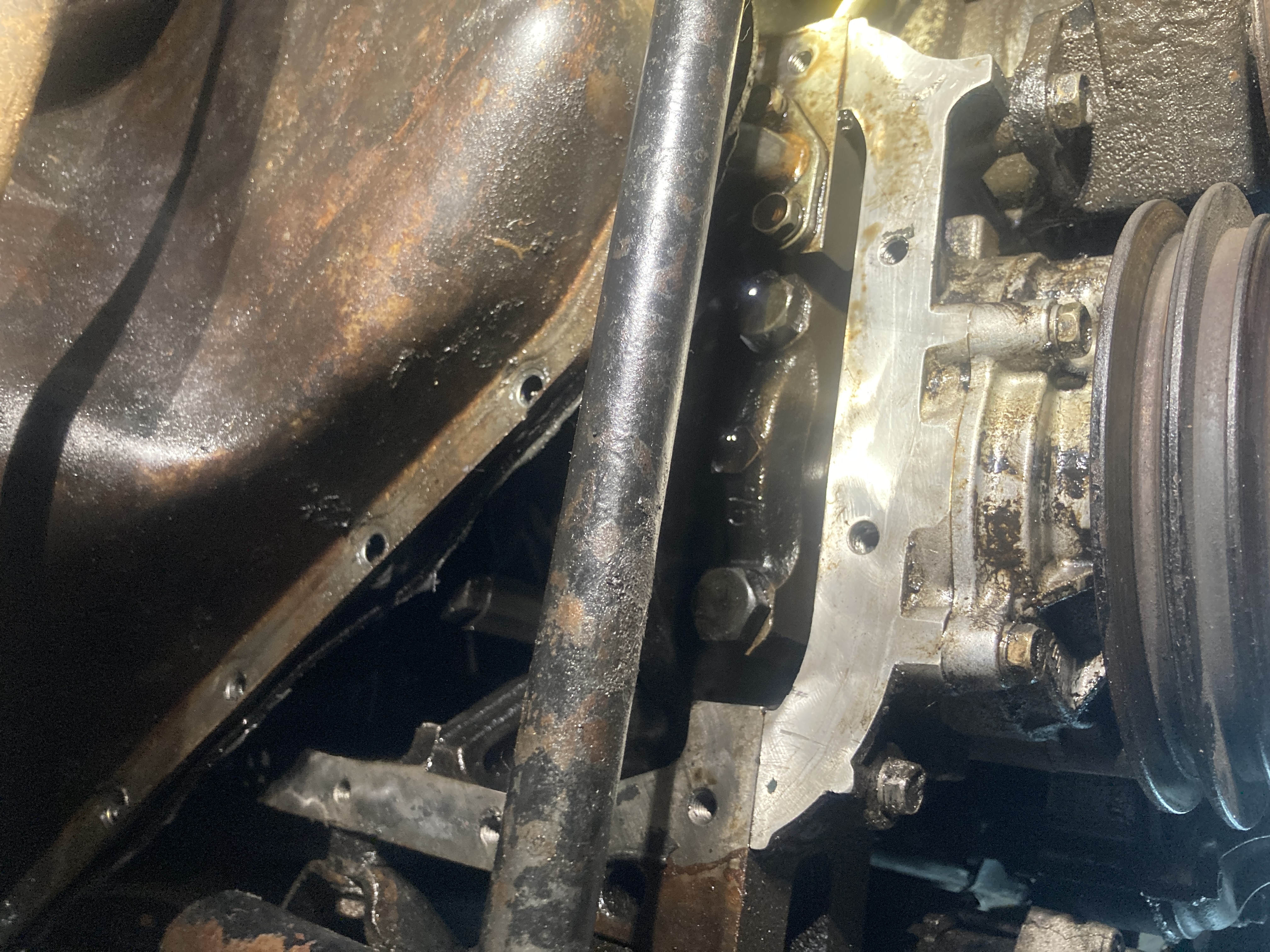

Jammed up hard against front axle
No matter which way I twist/turn/tilt it will not come out from under the engine. It’s undone and off - but just resting on the axle trapped twixt mounting brackets.
Im just stoopid. I just jacked up the front - using my winch mount - thus increasing the gap twixt axle and engine! Duh! BUT it was parsing out on this thread that gave me the inspiration! Thanks for being here, a great sounding board and thinking space! 😎

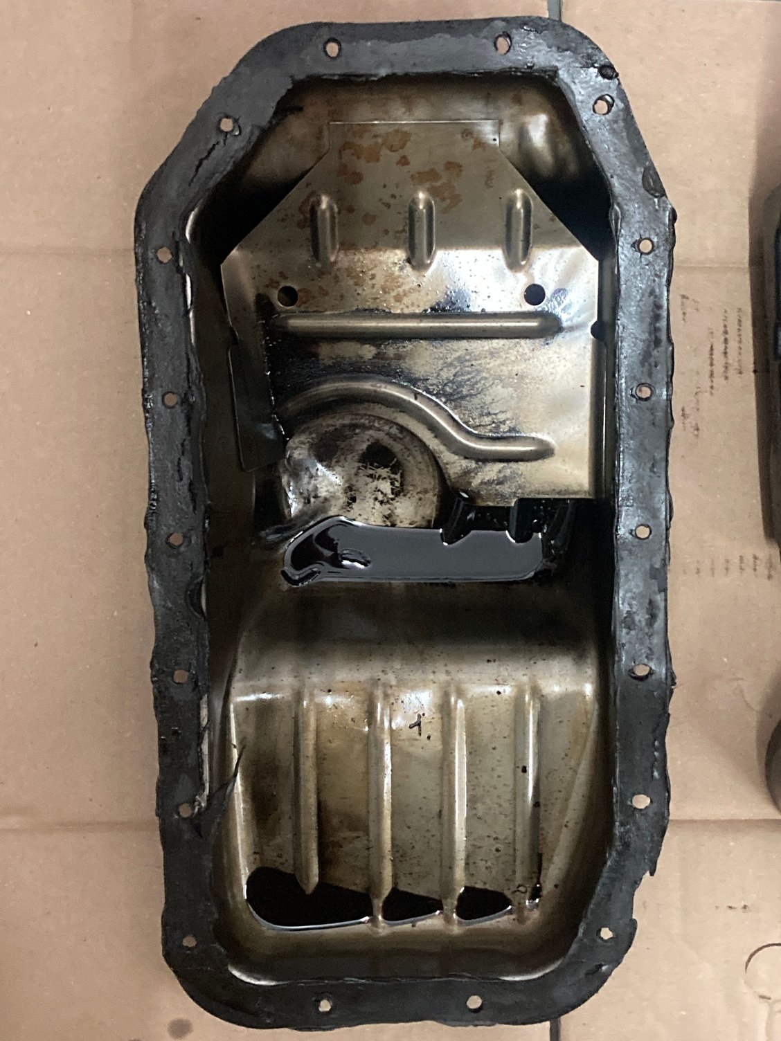

Weird oil pan gasket?
Having retrieved the oil pan I can now see the gasket. And it seems to be a 1/8” thick by 1” wide rubber gasket. The pan has a ridge, and and FIPG was used on the pan surface only. The oil pan has never leaked. Obvs this gasket is now toast - but does anyone know who makes this type of gasket for a 79 20R?

Oil pan gasket fixed!
The oil pan mating surface has a ridge. So, thin bead (way less than an 1/8”) of Toyota’s black “Seal Packing 103 (FIPG)” on either side of the ridge and around the bolt holes. Stick the cork gasket to that, and make the same pattern on top of it. Carefully locate the pan into position without squidging up your FIPG beads too much, get a couple bolts in place to hold it then criss-cross all the other (clean!) bolts to torque - only about 5-7lbs. I did not retorque! All is good!
