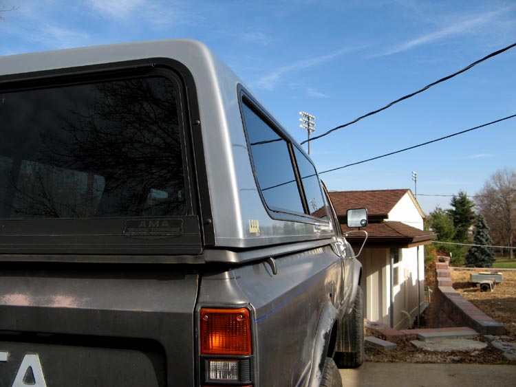

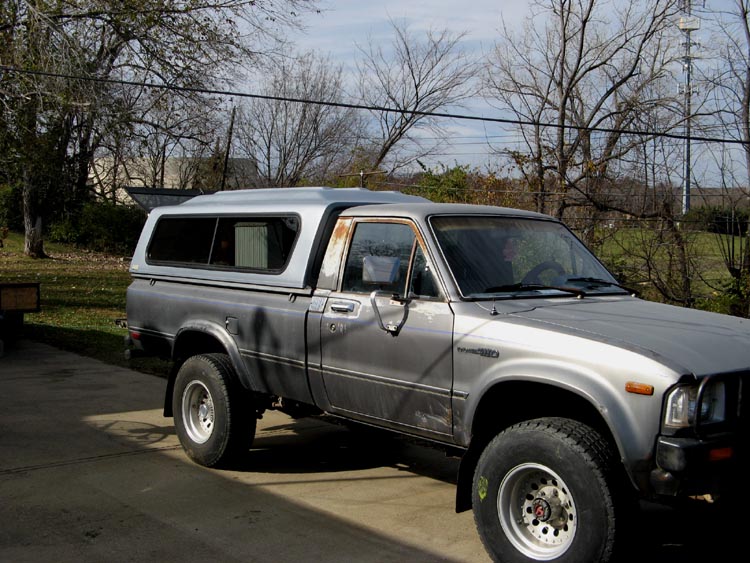

I've been planning to put a topper on the '83, but so hard to find a good topper that fits. I found one for a 7 foot bed (from a Chevy C10), and was determined to figure out a way to seal the 2 inch gap!

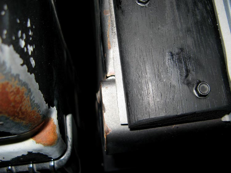

I was going to use galvanized steel, but then realized I had some molding in the basement that would just fill the gap. I painted it flat black 'cause I could not find a charcoal grey. Not bad.
It has foam sealing pad/tape all around, and also between the molding and the front of the topper.
Here's what it look's like:
It is about an inch too wide, so there is a 1/2" overhang on each side. Not bad (more room inside, in fact!). Nice dark tinted glass. Looks good!

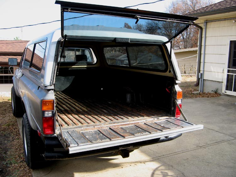

I wired a high brake light in, with a quick disconnect on the right side. I also wired in fused 12volts line from the battery (also used for trailer wiring adapter-got lots done this weeked!).
All ready for me and the kids sleeping bag!

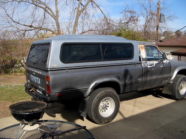

Another view. Slightly too wide, and a couple of inches too short, but it can be done.

But the front on my bed is welded at the top shorter than the full bed length...
Not by much, but the top is also folded inwards with a 1.25" flat top. The back is also tapered inward at the top of the bed. It's slightly over 8'2" inside the top, and nearly 8'4" at the bottom! My measurements were OK, but my explanation sucked! I was concentrating on the dimensions where the topper meets the bed. It is bigger inside the bed!
