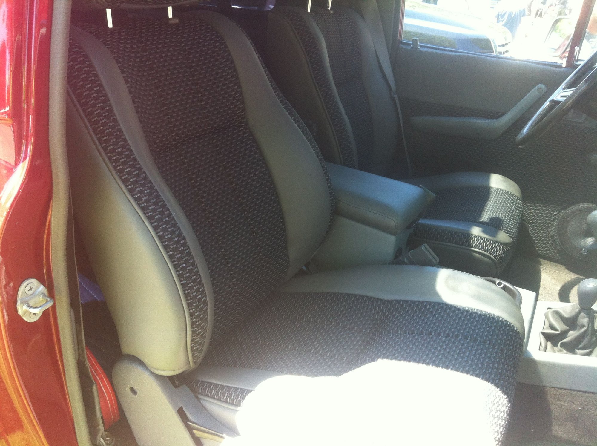

not a bolt in for sure , and they are a little wider , but you can make them fit , I put them in my Trekker , but I also built a complete new floor

Ok. Thanks for the response! They look great. I have a 99 and a cylinder head cracked and tbh, I didn't feel like investing that money into it. So I'll strip it for parts I can possibly use for my 82. And I thought abt the seats but I wasn't sure if they'll fit.
So you had to rebuild the floor? wow. I mean, that would make sense. Again, thanks.
