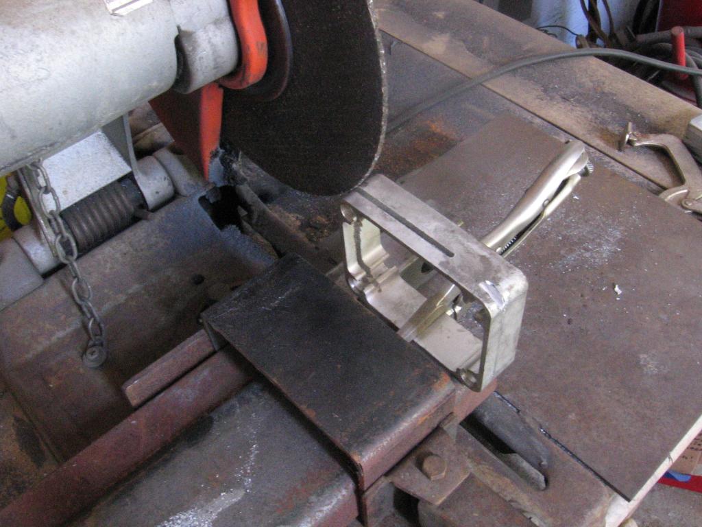

There are four brake boosters in question: small/single-diaphragm (what a stock first-gen has), large/single (common on 3rd gen 2wd), large/dual (common on later 4wd), and small/dual. The latter is the only one that's an upgrade. To get it to clear the steering shaft, you need to bend a little sheetmetal and cut the booster spacer in half.
The small/dual is NOT exclusive to turbo trucks. Mine came from some 3rd-gen 2wd in a junkyard.

What is the best way to identify a small/dual booster?
Do you have pictures of the booster spacer before and after it was cut in half?

Pictures of the booster models and mod would be awesome before I tear it out!

I feel I've chimed in on this issue in several threads, and when I get all the pictures assembled in one place I'm going to make a comprehensive First-Gen Brake Upgrade thread so we can end the confusion.
The stock setup has an aluminium spacer between the booster and the firewall. This is to clear the upper steering column U-joint. The boltpattern of later boosters is the same, but the studs are shorter. There are few ways around the problem; my solution was this:
This leaves just enough thread on the studs inside the firewall to put nuts on. I don't have exact dimensions; recommend cutting it about 2/3 and grinding down further in a guess-n-check fashion.
As for how to identify the boosters, stay tuned.
