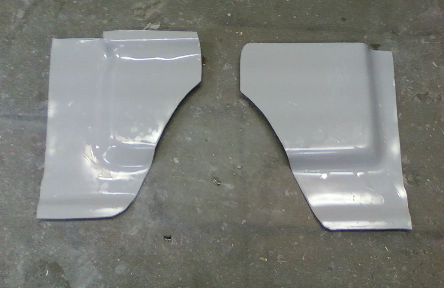

factory ones are a pretty simple piece , there just flat , and easily cut out from material with scissors .
We build custom ones from FRP , for people doing engine swaps and such to hide computers and fuse boxes , ect .....

Well the local over 55/seniors centre had a class on 3D printing that I went to. You can reproduce anything if you have the time, skill and mostly patience to do it. I made a radio knob (not automotive) which after painting is indistinguishable from the others. Some of the other guys there were making parts for model airplanes/cars/trains which were detailed right down to tiny nuts and bolts.
As far as those kick panels I did the same as Slacker, just cut them out of hair cell ABS sheet and heat and bend where needed.
What thickness ABS did you use?

1/16", bought a 4' x 8' sheet for $40CDN at a plastic distributor. Get the black ABS, apparently its more UV resistant so the guy there said.
