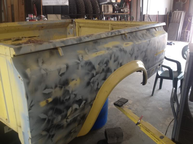

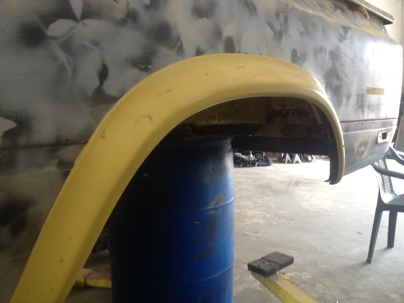

Yes it can be done. The bed on my '81 4wd was in pretty rough shape, but I scored a really nice '79 2wd bed for $150 on Craigslist. Like Paul said, it takes some trimming to open up the wheelwells, but it's not that hard (did mine with an air shear).
I took a thick piece of cardboard and made a template from my 4wd bed and transferred it to the 2wd bed to do my trimming. Then I drilled my fender flares holes and it was done. Also you will have to transfer the gap guard brackets and the mud flap brackets from the 4wd bed to the 2wd bed (if you decide to re-install either of those).
My '81 tailgate was in better shape than the '79, so it was a direct swap.

Here's a couple pics after I put it back on the truck (minus the fender flares)...I had it sandblasted and primered too. All the body lines match up and to the untrained eye, no one will be able to tell the difference.
