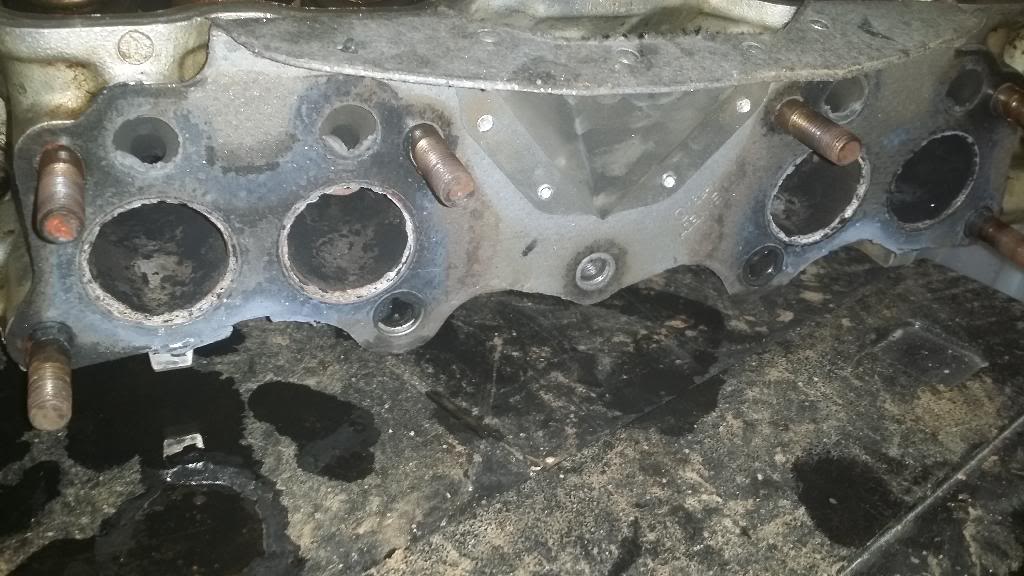

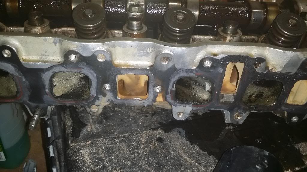

Intake side Head:

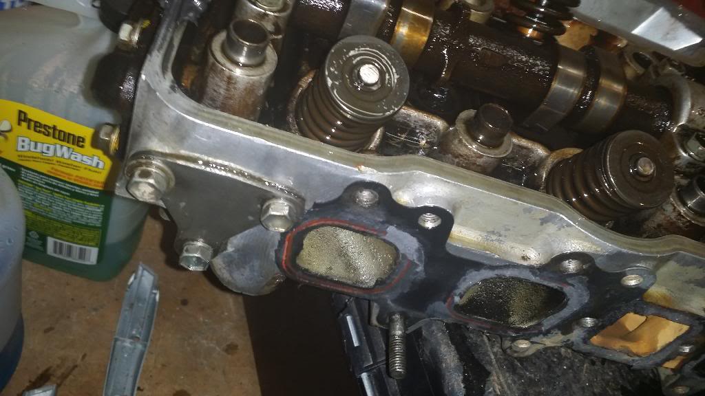

Exhaust side head:

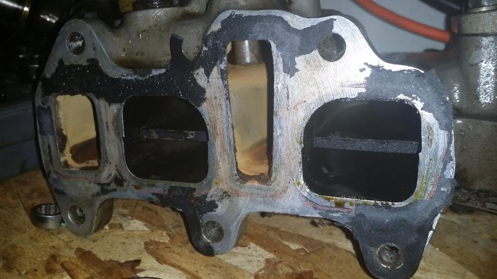

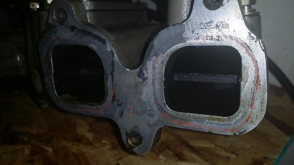

Offenhauser duel port intake manifold:

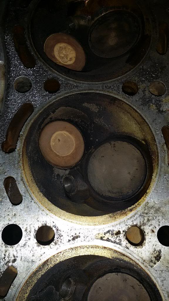

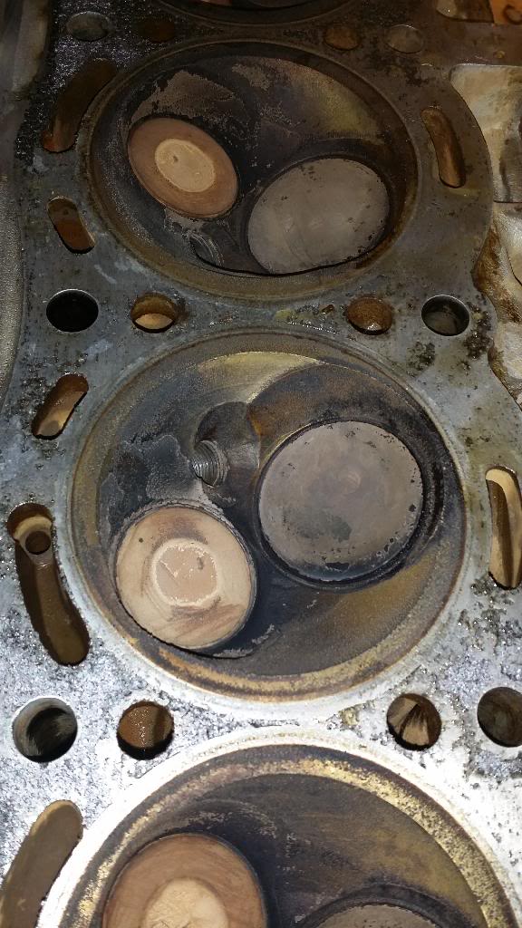

Valves:

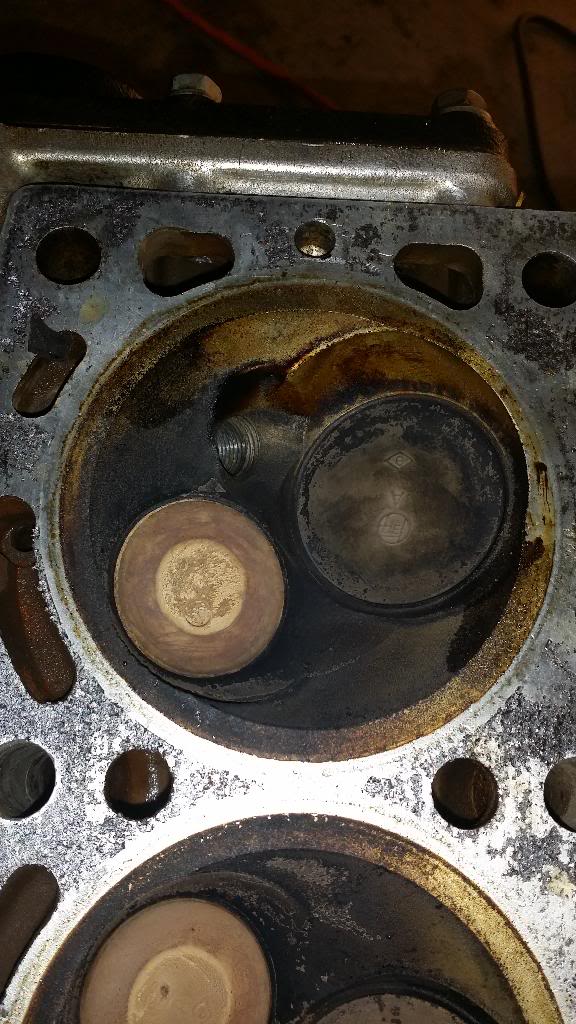

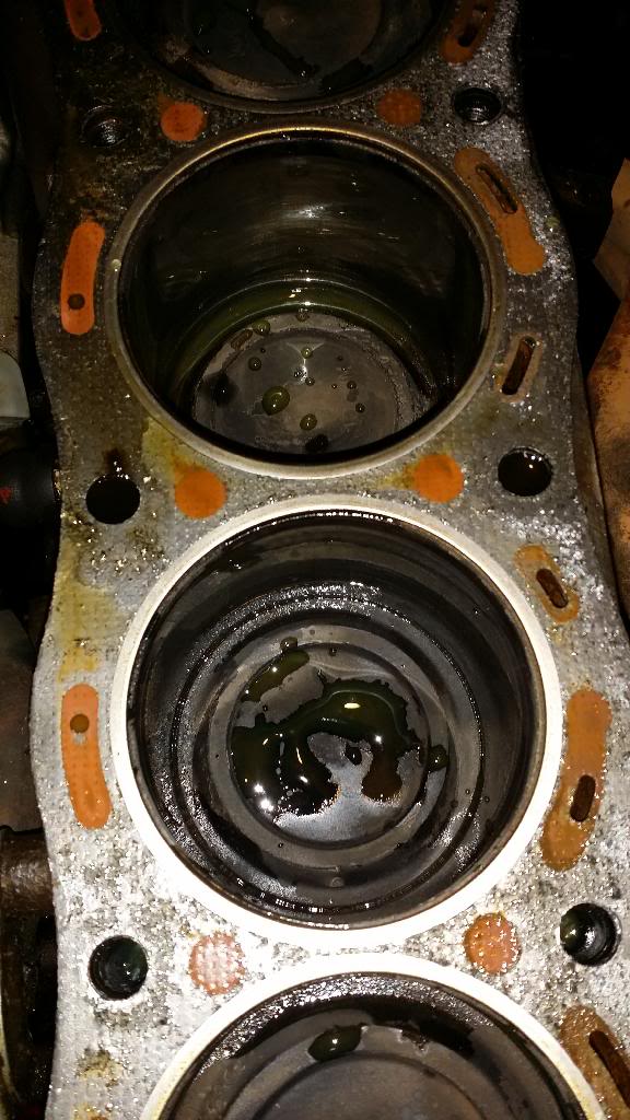

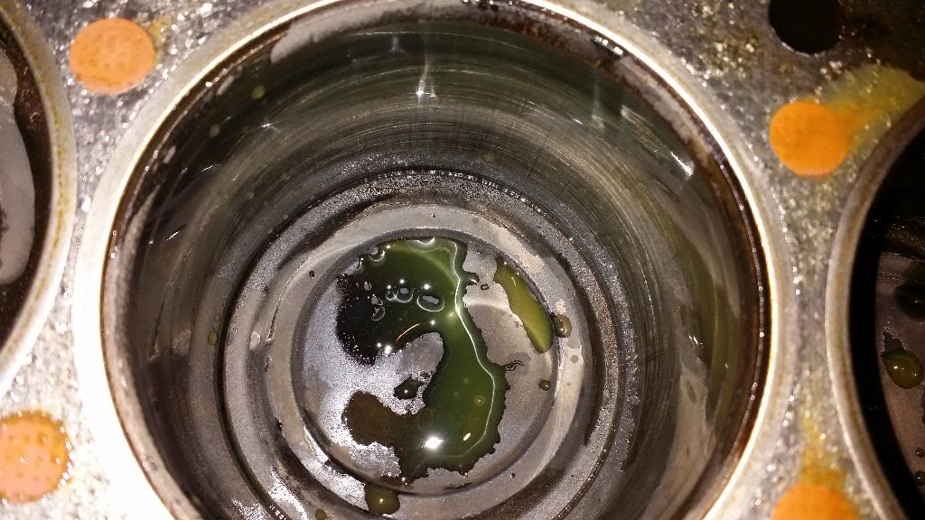

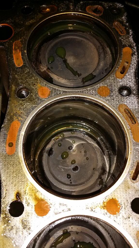

Pics of the cylinders and piston tops and head gasket:
Size:  105.7 KBName:  20140113_185959.jpg

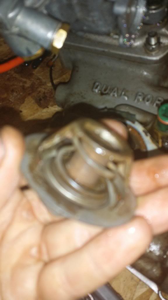

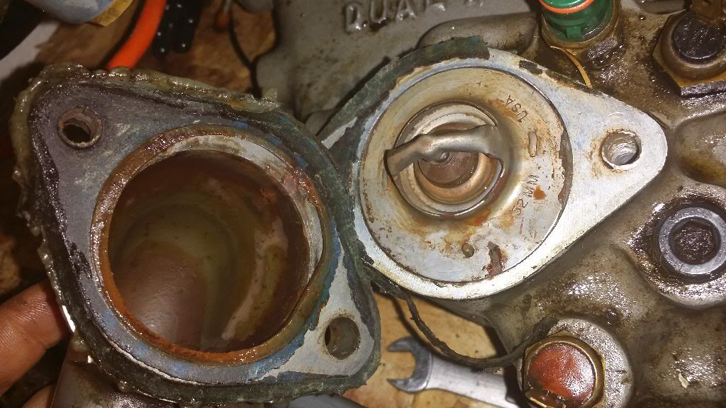

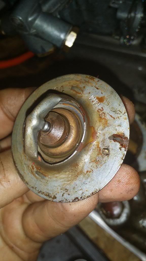

Thermostat:

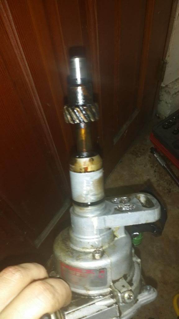

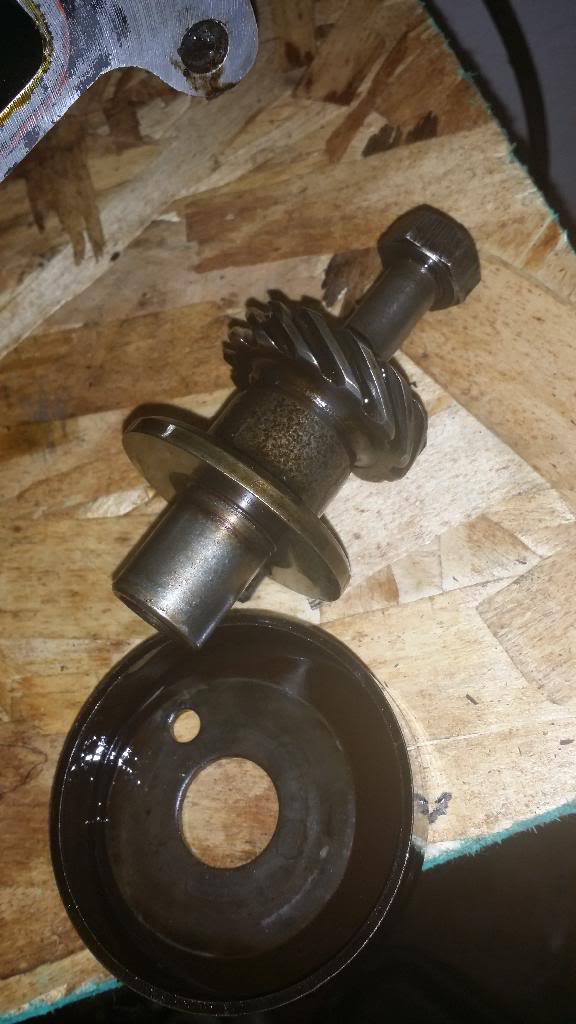

Distributor:

Offy intake...NICE!
First let me start by claiming my experience. I have rebuilt dozens of Kawasaki and Suzuki (4 cylinder) engines for racing applications, a hand full of Ford and Chevy engines and couple 22R engines.
*From looking at your pictures, your exhaust valves are slightly burnt (particularly on what appears to be the #2 cylinder). Those are Toyota valves so the engine was either rebuilt with Toyota valves or not "fully" rebuilt at all. Judging by the condition of the pistons, I am 99% sure that they are the original valves. I can also tell that those are not the original pistons because they do not have the notch that points to the front of the engine (Most replacement pistons have that notch too). You can see the notch that I'm talking about in this picture:

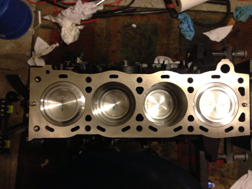

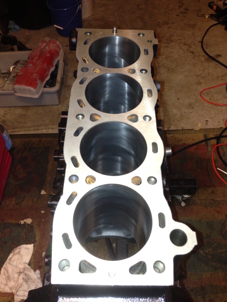

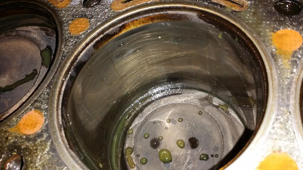

*Those cylinder walls do not look good at all. I can clearly tell that they were honed, but they were not honed properly. No offense to you, but honing is something that a professional needs to do to be done properly or you'll end up out of round cylinders and poor hatching. You should have a nice cross hatch at about 45* up and down the cylinders, but you can see where your's are not hatched at all and they just run perpendicular to the bore. A poor honing job will cause the rings not to seat well. Also, if you hone a cylinder too much it will not properly "fit" the pistons and rings and cause compression issues. You also have some pretty significant vertical scoring which could have been caused by a debris during installation or possibly a bad ring gap job. The hone should look something like this, even after it has been ran:
*I also noticed that the distributor appears to be original and has a well "burnt" rotor. You're at least going to want to replace the rotor and cap, if not the whole distributor.
My suggestion, get that block to a machine shop so that they can mic it. See if it is within the FSM specs (do you have an FSM? If not, let me know and I can point you in the right direction). If in needs to be bored, ask the machine shop what size pistons you need and order the pistons BEFORE they bore it out. Take the pistons to the machinist and they will match the bores to the pistons. While you have it apart, you might as well have the head rebuilt too. Doing it right won't be cheap, but it beats having to do it twice.
I'm not intending to offend you, just pointing out the things that I see so that you can learn from it. Let me know if you need any help with a rebuild.

No offense taken, your reply was exactly what I was looking for. I really appreciate the analysis and sharing. I also thought the hatches on the cylinder wall looked too horizontal and there are notches on the piston tops. I do remember facing them forward when I put them back in. I do have an original hard copy FSM specific for my year, a Chiltons and a Haynes, they all came with the truck. Oh the pistons are 1.00 mm oversized. If I am right that is 60 over on the bore and I beleive that's about max that you would want to bore this block. Again thanks a lot. I am going to get the head into a shop today and further disassemble the motor. I'll get more pics up later this evening.

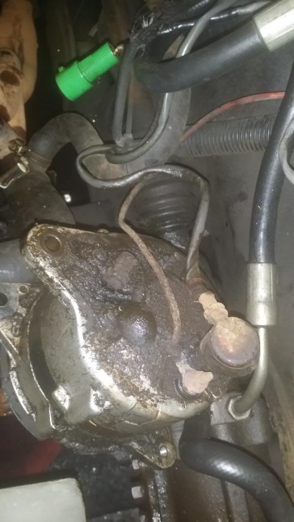

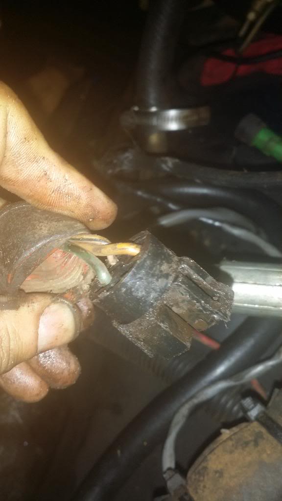

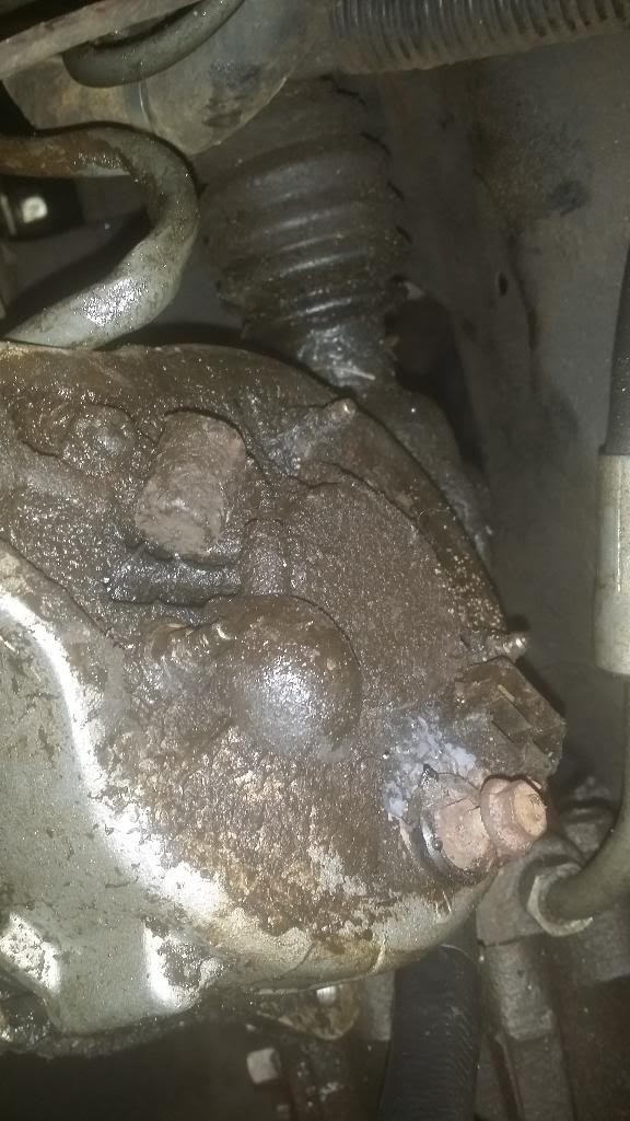

Took the head in to the machine shop they are going to clean, check warpage and do a leak down test on it and give me a call. Started more tear down. Glad I decided to do this. The ground wire to the alternator was hanging by only a couple wires and crumbled apart in my hand.

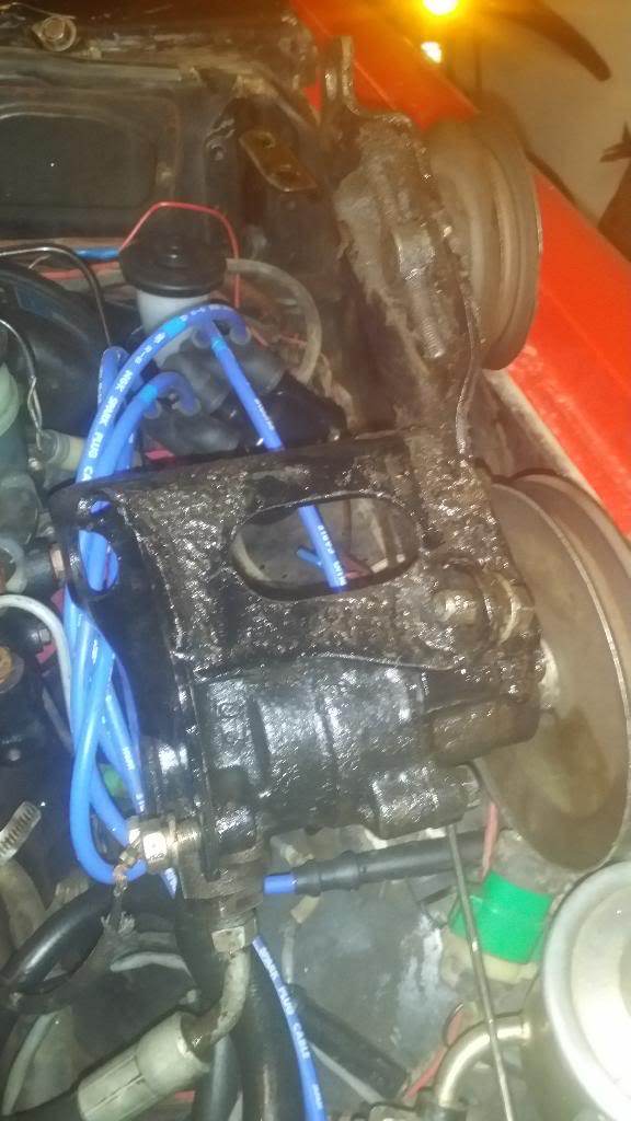

Radiator and shroud:
Powersterring pump:
Alternator:
3 wire green plug for alternator:
Broken alternator ground wire:

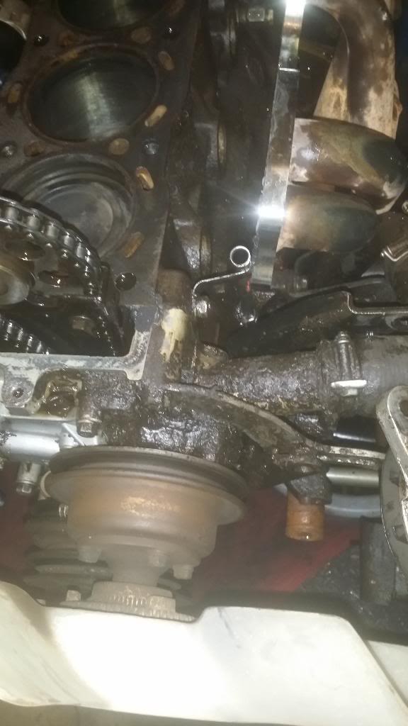

Took a long lunch and got back to tear down. Good news is the pistons and rings look good, and the con rod bearings look good to me to. As-well as the crank.
Pictures are uploading, will get them on this thread when they are done.
Lunch:
Water pump:
Crank pulley:

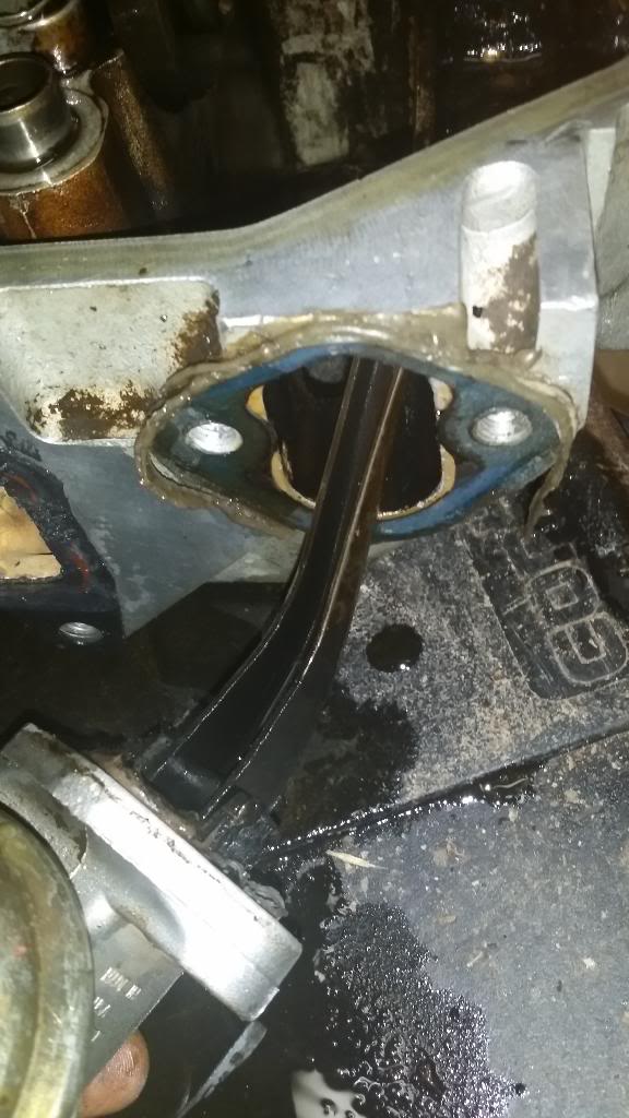

Oil pump/timing cover:
Oil Pan and pickup:
Piston and con rod bearings:

Just so you know, 1mm is .040 over. I also think that you would be making a mistake by re-installing the old pistons and rings; mostly the rings. If those rings didn't seat properly the first time, they are mostlikely never going to seat. Spend the money and buy some new ones. You could actually get a full ebuild kit from Engnbldr for around $350 which would get you all new pistons, rings, bearings, wrist pins, every gasket under the hood and even a new oil and water pump. You have it apart, might as well do it right or you'll surely regret it later when you have to tear it down again.
Old Jan 15, 2014 | 07:44 AM
catfish21's Avatar
Joined: Feb 2013
Posts: 447
From: baton rouge,louisiana
Please listen to him and get your block re honed and bored it will save you a lot of time and money in the long run
Old Jan 15, 2014 | 10:51 AM
jahstrength's Avatar
Joined: Dec 2013
Posts: 36
Block only has 10k on it from a professional rebore. It was checked last time and was fine. The rings are new and sealed fine. The problem was not the rings, but the head. Since its like 30 mins more to take the pistons out I decided to do that for my own curiosity of what 500 miles on the job looks like. Also my oil pump cover was leaking and I wanted to fix that so I had to drop the oil pan
Old Jan 15, 2014 | 11:41 AM
kawazx636's Avatar
iTrader: (3)
Joined: Jan 2012
Posts: 3,218
Likes: 26
From: Salisbury, MD
Originally Posted by jahstrength
After getting the pistons out I decided to re-ring them, hone the walls lightly, new con rod bearings and slap it back together.
But that is certainly not a professional hone job. I wouldn't even call it a professional rebuild if it is leaking oil from every orifice of the engine after 15,00 miles, burnt valves and a bunch of reused original parts - even if it did sit for 10 years. Nonetheless, it should be honed again to get a proper hatch and to get rid of that glazing. Even if your rings did seat, they were seated to the poor hone and would definitely need to be replaced if re-honed.
Hey it's your truck and you can choose to do what you wish, but you'll hear an "I told you so" when you're back here in 2,000 miles or so with low compression and an astronomical amount of blowby and oil consumption.
Old Jan 15, 2014 | 11:56 AM
catfish21's Avatar
Joined: Feb 2013
Posts: 447
Kawaz sums it up perfect your cylinders are in bad shape you can see the black stuff witch in terms is glazing and there is a lot of it and the scares on your wall need attention, we here on yotatech will help you as much as possible and we're not bashing you at all its your truck and you do what you want to it. But if it's something that your gonna keep and make long trips like your talking about you need to have those cylinders at least re honed and plus your down that far why not spend a little extra to give yourself peace of mind, cause I'm telling you now you will bolt it up and yeah you mite get a lot of miles out of it but you will regret it down the road when you could have gotten 200 plus thousand out of it. But I wish you the best of luck whatever route you take and just ask questions if you need somethi there's a lot of knowledge on here
